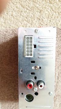

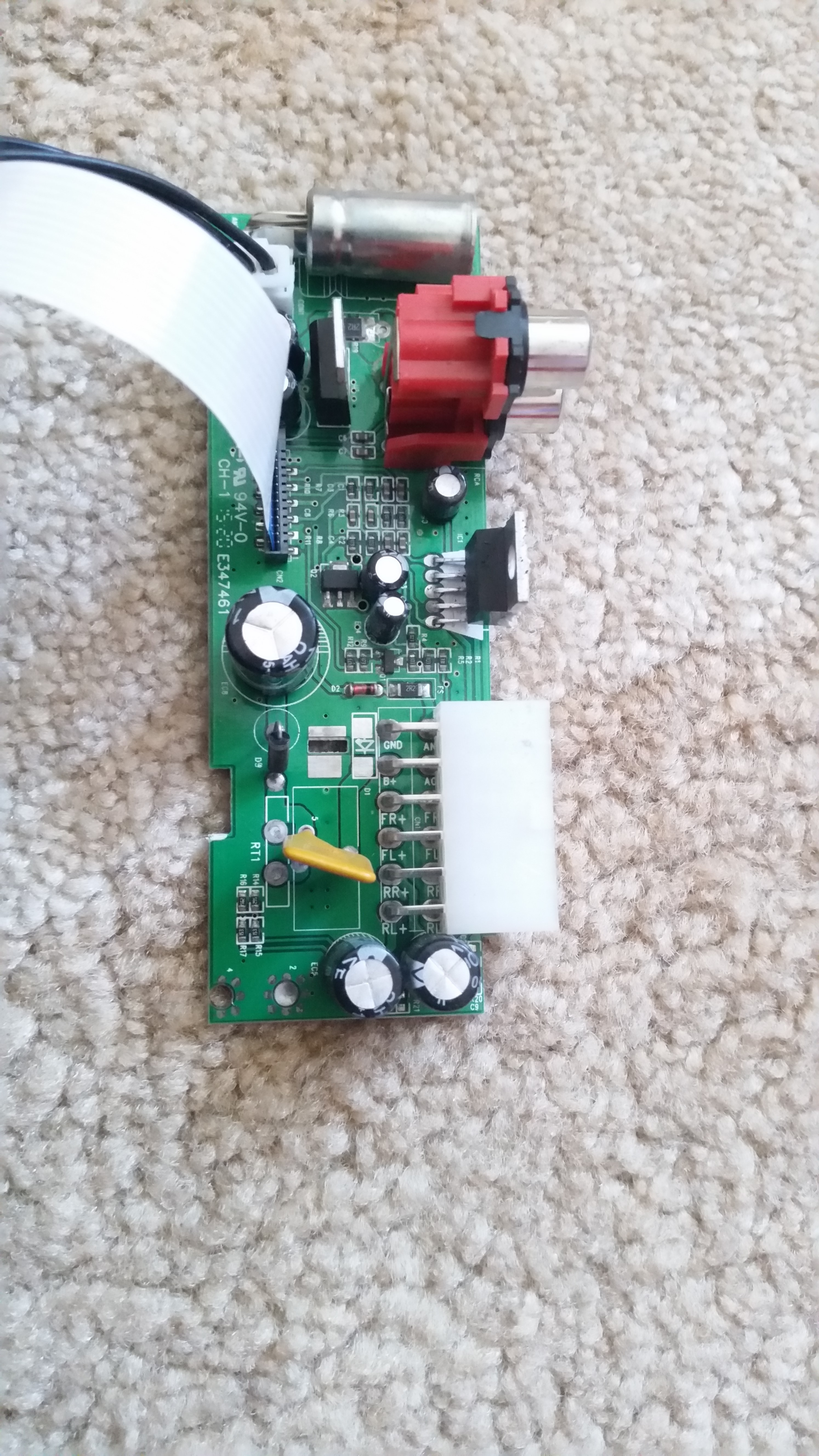

    Well, I have such a problem, because I took out the old radio and I can not mount a new radio to Matiz, 1998, because it just has a different connector than the old one.
    I've looked a lot in this topic, read about these connectors, adapters, ISO cubes, etc., but I'm not sure what to do with it. Also studio24.prv.pl does not help me much in practice. All because I don't know anything about it.
    So I'll start by sending photos and showing you all this.
    picture 3-old radio
    picture 4 and 5 new radio

    Instead of this cube from the old radio, you need to connect the new one. She should be on the radio. The previous installer cut the factory cube and replaced it with electric cubes.

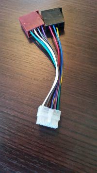

    I understand that this is supposed to be such a cube, right?

    If this white one is dedicated to this radio, then either you will cut the black plugs and solder / connect the wires with those from the car, or buy ISO cubes (some photo) and connect them with the car's bundle and then break everything.

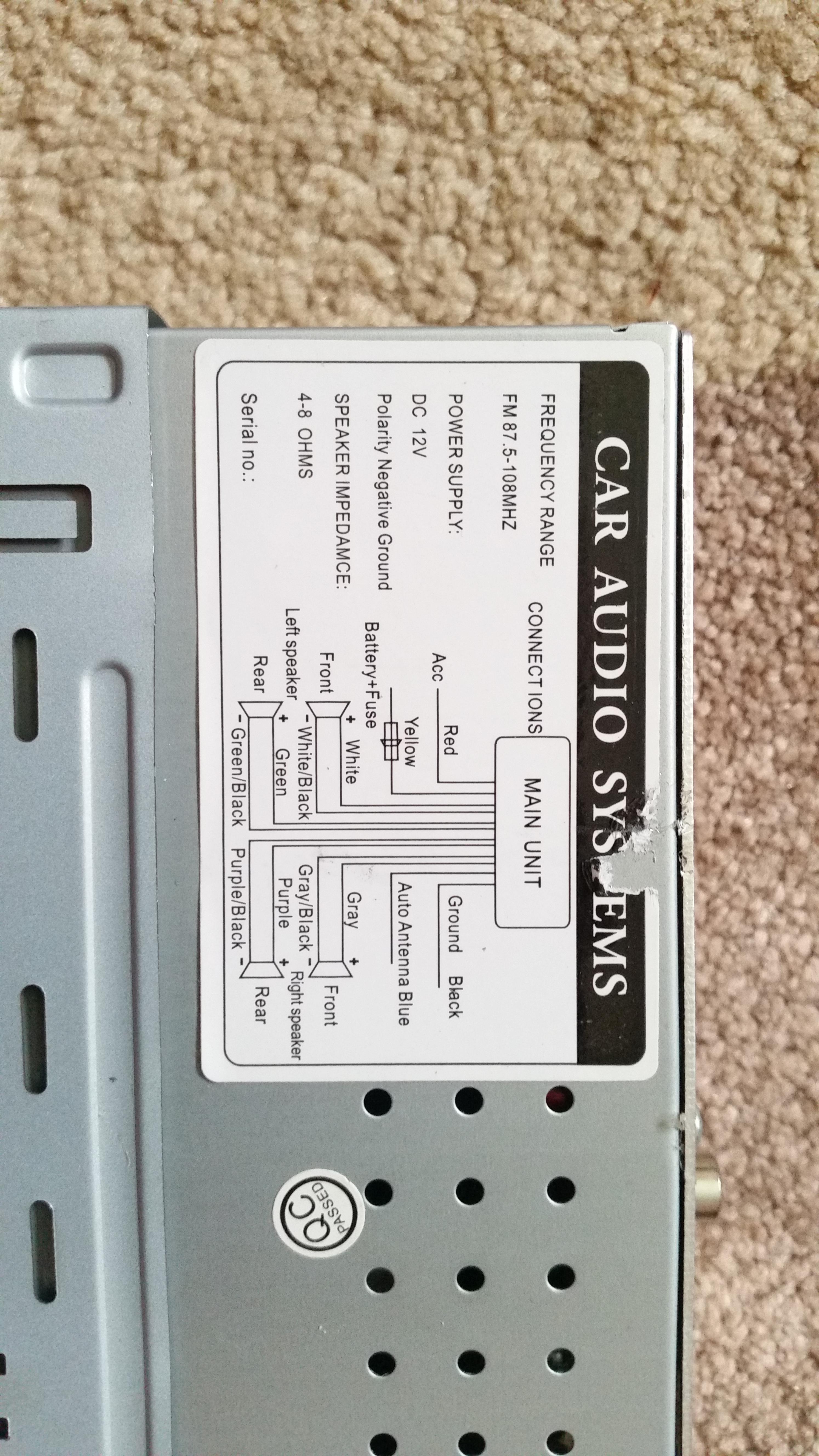

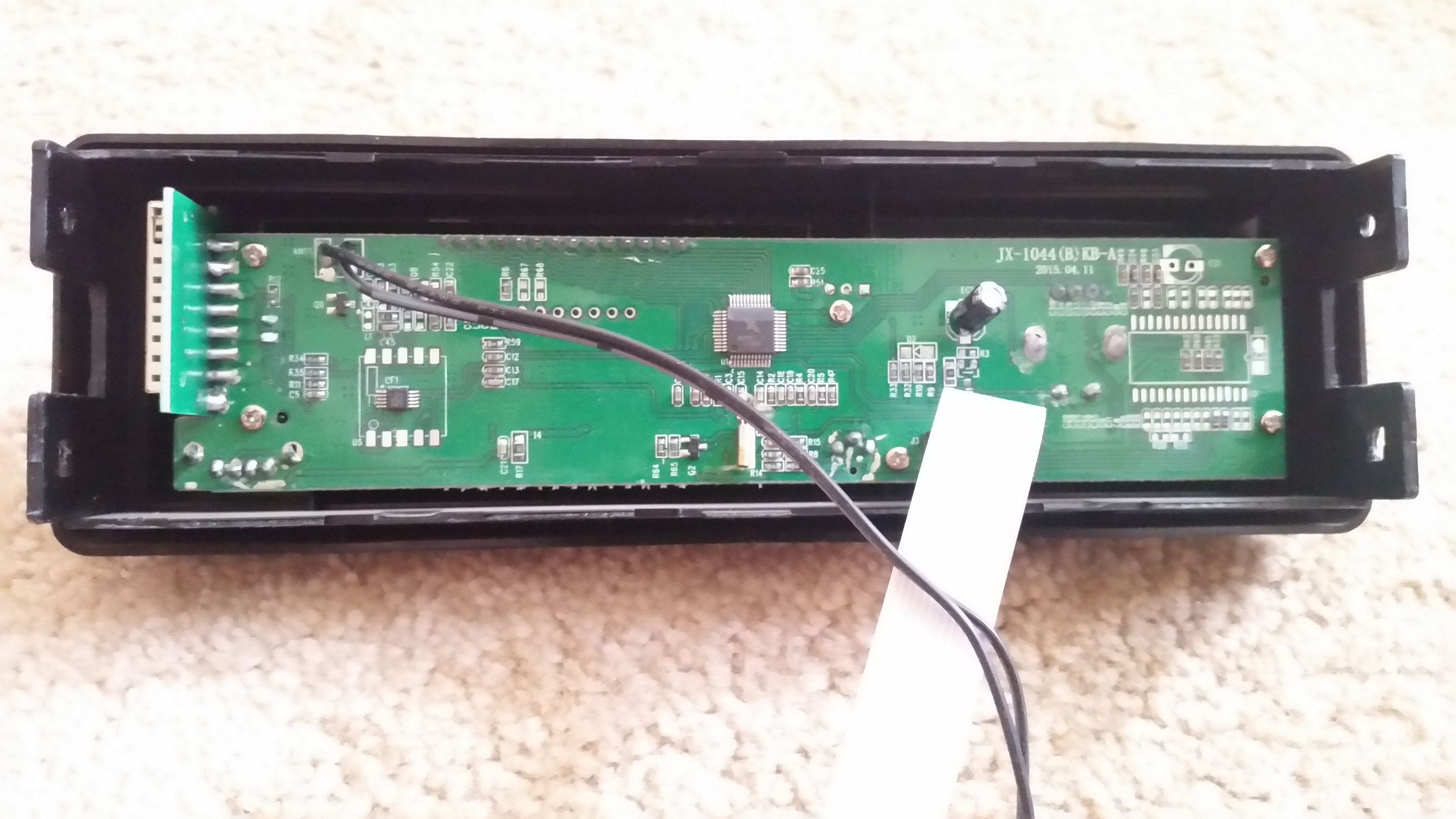

    There may be different signals at other places. E.g. mass instead of a loudspeaker, etc. It is easy to damage the equipment. The second thing is a different shape can have individual sockets. Write what kind of radio this is, maybe someone will know something. You can also look for the print / markings on the board in the middle, at the soldering points.

    I will add a few more photos from inside and outside.

    If you can attach a white cube, you can buy it. Then you need to describe the wires according to the pins marked on the board. You can see the markings in the first picture.

    I already have this cube, it can be easily connected to the radio,
    On each cable its inscription with its purpose, or so I think
    Green: LR +
    Green-Black: LR-
    Purple: RR +
    Purple-Black: RR-
    Blue: Power Antenna
    Yellow: 12V Battery / Constant (12V +)
    Black: Chassis Ground (12V-)
    Red: 12V Ignition / Switched (12V +)
    Gray: RF +
    Gray-Black: RF-
    White: LF +
    White-Black: LF-
    I don't know if it will be of any use, but I decided that I could rewrite it here
    That's all about the ankle

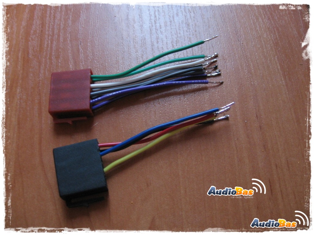

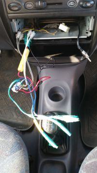

    Now the question is how do I know which cable in the car is from what and whether the end marked in red in the picture is also "from the radio"?

    Factory cables are described here. You need to connect the appropriate signals. Weight to weight, plus to plus, etc. The marked plug is not from the radio.

    New cube - car
    Red - yellow
    Yellow. - Orange.
    Blue - insulate.
    Black. -. Black.
    Speaker cube, colors and shortcuts.
    Brown-green --- + FL
    Gray. - FL
    Green-gray. + FR
    Green and black. FR
    Brown. + RL
    Yellow. -RI
    Blue. + RR
    Blue-gray - RR
