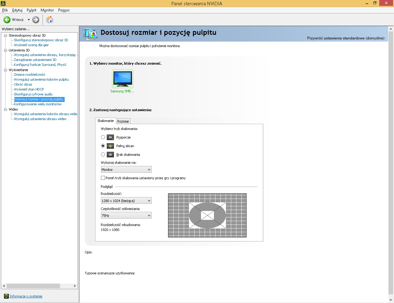

    Multi-core switched on and energy saving is switched off. I have a high priority assigned to csa. Sync disabled, all graphics settings are in the picture in the post, just look
    Added after 19 [minutes]:
    CS GO FPS Drop: Solutions for Long Load Times & Decreased FPS after Map Changes, Nvidia Settings CS GO FPS Drop: Solutions for Long Load Times & Decreased FPS after Map Changes, Nvidia Settings CS GO FPS Drop: Solutions for Long Load Times & Decreased FPS after Map Changes, Nvidia Settings CS GO FPS Drop: Solutions for Long Load Times & Decreased FPS after Map Changes, Nvidia Settings
    Here I turned off everything and made screenshots and in an hour I sent with csgo turned on
    Added after 1 [hours] 16 [minutes]:
    The problem seems to be solved. Everything is okay so far. I downloaded the csa to the second partition, system and it is really fine. Thank you for your time
