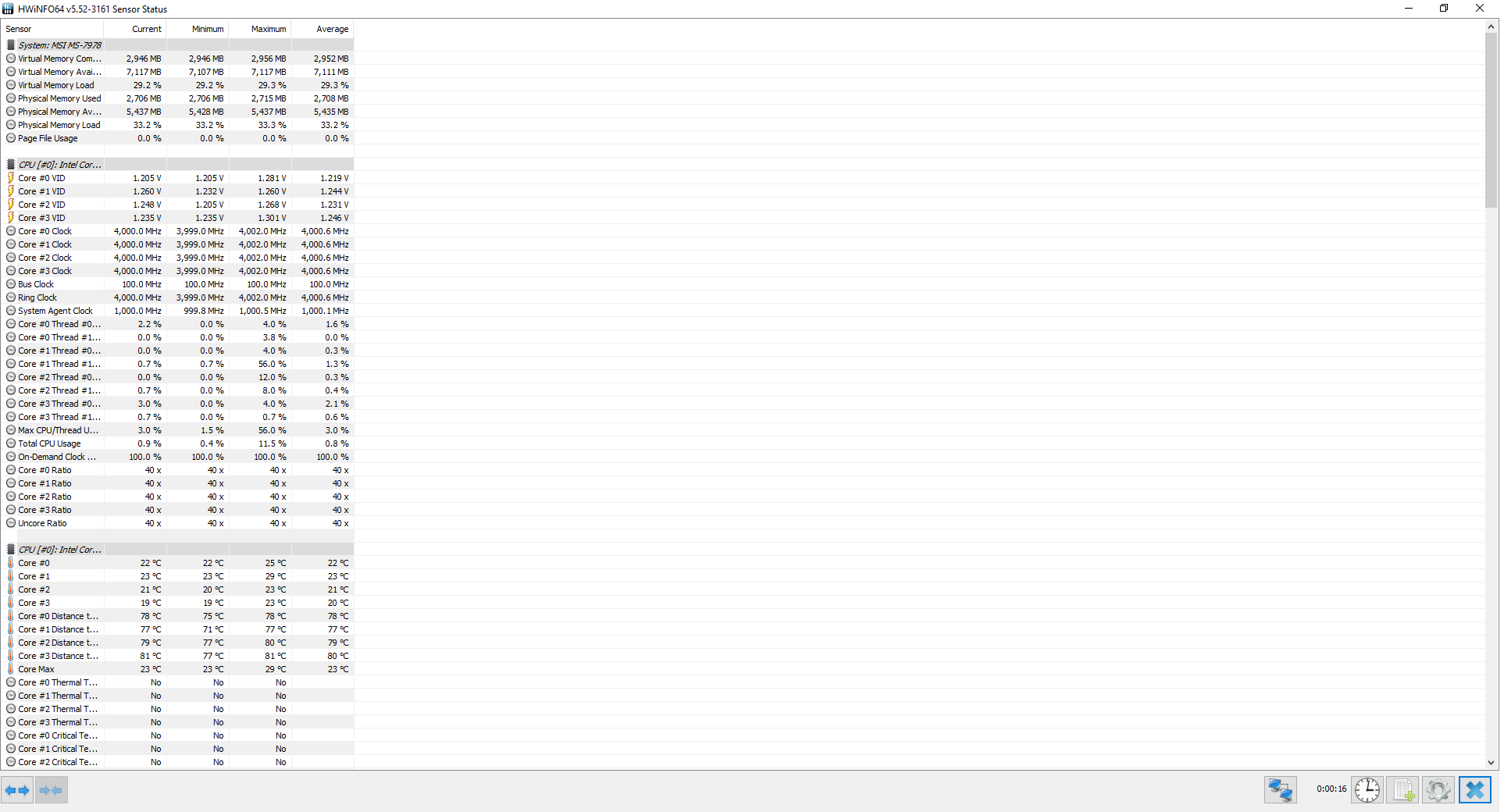

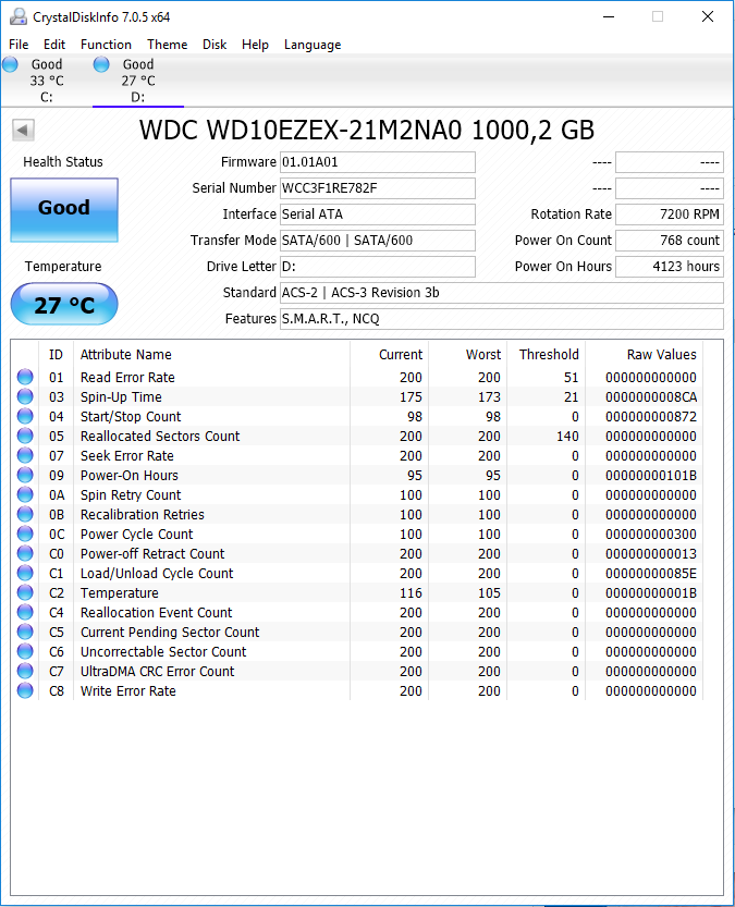

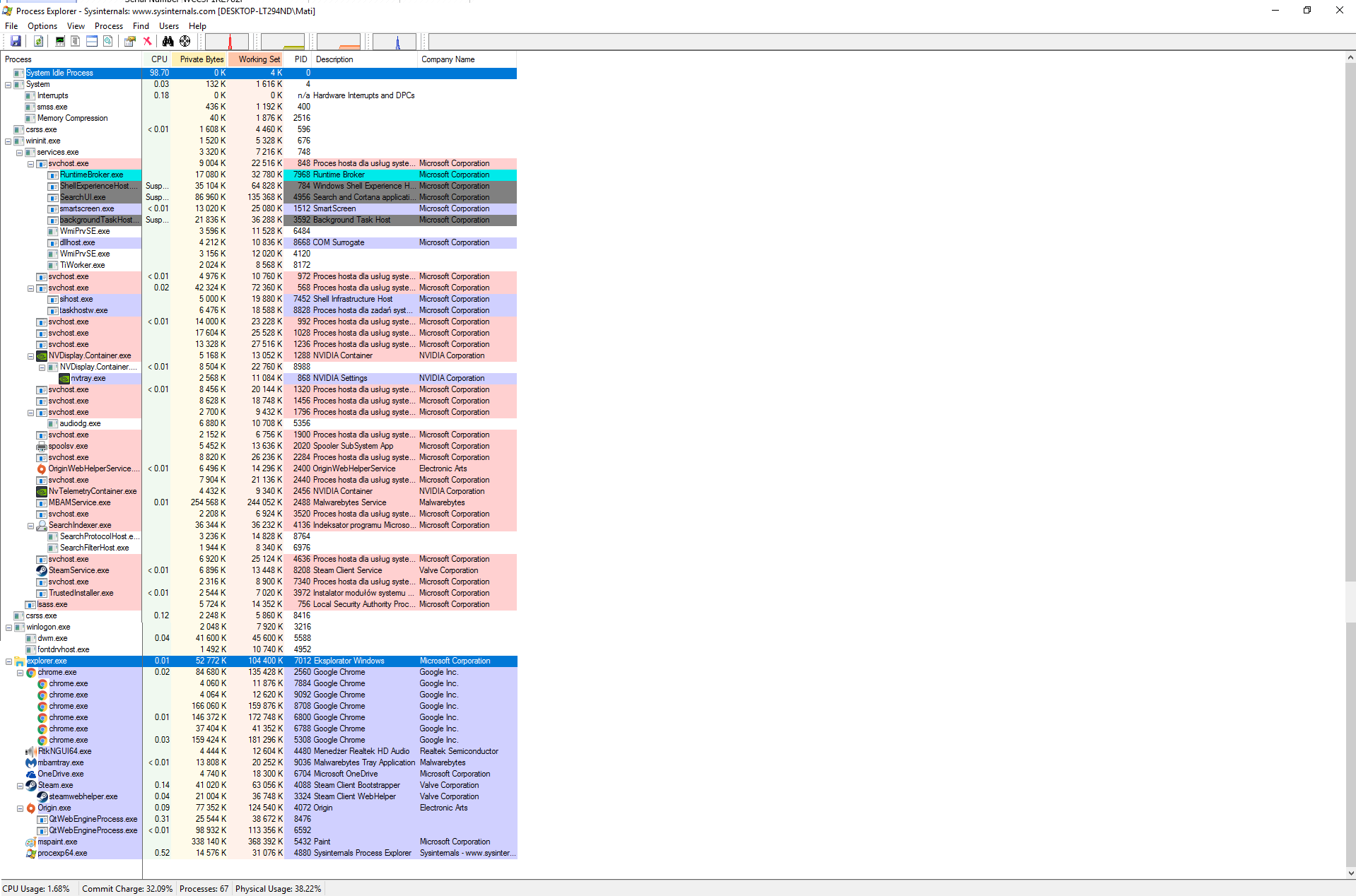

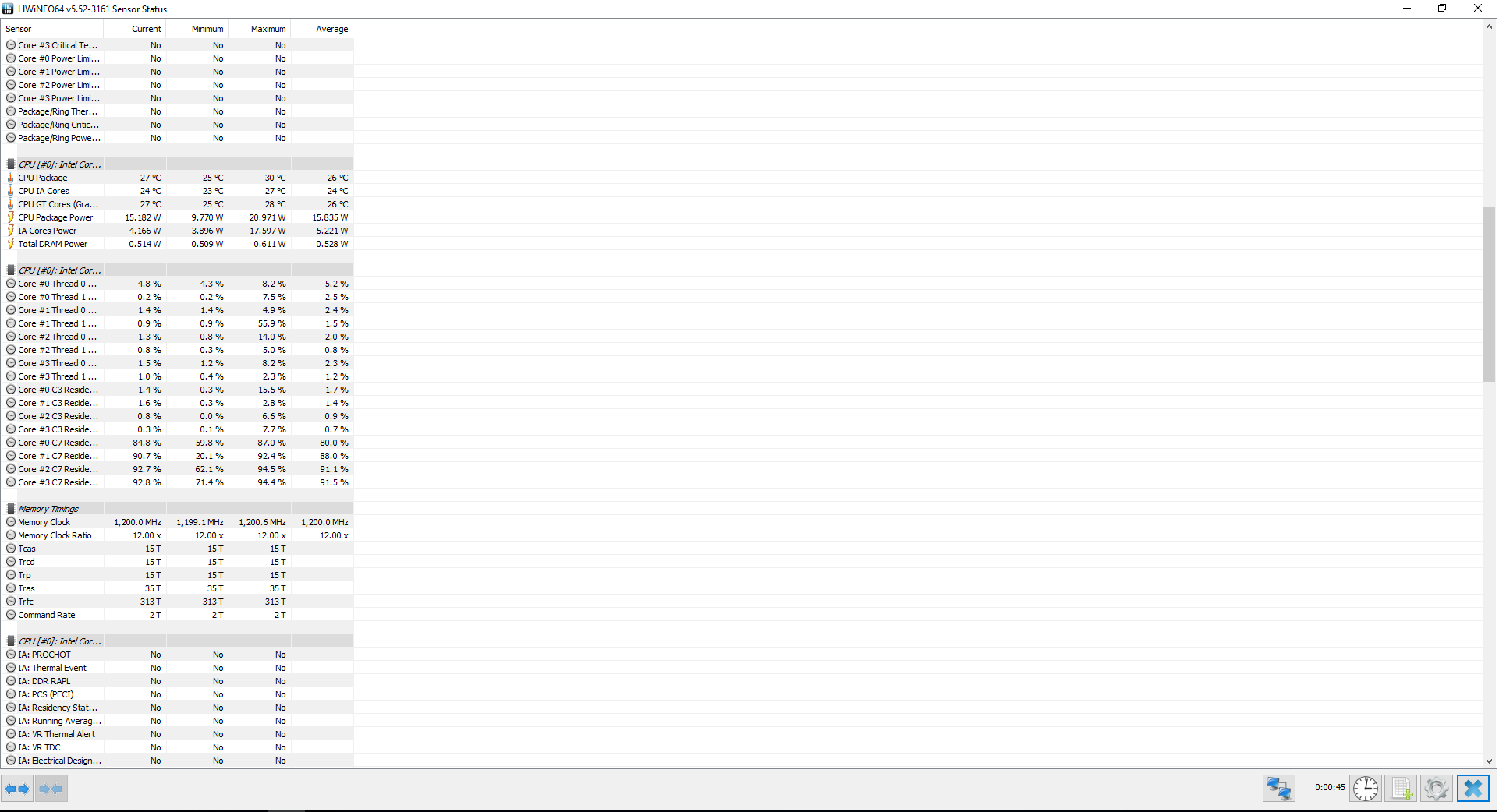

    raszyna12
    Everything is done, I attach screenshots + fixlog.txt
