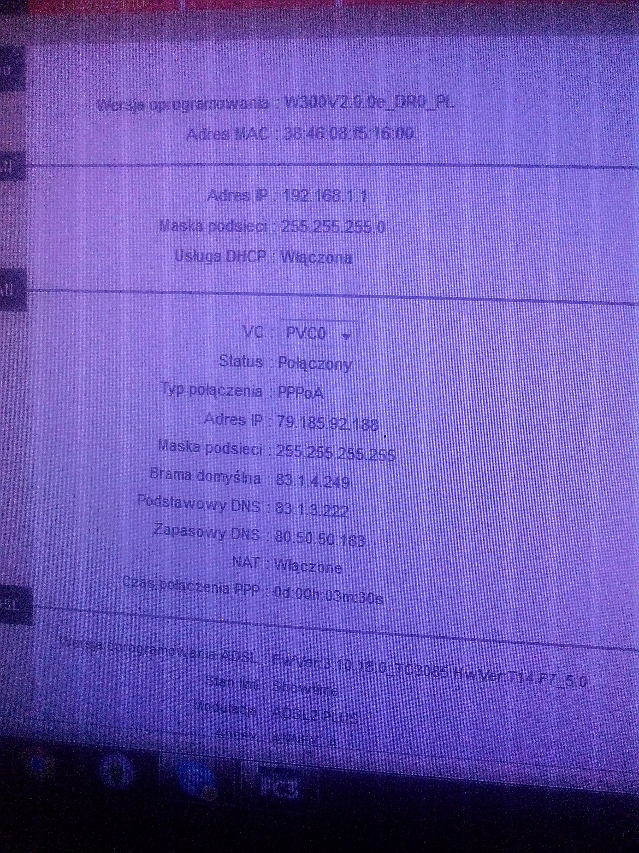

    This is what I have in the status tab
    • No internet access after power outage 1498998398140.jpg (2.29 MB) You must be logged in to download this attachment.

    The connection to the Internet is supposed to be - the router has some tools, e.g. ping. How do you connect your PC to the router?

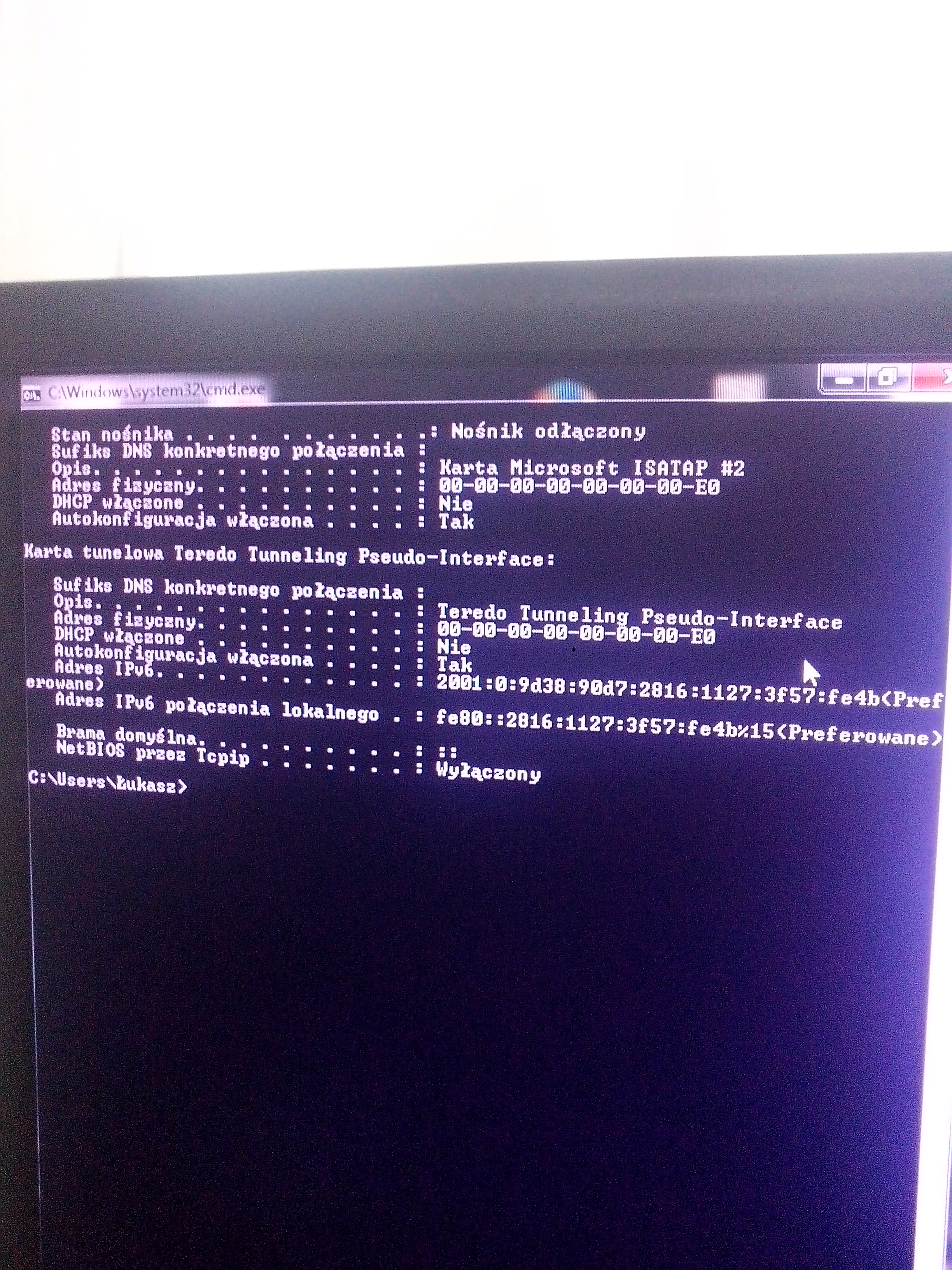

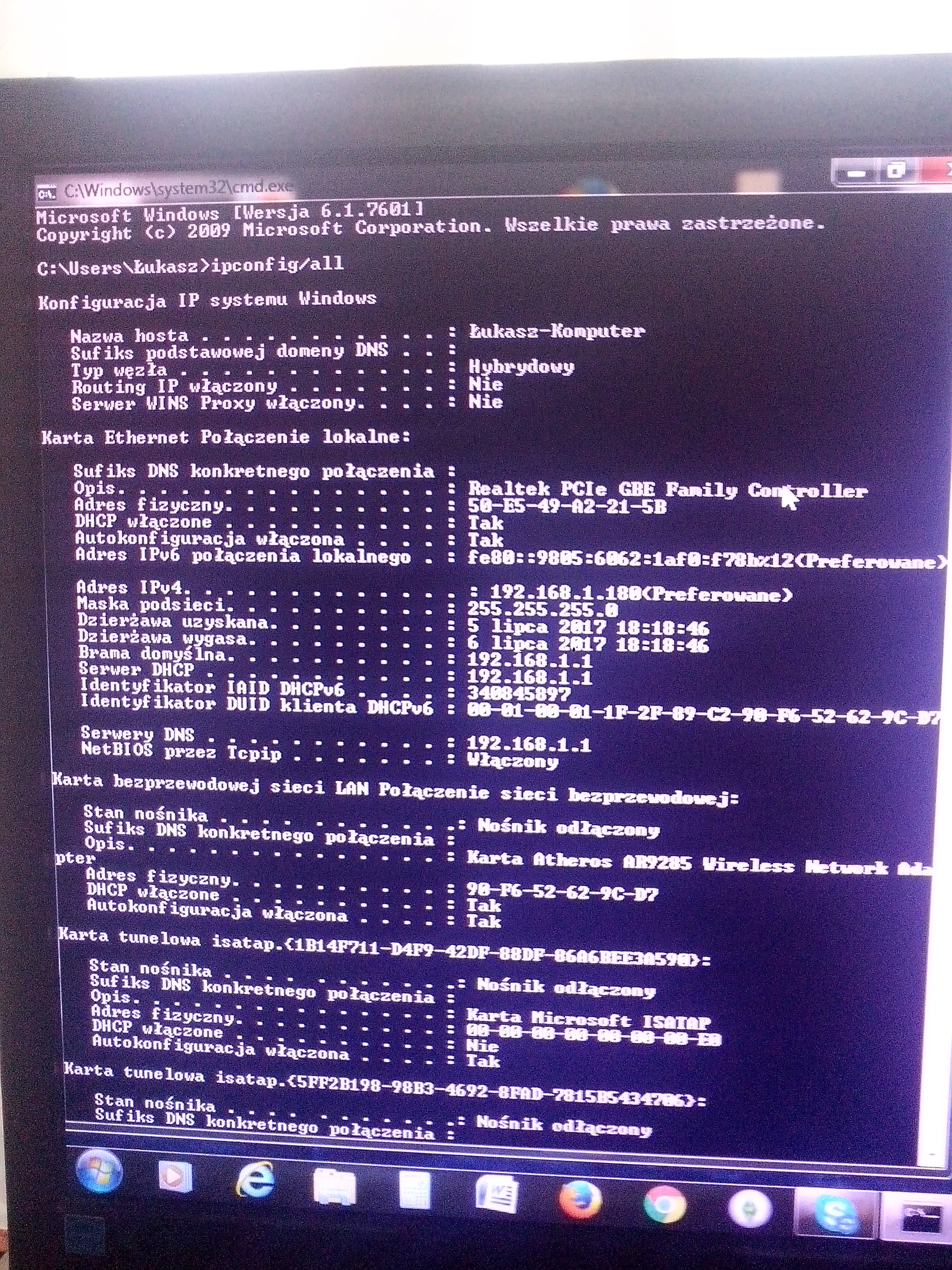

  • #14 16568888
    najglosniejszy
    Posts: 23
    Rate: 11
    Will you see if everything is ok?
    • No internet access after power outage 1499272099273.jpg (1.5 MB) You must be logged in to download this attachment.
    • No internet access after power outage 1499272008519.jpg (2.06 MB) You must be logged in to download this attachment.

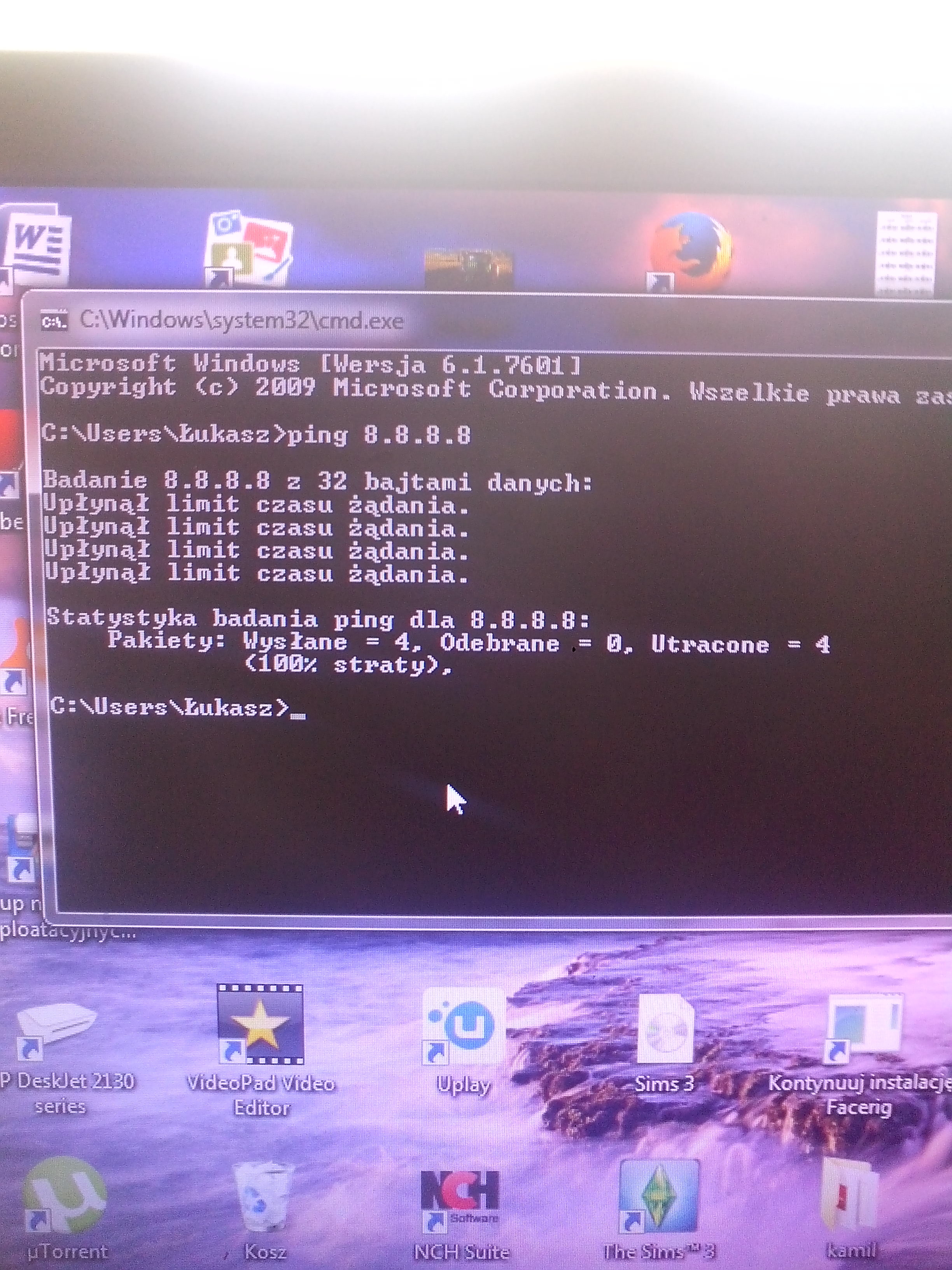

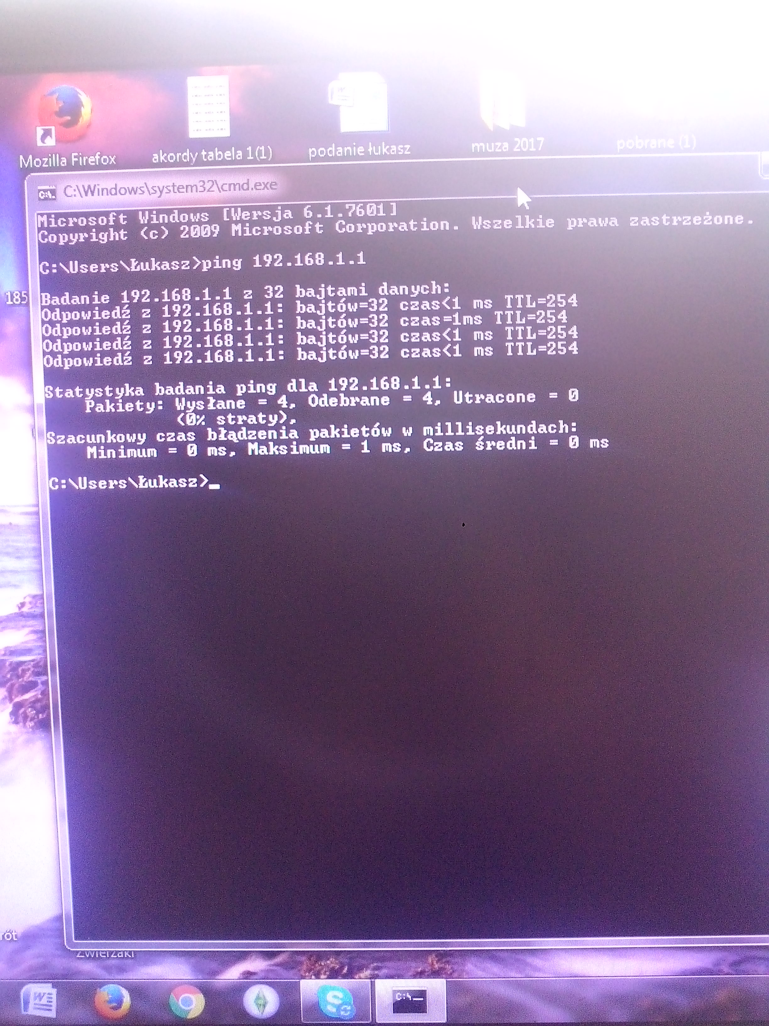

    Show more:
    ping 192.168.1.1
    ping 8.8.8.8
    nslookup onet.pl
  • #17 16573164

    najglosniejszy
    Posts: 23
    Rate: 11
    The effects of what you told me to type
    • No internet access after power outage IMG_20170709_121045.jpg (1.26 MB) You must be logged in to download this attachment.
    • No internet access after power outage IMG_20170709_121217.jpg (1.12 MB) You must be logged in to download this attachment.
    • No internet access after power outage IMG_20170709_121343.jpg (1.22 MB) You must be logged in to download this attachment.

  • #23 16577855
    hermes-80
    Posts: 12014
    Help: 1177
    Rate: 743
    DNS is responding - probably some blockage on the router (hangs) - restore the router to factory settings and reconfigure the PPPoE (WAN) LAN and WIFI connection.

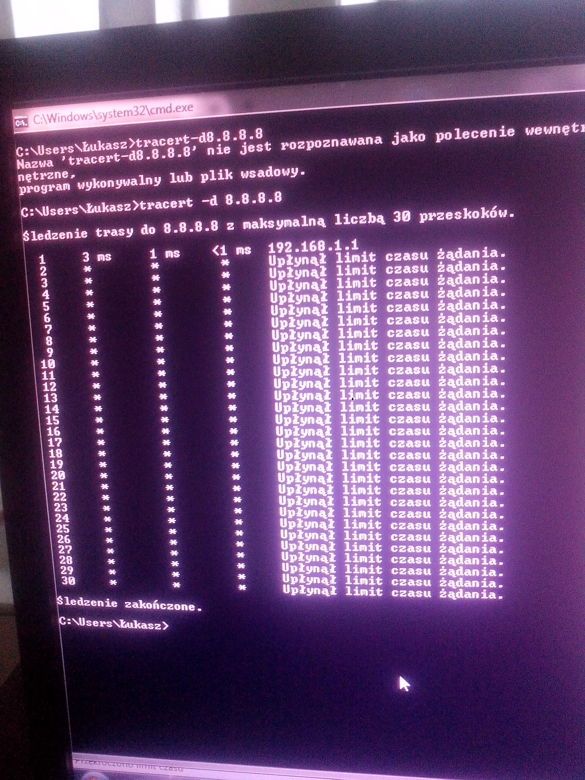

    What does "tracert -d 8.8.8.8" show?

    najglosniejszy
    Posts: 23
    Rate: 11
    I have something like that
    • No internet access after power outage 1500489767188.jpg (1.71 MB) You must be logged in to download this attachment.
