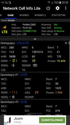

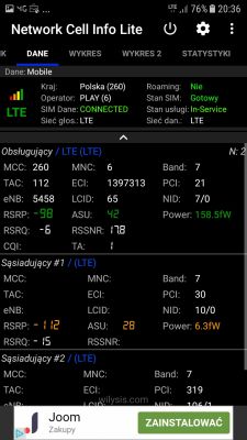

    Sure there is sense and even necessity. The card in the LTE phone with the Network Cell Info application and you show the DATA tab, plus a speedtest.

    I put the SIM card into the phone and I have the following results:
    Best Modem/Router for LTE Play: USB vs Built-In Modem, Recommendations & HotSpot Test in Ursynów Best Modem/Router for LTE Play: USB vs Built-In Modem, Recommendations & HotSpot Test in Ursynów
    Speedtest.pl gives 43Mb / s, speedtest.pl on another phone (making the network available via hotspot) gives 25Mb / s.
    Neostrada gives 10Mbps so the change should be for the better? :) Question from the first post: what to buy?

    I found such a BTS:
    Should I look for a modem that supports the 2600 band now? Isn't it that modems support all frequencies depending on the city? They are mobile after all :) Is this information from the application for any other purpose?

    It's BTS Nowoursynowska 154A and LTE2600 from it, signal sufficient, nice SINR and unloaded bandwidth. On LTE1800 and LTE2100 the signal should be a little better. Aggregation of LTE bands worked on BTS. The minimum is a stationary router with LTE-A 6 cat. I.e. aggregates two LTE bands, e.g. B525, E5186 and LTE2600 + 1800 aggregation. More expensive B715 with aggregation of 3 LTE bands including LTE2600 + 1800 + 800. from mobile 3 LTE bands including LTE2600 + 2100 + 1800 aggregates MF980 but I do not recommend such routers for 24/7 operation as a home router. Signal parameters at home are quite poor, an external antenna is needed to improve them.
