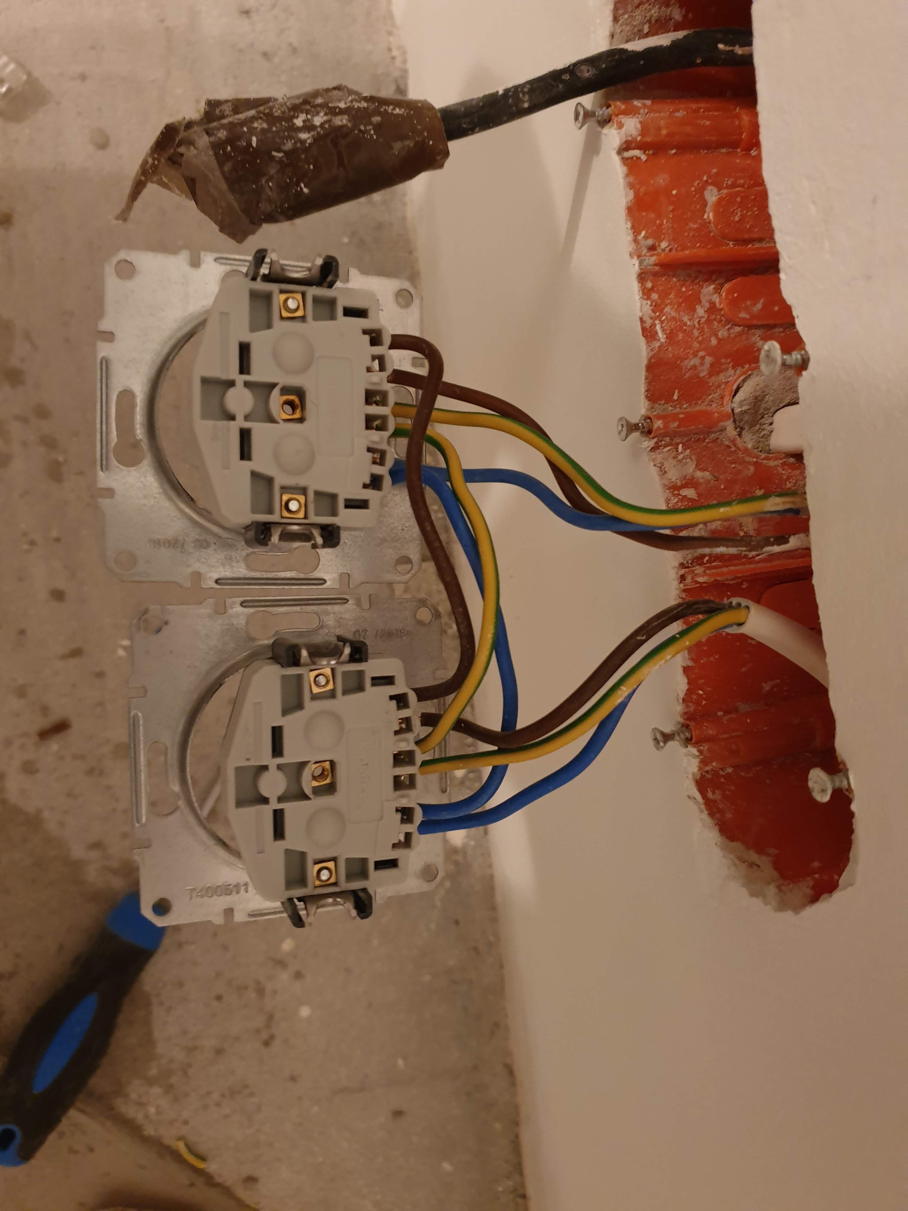

    Hello, I am not an electrician, but a person who undergoes a general renovation, including electrics - boxless installation. The installers laid the entire installation and will take measurements, but I noticed that each of them connects the sockets differently (mainly 2-4 sockets in a long box), can you help me verify that everything is ok?
    However, before I posted the topic, I searched a bit on the Internet and rather everyone commented on the correct way, i.e. each of the three wagos connects two through cables (L/N/PE) and we also branch the wires to the sockets from each wago, i.e. if there are three sockets, then the wago should have 5 "ports" (this is what one electrician from the left in photo 1 did), the other one did differently, claiming that it was a pass-through socket (photo 2, a much older electrician :) and what seems to me to be a bad connection, but referred to the attached instructions on the socket (photo #3). I tried to find such a connection on the Internet, but I couldn't find it. As for photo No. 3, looking at the electrode forum and what I read, I would do the wago connector and only from the wago connector would I go to the sockets and connect them only as in photo No. 2, not directly / through. Am I wrong?
    I am asking for help, because if they also measure, they can mask their mistakes, and I have no basis or knowledge to undermine someone else's work. I'm just afraid of problems when using this installation in the future.
    Thank you very much in advance

    The brown (phase) should be on the left. The use of WAGO is perfectly acceptable, as is the use of wire bridges. A matter of convenience/time/cost.
    As long as the measurements come out OK and the appropriate cross-section is used, there is nothing to complain about.
    Two wires can be screwed to one socket without any problems - three not necessarily, and if you don't need to use WAGO, there is no need. And if you need to use WAGO, you can use the appropriate WAGO and single bridges. At least when something doesn't work, you know where the problem is.

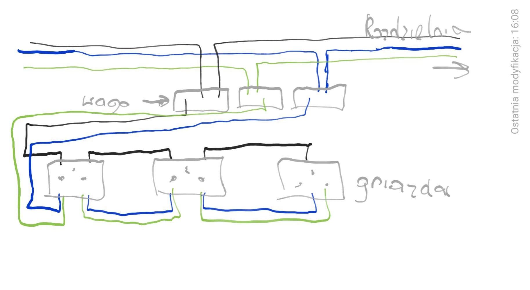

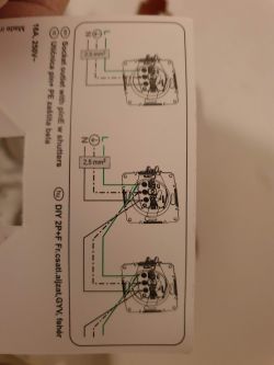

    Boxless installation of socket outlets, step by step
    Without being picky about reading it carefully, I read this article and based on it, I described that everyone recommends doing it (photo 1), because it is correct, and the connection that I did not find and which I pick on was related to photo No. 2, i.e. without a cube - socket 1 comes from the switchgear, socket 3 comes out and goes to the wall. Isn't it so that if any of these sockets in this variant burns out or is damaged, the circuit is interrupted? However, in this better situation, when the scale is on, the current goes along the line of least resistance through the scale, without engaging the sockets (of course, if nothing is turned on and does not consume power)?
    Please correct me if I'm wrong and tell me if this socket is good (photo 2), because that's all I care about. Do you guys install like this?
    PS when it comes to phase and side, there are markings and cables on the terminals according to of this socket are properly plugged in, assuming that brown is phase and blue is N.
    Misconception. In the case of direct connection, only the terminals of the socket participate in the current flow, and their construction allows it.
    Of course, the version with wago strips and terminal blocks has the advantage that after the socket is damaged, the circuit is not interrupted.
    We assemble at home as in the picture I attached. That is, the wires are connected with connectors, and it goes to the socket only one set of them!!! Regardless of how many of these sockets there will be!
    Do not make connections on the terminals of the socket, this is not a good idea.
    adek- wrote:
    Thank you for the information, and is such a connection reasonable and will it be better in something,
    It doesn't make sense and it won't get better.
    That's all. If you want it, listen to it, if you don't want it, do what you want.

    He's not from outer space.
    This drawing shows a mixed connection.
    A better solution is the combination presented by a colleague retrofood in post #6
    P.S. You beat me to it :D

    adek- wrote:
    elpapiotr wrote:
    In the case of direct connection, only the terminals of the socket are involved in the current flow, and their construction allows it.
    Thank you for the information, and is such a connection justified and will it be better in something, e.g. the circuit will not be interrupted, and only the sockets from the damaged one will not work, or is this "my" logic invention from outer space? Sorry for the very amateur drawing and for the stupid question of a dilettante, but how did I get here ;) .
    Fitters connect sockets in different ways, is it the right one?
    Yes, your layout is OK. It makes the most sense, because disconnecting the socket does not break the circuit, and the through-connection of subsequent sockets within one box (when using 5-pole WAGO) simplifies stuffing the wires in the box.
    However, through-connection of the entire circuit (without WAGO, as in the second photo from the first post) is not prohibited and is used. But I do not recommend.
    PS The connectors you have used are "WAGO type" connectors, not WAGO. It can make a difference though. Pointless savings.

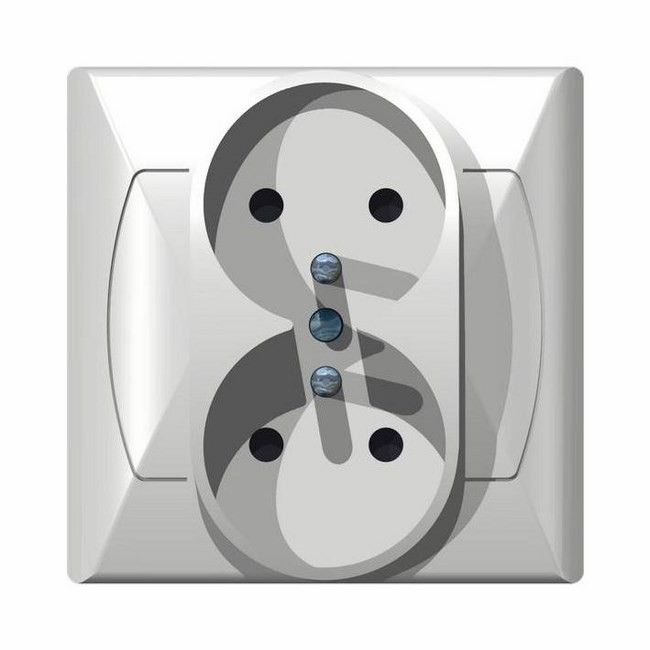

    Do you mean absolute positioning relative to the pin? My guess is that the purpose of the standard was not absolute alignment but relative.

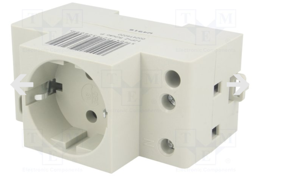

    Here is the factory socket for the TH bus from ETI with the N terminal marked on the left side:

    And how does someone mount such a double socket horizontally?

    This phase must be at the top :) Relatively, of course.
    You should add "looking at the socket so that the N terminal is on the left".
