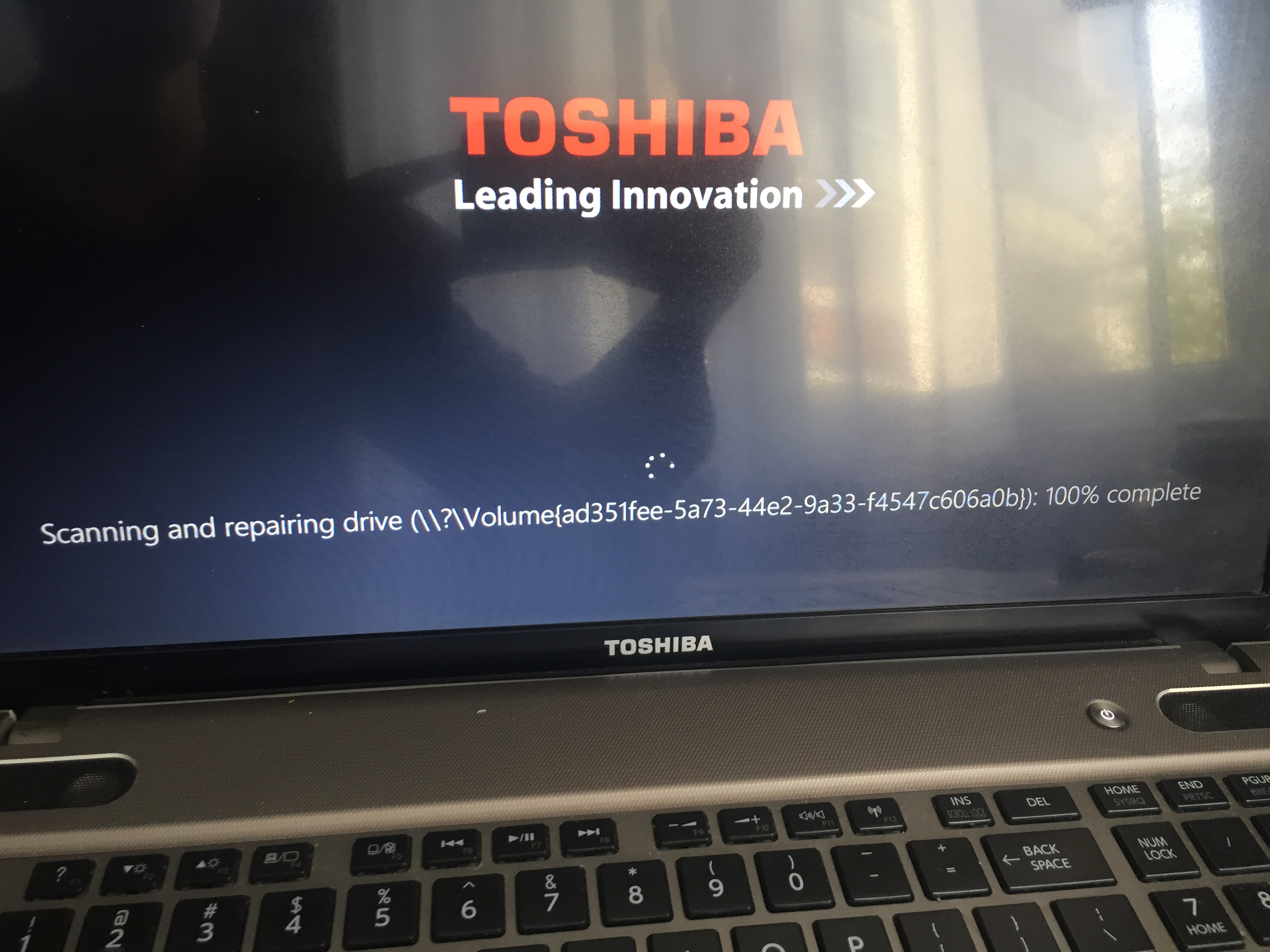

    How does it look like ?
    Toshiba - Scanning and Repairing drive - when starting the computer.
    What was done?
    - Reinstall Windows 10
    - Command "chkdsk / f / r" in bios
    The problem appeared after one of the Windows 10 updates.

    I guess the scan is on a different partition than the one you scanned yourself.
    Check all the partitions you have on the disk, not just C :.

    Hmm, how do I scan these partitions? Then I booted the PC from a pendrive with Windows, chose the console, typed C: then chkdsk / f / r.
    This is what partitions look like
    https://s18.postimg.org/57gb57ipl/IMG-4051.jpg
    PS For some reason the prtsc button doesn't work :(

    You can assign letters to these partitions and scan like c :.
    If you do not have anything important on the disk, including recovery, you can delete all partitions from the disk and create new ones during the installation.
    Why do you have this unallocated space at the beginning of the disk?

    Because I deleted one today
    Added after 31 [minutes]:
    The problem is that with these partitions, I can't add a letter ... As it is with the C drive:
    To remove all of them I have to install win7 (because only there is an option to select and delete partitions during installation), and then Win10

    Provide SMART for this disk.

    The drive is 100% healthy, which is already in use. It all started after one of the windows 10 updates.

    One of the next Windows updates solved the problem.
