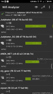

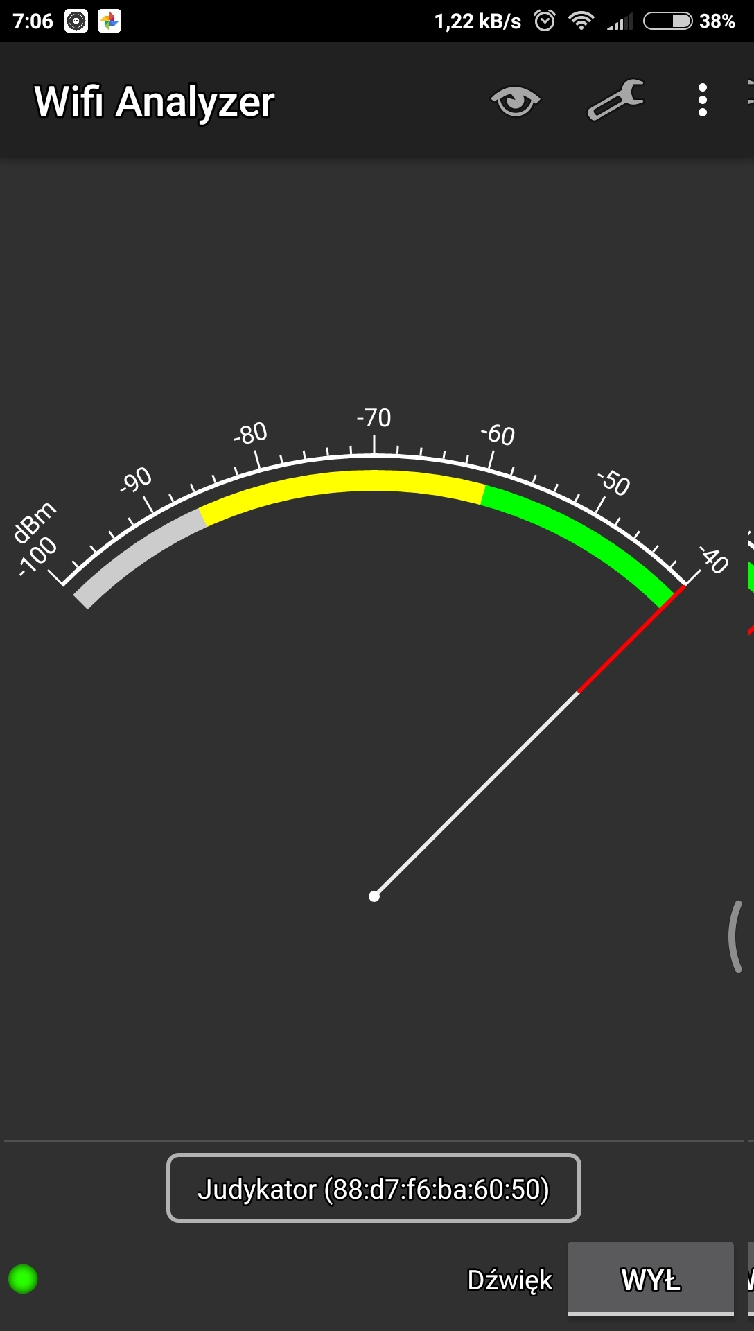

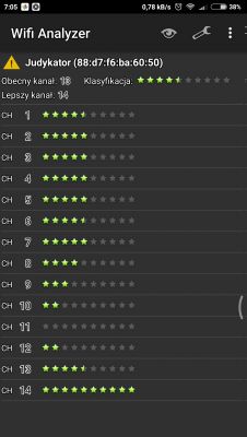

    Show screenshots from WiFi Analyzer.
  • #10 16972257
    Judykator
    Posts: 115
    Rate: 26
    I don't know if it will help, because they are pictures in the morning and in the room with the router
