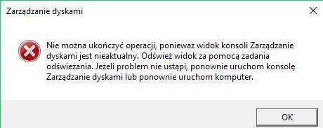

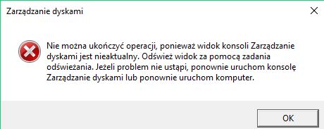

    I have a problem that arose out of nowhere. Recently, no win10 detects a pendrive or an external disk, but I can not read it in the windows exploit. I've tried reinstalling the USB drivers and tried to change the drive letter, but then it displays this message to me: Win10 - Detects an external drive / flash drive, but it can not be seen in the e
    I was refreshing the list of disks as in the message, but it did not help.
    I tried to restore the system to the last restore point and also did not work.
    I scanned the computer to repair the registers - nothing more.
    On other computers, flash drives and disks are read normally.
    Anyone have any idea yet?

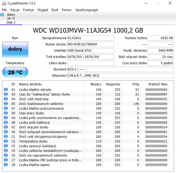

    He did not find the disk
    I do not know if this matters, but the problem concerns the HP Pavilion x2 tablet, where the system is on the internal memory of ssd. Does CristalInfo also read ssd disks?
  • #4 16599052
    Kolobos
    IT specialist
    Posts: 85178
    Help: 17171
    Rate: 10455
    Check whether it displays the smart disk connected under the USB.
    CDI works with ssd disks.

    The disk connected under USB reads without a problem:
