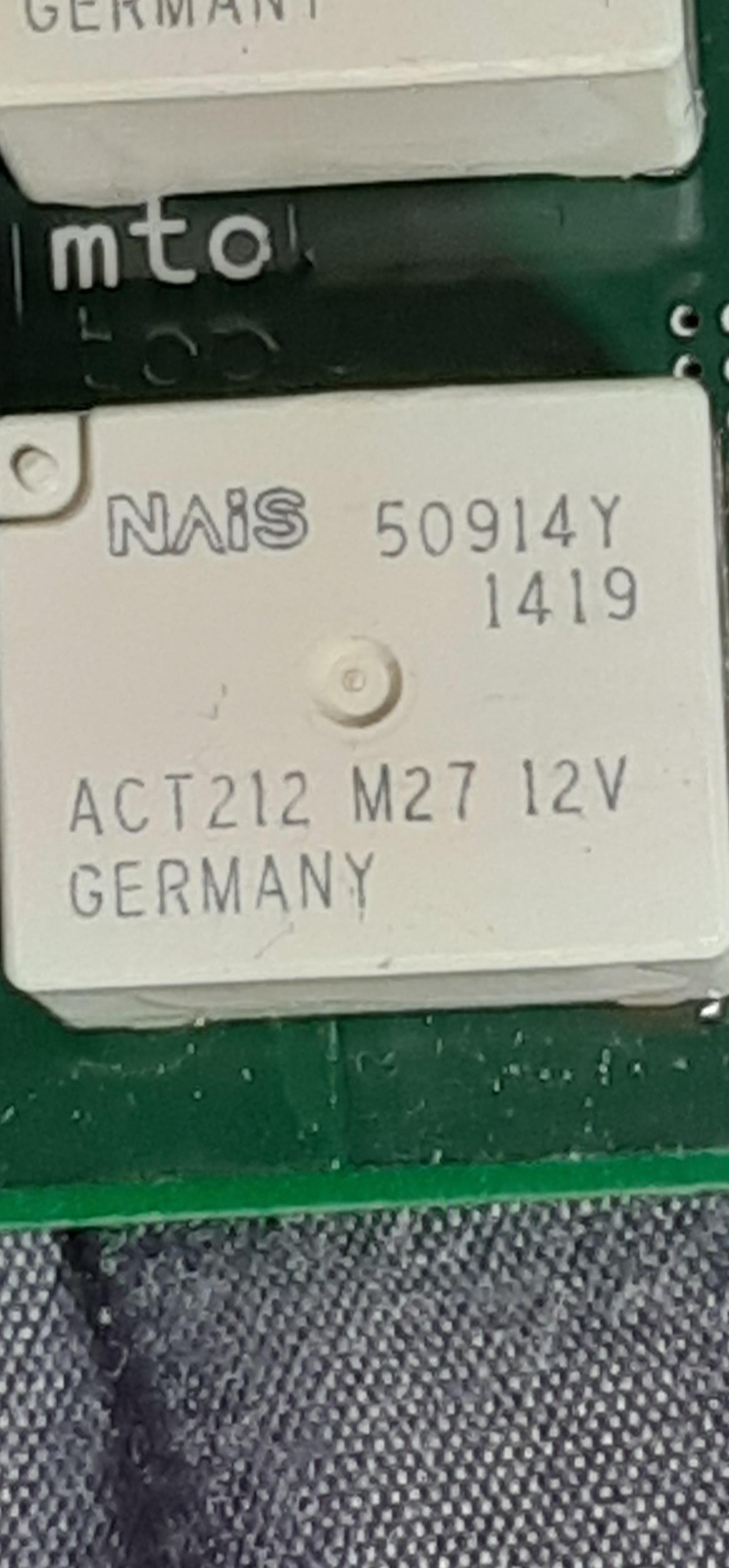

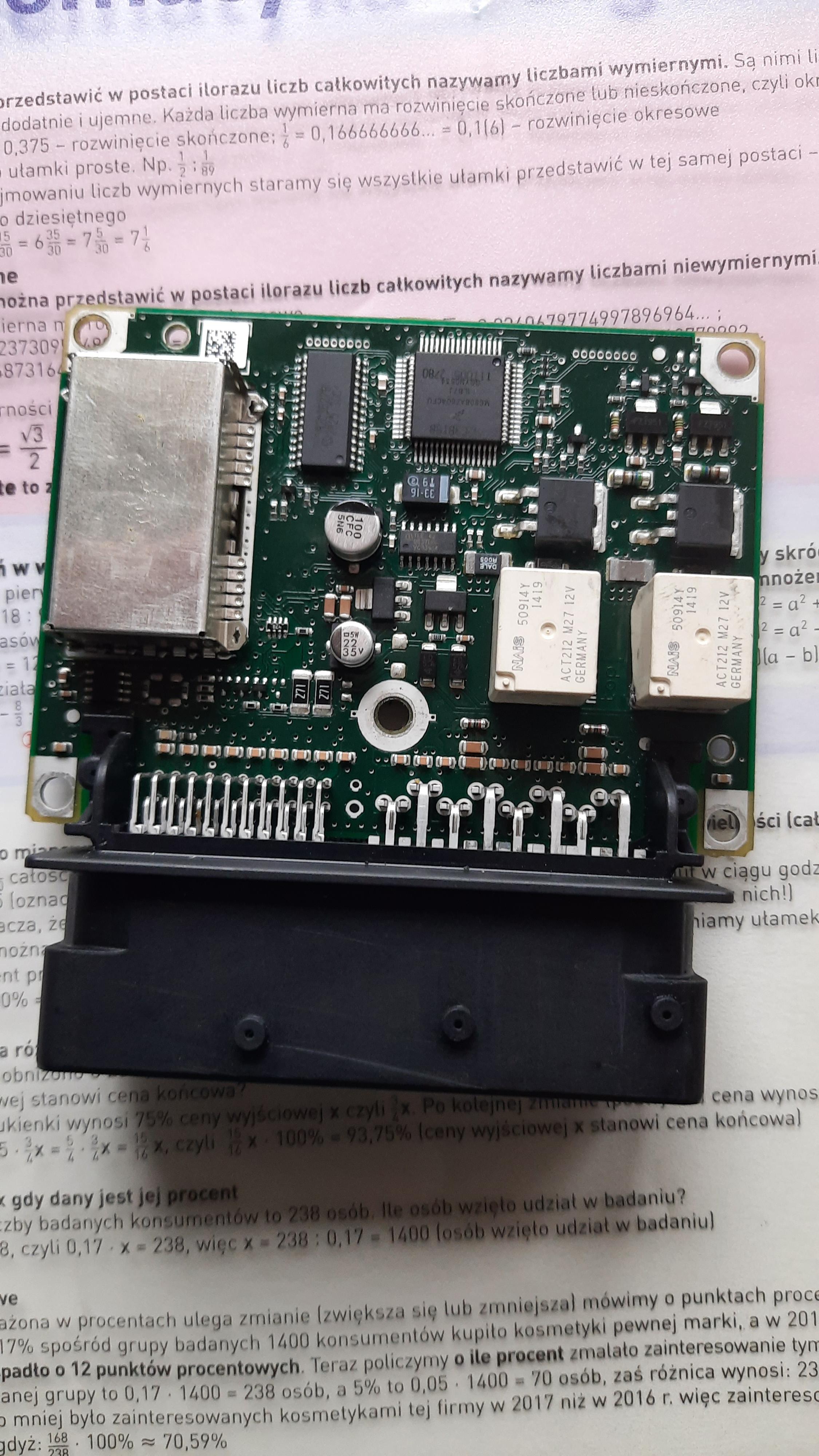

  • #44 19736931
    krzysiek29241
    You need to solder the relay in the driver and the hula driver!
