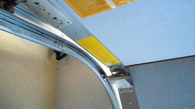

    Can anyone help me with the adjustment of the DROMA THP-40 4 sectional garage door?
    For some time, she started to jump when opening (the second segment - from the top). I showed it in the attached video.

    Rate: 425
    From what I can see, something is blocking the treadmill, but lower or on the other side.
  • #3 16605739
    Savek
    Posts: 619
    Rate: 53
    Nothing's blocking it. I have a video of closing and opening (I cut this fragment out of it). It looks like the entire segment is skipping, but only on the side I was filming. The other side moves without jumping.

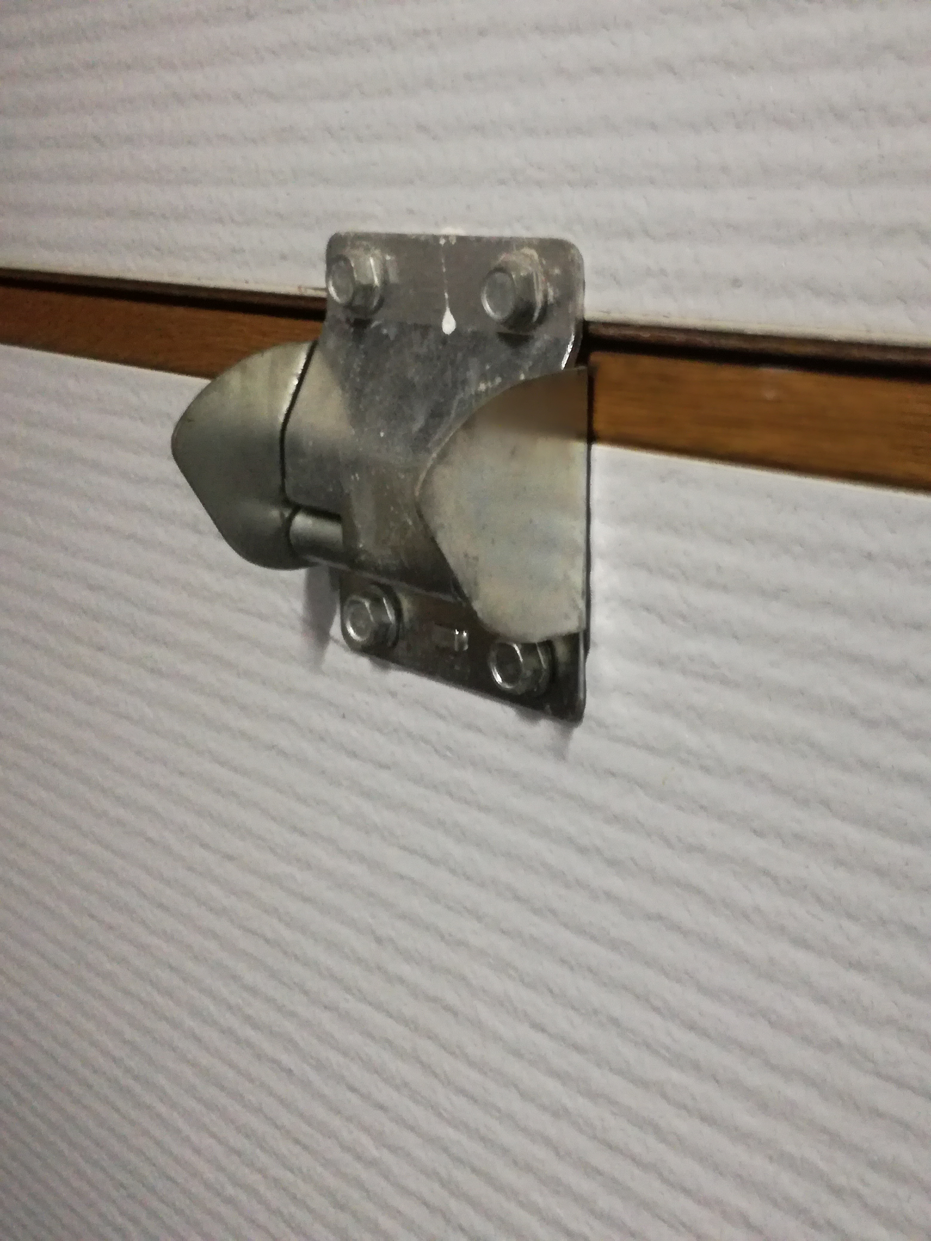

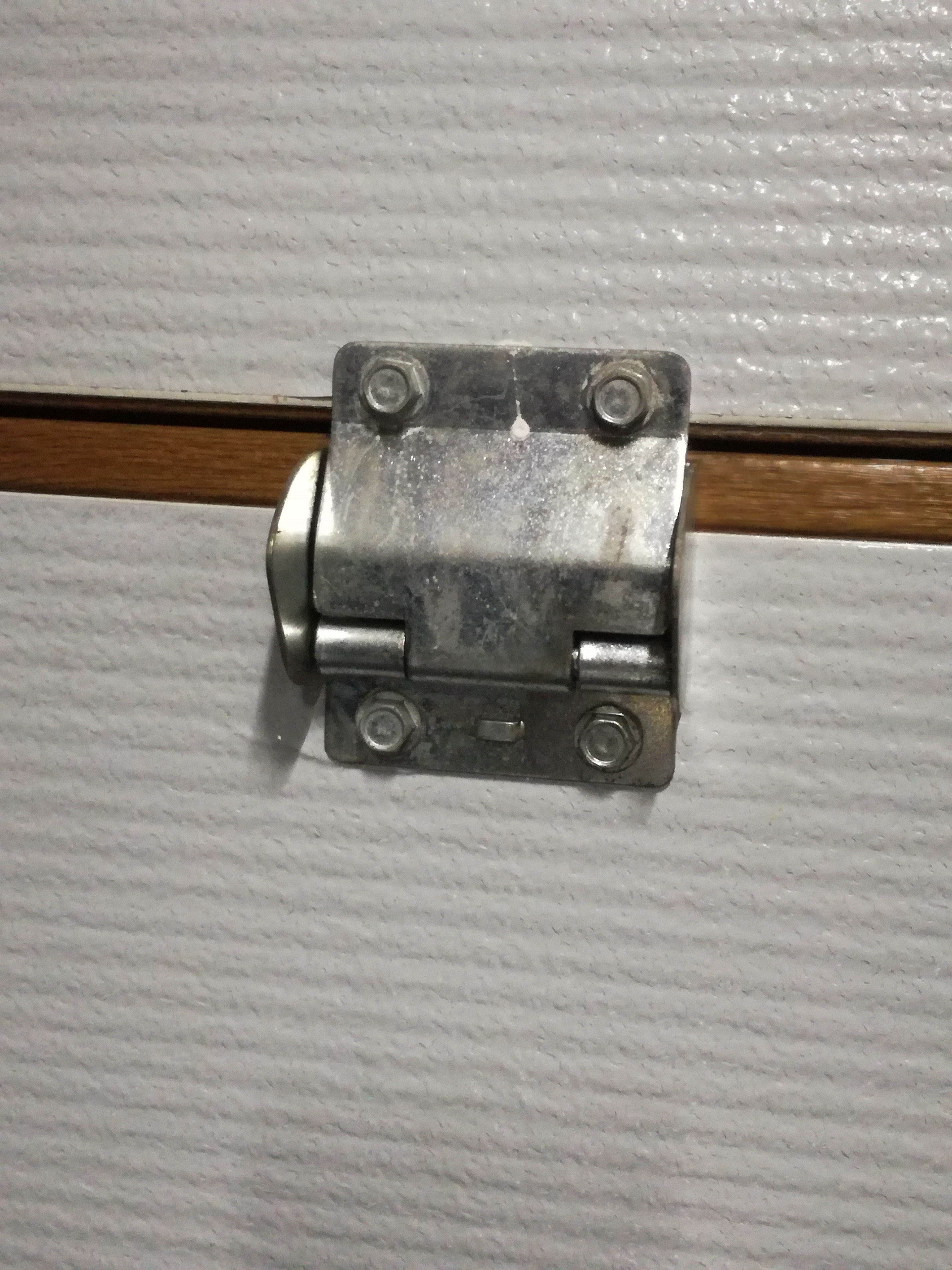

  • #6 16613096
    Savek
    Posts: 619
    Rate: 53
    lz11980 wrote:
    Check, buddy, all the screws that are in the guide, lubricate the axles of the rollers in the hinges, besides, check if any clamps of the roller axles have not loosened, additionally check the connections on the bend of the guide, vertical / horizontal. Check that all hinges are tightened or that the connecting pin has not jumped out of them.
    I checked everything and lubricated it. It looks ok.
    I have the middle hinges as shown in the pictures. In some, the lower screws twist a little (they go into the foam), but there are two more under the hinge that they hold.
    Adjusting DROMA THP-40 Sectional Garage Door: Solutions for Jumping Segments (Video Included) Adjusting DROMA THP-40 Sectional Garage Door: Solutions for Jumping Segments (Video Included)
    I noticed that when manually lifting the gate and pressing in the middle of the second panel from the top (from the outside), there is no such jump.

  • #11 20188765
    Savek
    Posts: 619
    Rate: 53
    I will write how the topic ended (better late than never).
    A professional came and adjusted the springs.
    For several years of operation, they have shifted in mounting.
    He adjusted and as you can see until today (five years pass) everything is OK.
