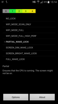

    In previous posts, I forgot to mention that two times after taking the battery out of the phone and restarting, I started the Download Mode automatically, and the error DDI-mmc read failed- I followed this trail and on some foreign site (below the link to view):
    https://us.community.samsung.com/t5/Galaxy-No...-normal-boot-mmc-read-failed-error/td-p/84750
    I found information that quite a lot of people have the same problem and that it is probably the fault of updating the system - although the websites want to exchange motherboards.
    There is also info that helpful in this my problem with hanging up the phone, can be a Wake Lock application with the parameter PARTIAL WAKE LOCK set:
    Samsung Galaxy Note 4 - The phone hangs after replacing the charging plate
    From what I understand this option causes the processor to be turned on despite the screen being turned off - and some people suggest that it really works.
    I installed it yesterday in the morning and how the phone is going without any complaints, as if it was fully functional - and normally it would have been suspended several times.
    What do you say ?
    greetings
