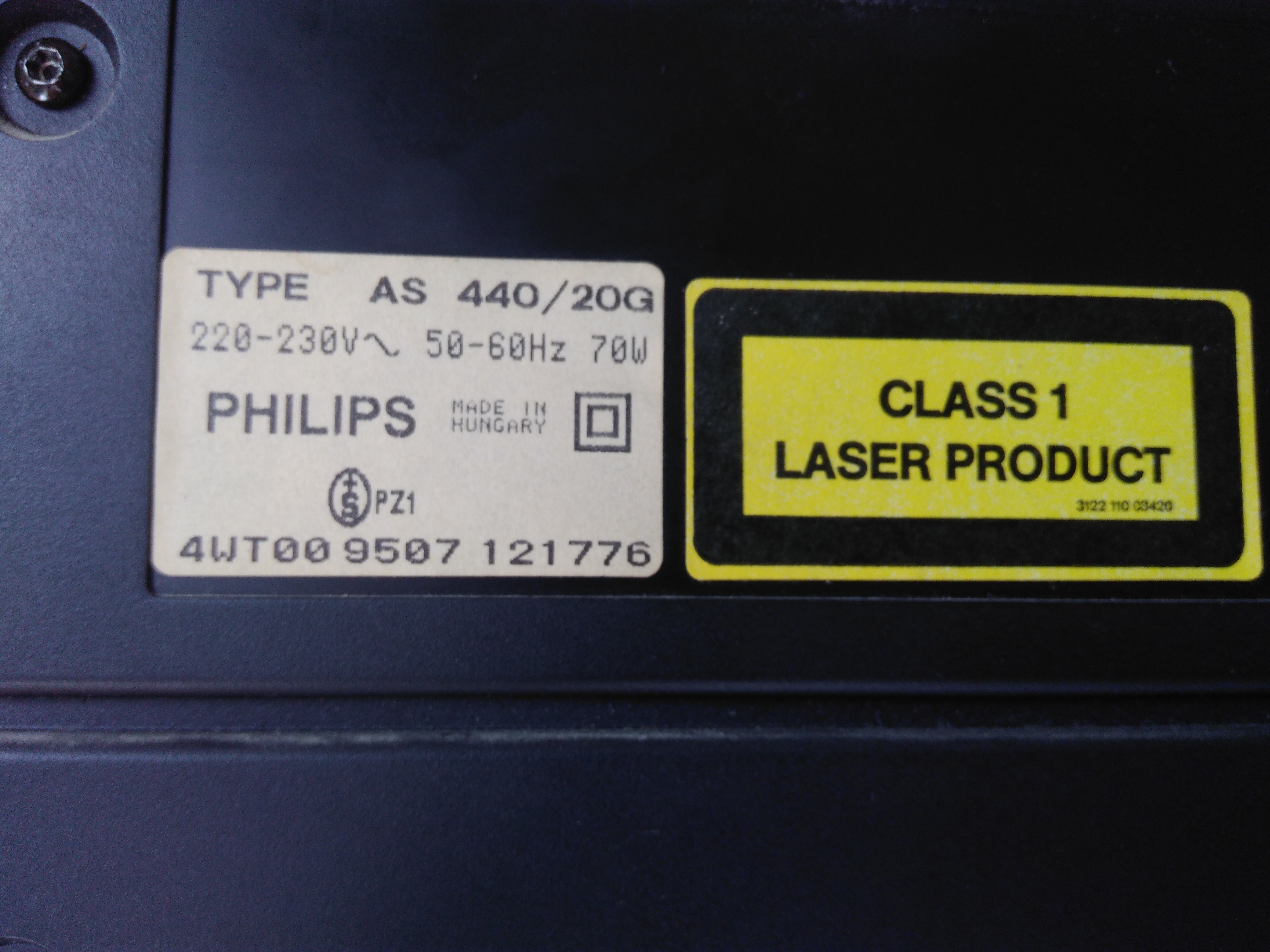

    I do not know what kind of tower it is, I know that it is Philips, I do not know the model in this tower, there were two speakers, the tower has a 2x50 watt amplifier, but I do not know how it is with ohm. In these loudspeakers there were 2 drivers, one mid-tweeter 30 w at 8 ohms and the other 20 woofer 6 ohms. And I want to buy new ones because the original ones don't work. It was destroyed by children. And I have a question, I have an eye on the speakers for this 2x50 w 6 ohm tower whether they will work or not
  • #4 16610354
    Ricoh_220
    Posts: 3714
    Help: 464
    Rate: 752
    Doesn't this tower have a nameplate?
    Just provide her picture.
    Moreover, loudspeakers with higher impedance can be safely switched on
    So instead of 6 ohms, you can safely turn on 8 ohms, you will only lose a little power.

    However, this is a tower, such as the Philiss AS440 / 20H tower, 80 watts, so how to choose the speakers

    • Choosing Suitable Speakers for Tower: Comparing 20w 6ohm, 30w 8ohm, and 2x50w 6ohm Models 1501251927178-1313846592.jpg (2.8 MB) You must be logged in to download this attachment.

    So for 70w I can only use 20w?
  • #10 16613573
    sebap
    Posts: 7139
    Help: 538
    Rate: 1078
    70W, it is off-grid it has. This power is distributed throughout the tower.

    Let me elaborate, because as I can see the Author has no idea about it ...:
    The power given as POWER CONSUMPTION is the total power that the tower can draw from the mains at maximum control. This power is actually the power of the power supply - the transformer that is to power all the tower blocks; tuner, tape recorder (if available), CD (if available), all intermediate circuits (tone control for example) and power amplifiers. The latter, depending on how they are built, have a certain efficiency - in most cases in this type of towers this efficiency is approx. 60% - so after adding up all receivers (modules / components) it comes out (as my colleagues wrote above, and the manufacturer also provided in the specification) 10W sine per channel. The musical power, in turn, depends largely on the power supply itself; on its ability to give a certain current over time. The weaker the power supply, the greater the music power (in this case, the power is 20W per channel, but usually the music power does not exceed 150% of the sinus power), because the voltage drops by some amount during a greater load.
    Further - these 10W are the "base" - power that can be considered the minimum power of the speaker units (speakers). There is nothing to prevent the power of the speakers / speaker units from being greater - the amplifier will give it back as much as it can - the speakers will simply operate at a power lower than their nominal power. It is important (and you should always remember this!) That the resistance of the loudspeaker should not be lower than the resistance specified by the manufacturer of the tower - lower resistance means higher current flowing through the amplifier circuits (and of course the power supply), higher losses in the power amplifiers, higher temperature and the real possibility of damaging the power amplifiers (power amplifiers).
    In this case, the manufacturer gives a nominal load resistance of 6 ohms - this is the so-called "golden mean" - resistance is often given as nominal resistance in small towers, home theaters, etc., to somehow allow the use of resistance in the area indicated. Unfortunately - it is also often the resistance resulting from the power output capacity of the amplifier system used to obtain the maximum power that can be "squeezed" from the amplifier system and connecting a lower resistance may overload the amplifier and possibly damage it ...
    On the other hand, connecting columns with higher resistance does not cause any dangers - at most, the power will drop slightly.
