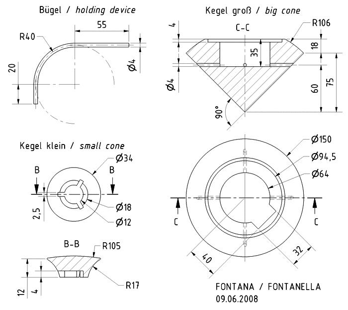

    4) construction details of the cone/diffuser,
    Wooden cone made from assembling several discs. Wooden cone with visible layers against a background of books.
    It is/was glued together from several (4 circles of appropriate thickness) and sanded to final shape.

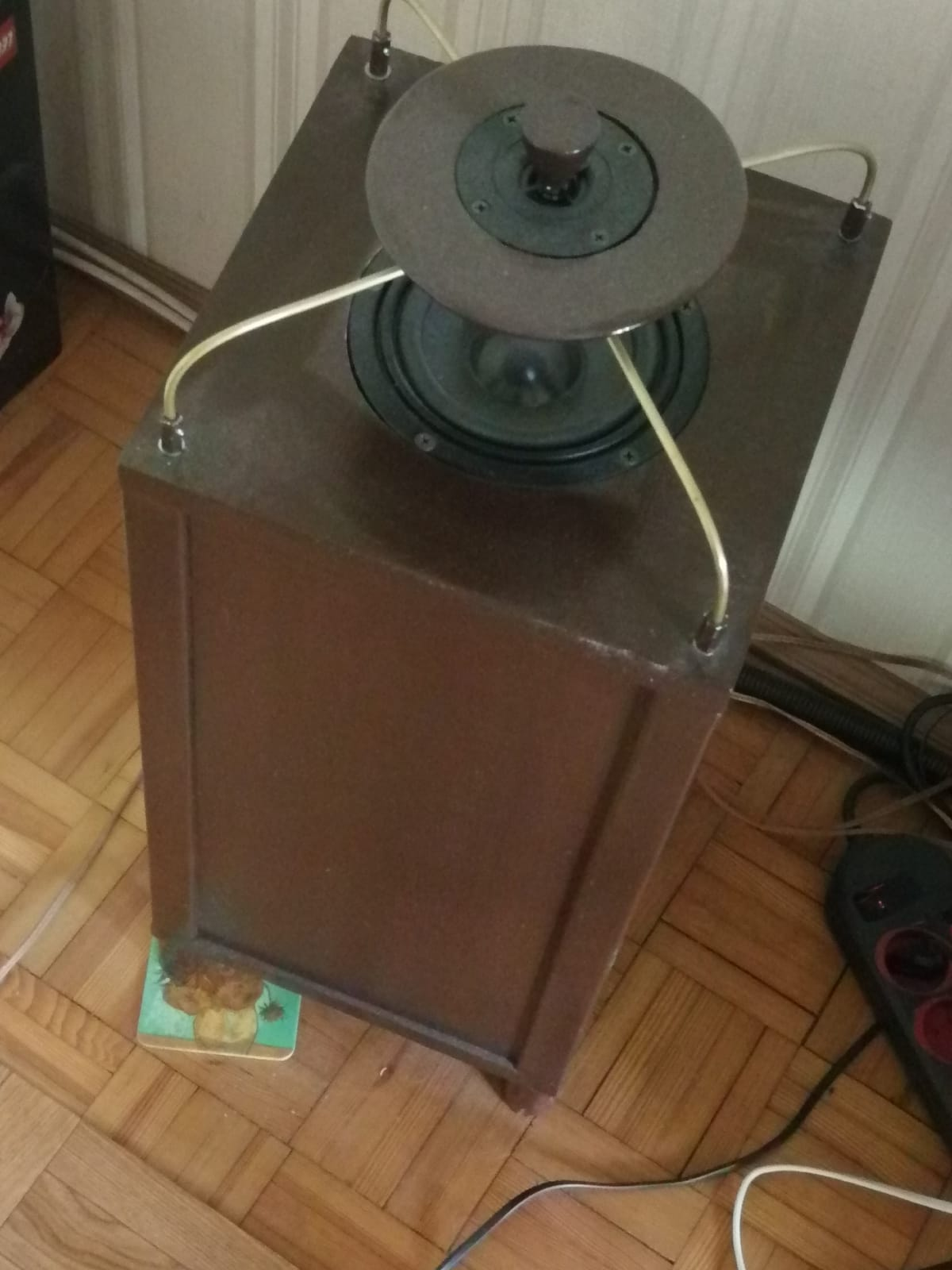

    You can't see it on the pictures, but due to the fact that the BR is facing the floor, the columns stand on 5 cm legs.
    Unfortunately I didn't take pictures of the final product, but for those interested I can ask the owner for such pictures.

    "Large" Montanas also have a smaller diffuser for the treble (photo left bottom)
    Technical drawing of speaker components, including a holding device and cones.
    In your speakers too? My impression is that without it the treble would be horizontally impaired.
    PS. Actually a photo of the finished speakers and crossover would be useful.

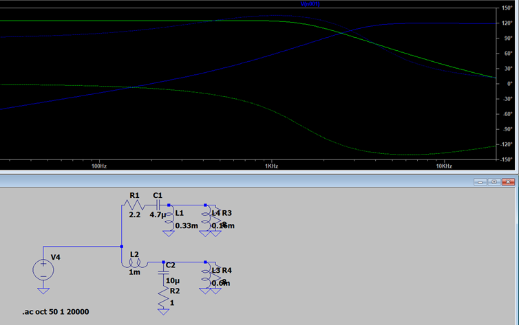

  • Crossovers and simulation images linked

    Hi
    Yes, both of my fountains have two diffusers, and you correctly noted that the sound would be "impoverished" due to the different way the sound propagates and builds up the panorama.
    I'll look for additional information.
    Greetings
    I'll link the crossovers and simulations:
    Electronic circuit simulation with frequency response graphs.
    I found the pictures:
    Speaker with two diffusers placed on a wooden floor next to a power strip. .

    My home big fountains are octagonal/valley, these as I mentioned had a bit of construction and transport constraints, that's why there was a forced shape and size.
