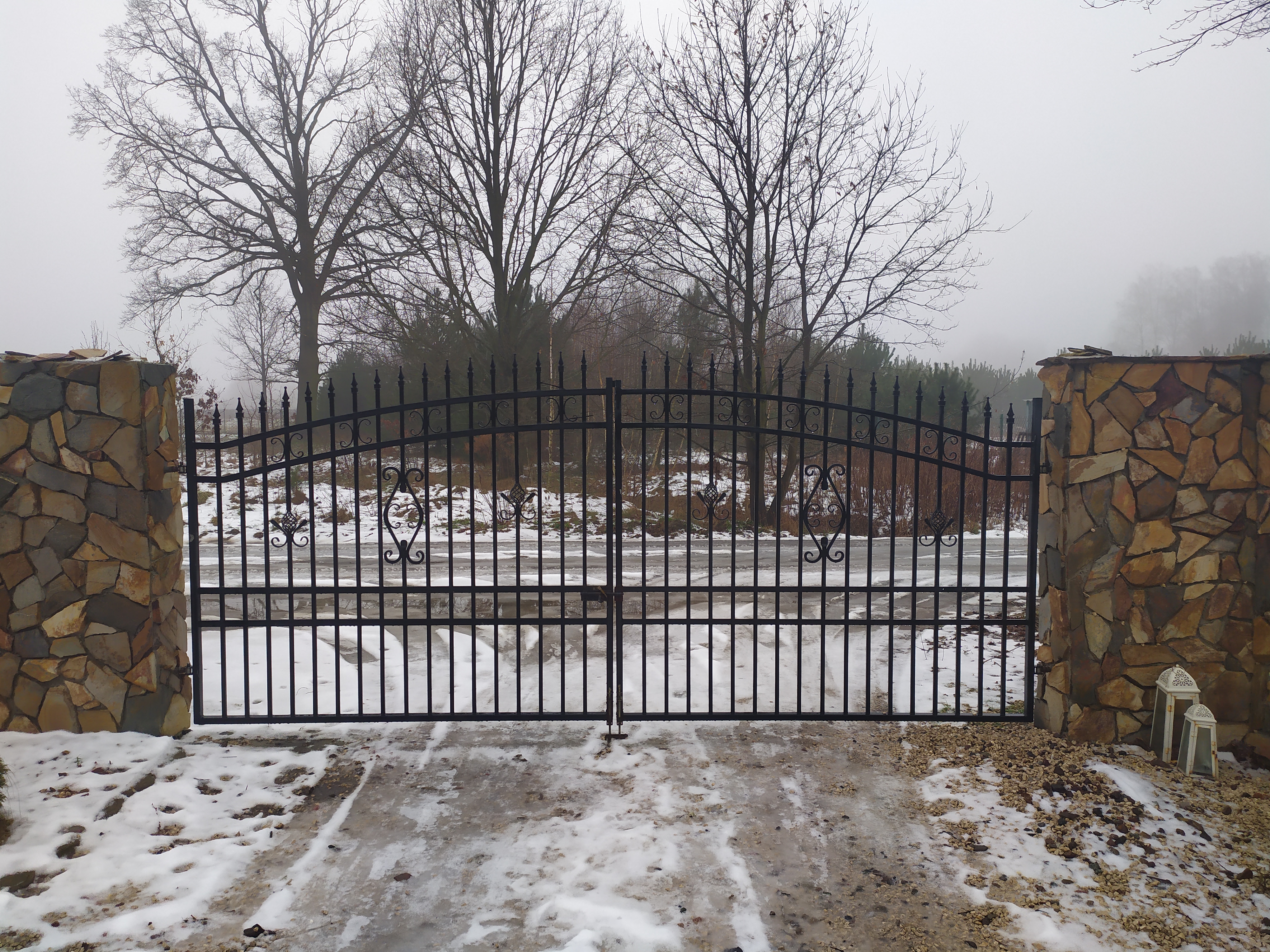

    I need two gates.
    I have all the data for one.
    The width of the wing is 170cm. Height 110cm. The weight of the wing is 50-60kg.
    I am adding a pictorial photo.

    Well, after the picture you can see that you probably need a drive "on the wide posts", i.e. with a sufficiently long stroke of the actuator or a broken arm. They work much better with a broken arm but are more expensive ...
    I recommend NICE WINGO (you're in the budget) or NICE HOOP (+ 500 PLN).

    Wingo? With such dimensions without forging, the contact is narrow (or not) longer Wingo 3524 or long Faust 414 L (to dimensions measured from the concrete of the post must be thrown, although 3 cm on the handle and doing A / B ok230mm - on contact). As far as possible, only super-long cylinders with a 50 cm extension, eg Beninca Bill 50, are fitted.
    It would be best to reach the gate at the gate (eg Nice Hopp). The fact that a bit more expensive but the ease of assembly and lack of combination - priceless.

    I wonder how you want to mount the wingo here with the correct dimensions.
    as above proposes a horn with a pitch of 400 or 500mm as it will need.
    jurek54 wrote:
    but I would suggest like the predecessor NICE HOOP or slightly cheaper NICE POP.
    Much more expensive and worse. Only it will open faster. I can already see this POP as some snow falls (look at the clearance under the gate in the picture) and the cube will "rise" 0 cm higher during frost.
    Linear 600 is a good trophy, it's enough here 400mm, and if it's not 600 + hits + a good Polish central station, radio and photos and you are making peacefully in 1500 PLN.
    NICE POP according to the specification: sash length - up to 2 m, sash weight - up to 200 kg. Clearance in this case can be increased by cutting off the paddles, and the snow unfortunately as it falls, and the trumpet will not move. The gate is not a snow plow.

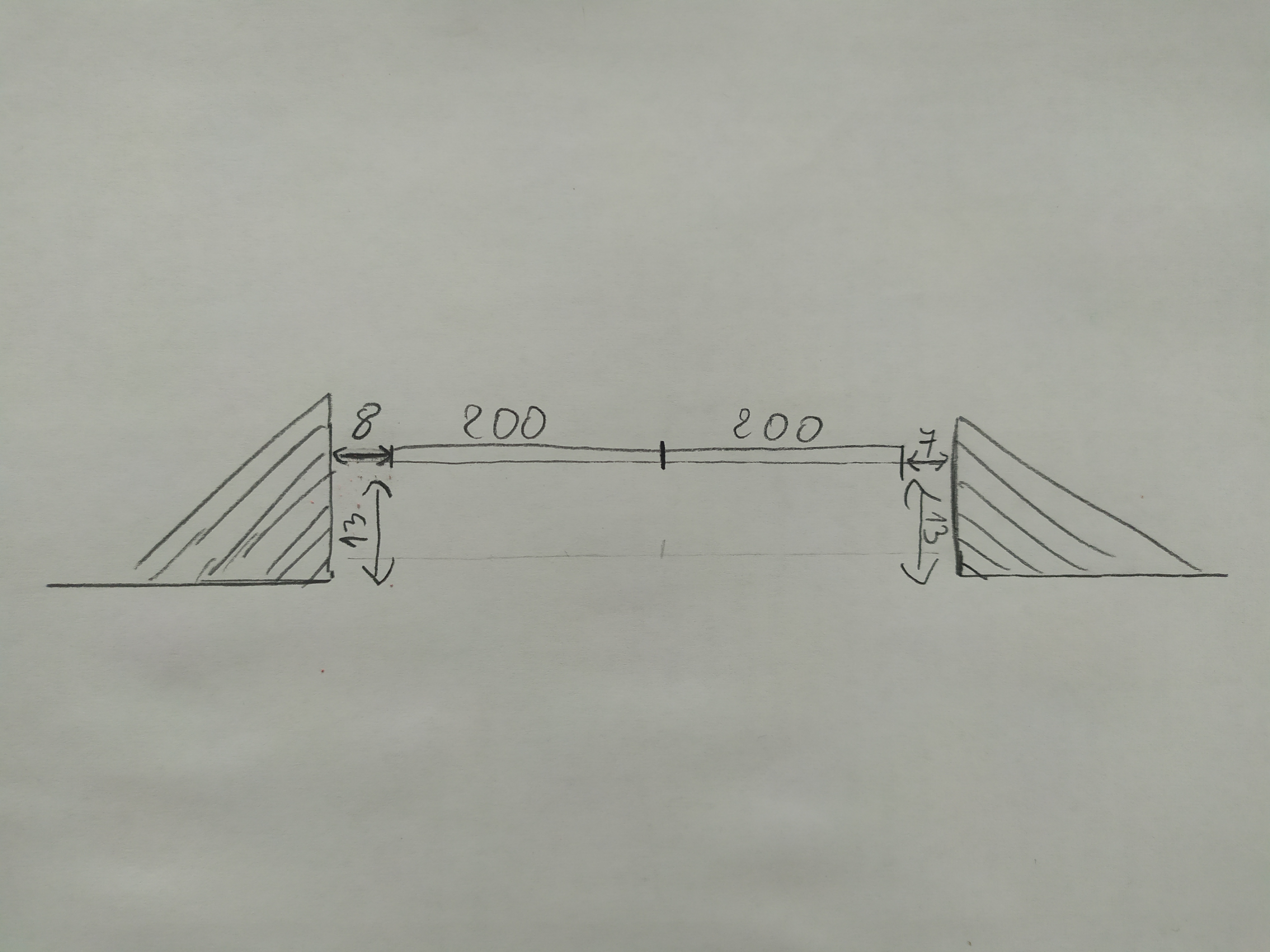

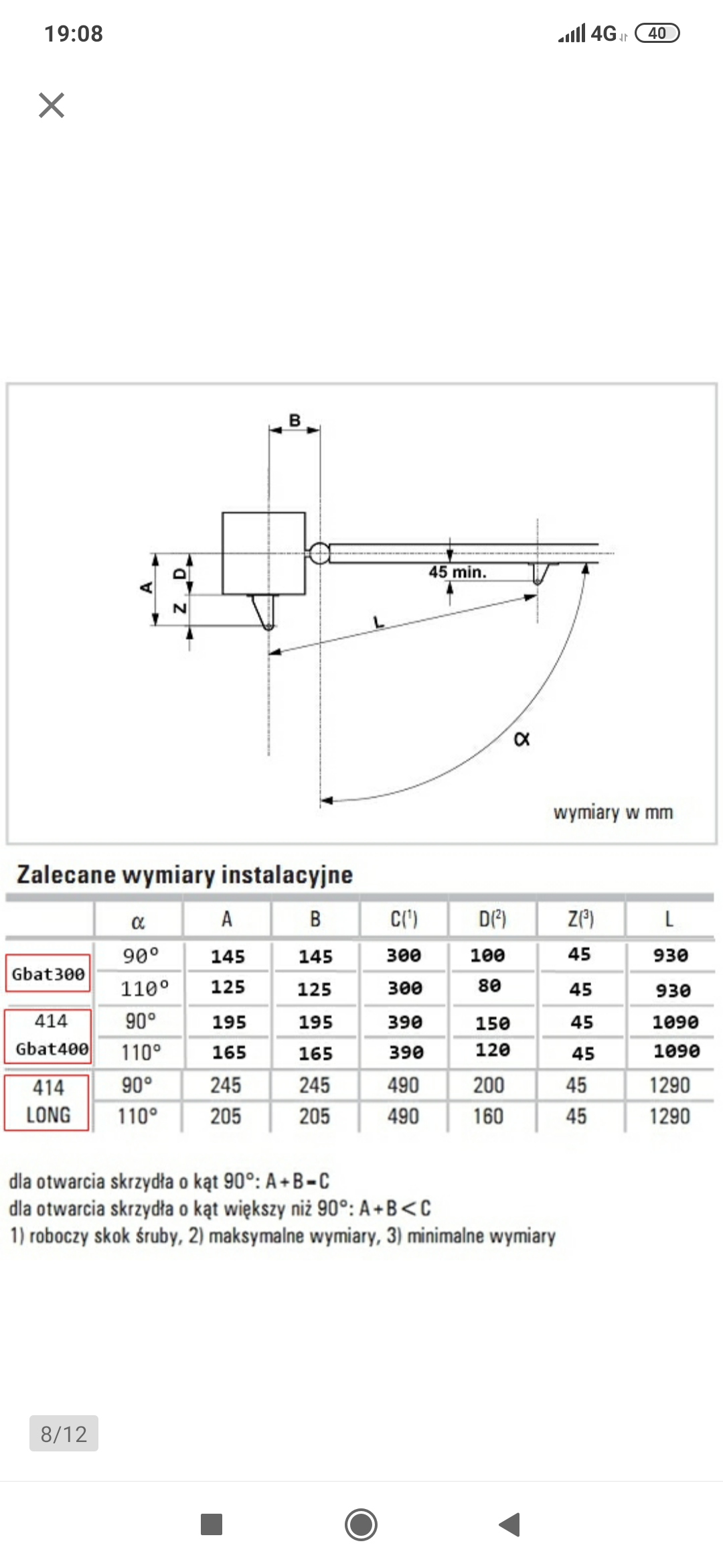

  • #19 19230152
    Śpioch9
    I stick to the topic. Wing 200/160
    I wonder if FAAC Genius 300 can do it because the length A would be longer than the catalog by about 3 cm

  • #20 19230258
    78db78
    Posts: 10486
    Help: 1785
    Rate: 3212
    If the gate is full and it presents a lot of resistance, it is worth checking if the drive is resistant to strong wind, because you will later support it with a pin, unless you do not live in an open area.
