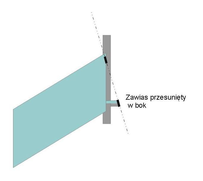

    rafal222u wrote:
    I've seen on YT such gates that float upwards when opened, but somehow I don't like this solution visually.
    I don't know if you understand what I mean.
    So I'm posting this simple drawing of what it would look like:
    Schematic drawing of a gate with a hinge shifted sideways on an extension arm. .
    The lower hinge would have to be offset slightly to the side on the outriggers.
    The angle of the axis of rotation of the hinges, relative to the vertical, would have to correspond to the angle between the ground plane of the gate and the bottom line of the leaf.
    With the gate closed, the plane of the leaf would coincide with the plane of the post.
    The leaf must be trapezoidal in shape and must slope slightly downwards at the end so that the bottom of the leaf is parallel to the terrain. As the sash opens, the end would maintain a constant distance from the ground plane throughout the movement.
    This is the simplest and least cumbersome solution. It is also aesthetically pleasing. After closing the gate, you cannot see that the wings are different (one whole and the other divided), that there are any additional cylinders on the wing.
    Of course, lifting the lower part with an actuator is not that complicated. It is practically possible to use the additional control output of the control unit to actuate this third actuator.
    Of course, you can also make the wing part lift with an actuator, but you have an additional cost and more complications, and damage can occur if this third actuator fails or gets blocked.

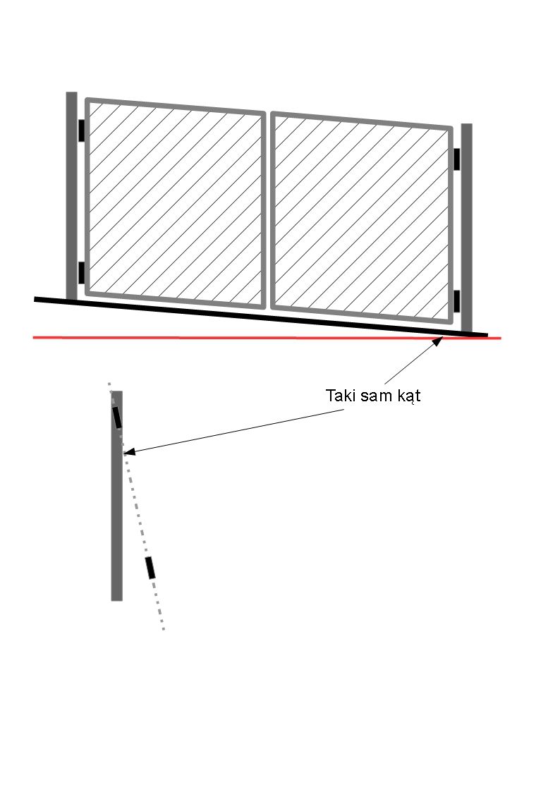

    If you have a gate on a slope then the gate will look like this:
    Diagram of a double-leaf gate on a slope, with hinge axis angle matching the ground’s inclination indicated. .
    The gate wings will not be rectangles but rhombuses.
    The red dash is the horizontal.
    The black dash is the slope of the ground (earth) in the gate.
    You won't have a problem with the right wing at all, because when the wing is open, there will be more space between the end of the wing and the ground than when the gate is closed.
    You only have a problem with the leaf that slopes downwards in the gate, i.e. the left one, because this leaf slopes down and by opening it the gap will decrease.
    In order for this left leaf to be at a constant distance from the ground when opening, the angle of the hinge axis must be at an angle with the ground relative to the horizontal.
    I am assuming, of course, that the cannon only descends in one direction.
    However, if it also slopes inwards or outwards then this must be additionally taken into account in the inclination of the hinge axis. If the land falls inwards, the angle of the hinge axis can be reduced by the angle of the land inwards.
    If the terrain slopes inwards, the angle of the hinges must also be increased by the same angle as the terrain slopes inwards from the door.

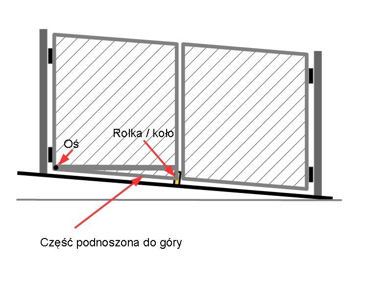

    But there is still the option of a roller-lifted bottom. The only disadvantage of this solution is that this raised section will be facing the passage light.
    Alternatively, it could be lifted up by a roller/wheel driving on the ground. If there are cobblestones or concrete, the roller will lift this part of the wing up.
    Diagram of a gate on a slope showing hinge axis, support roller, and the lifted section. .

    Then maybe actually make the bottom part liftable with a wheel going up the driveway.
    Alternatively, lifting the whole wing upwards. But then there's a bit of fiddling with the actuator mounts, which would have to be fitted with extra joints.
    Here, it would be best to be guided by the angles of the entry plane in each direction.

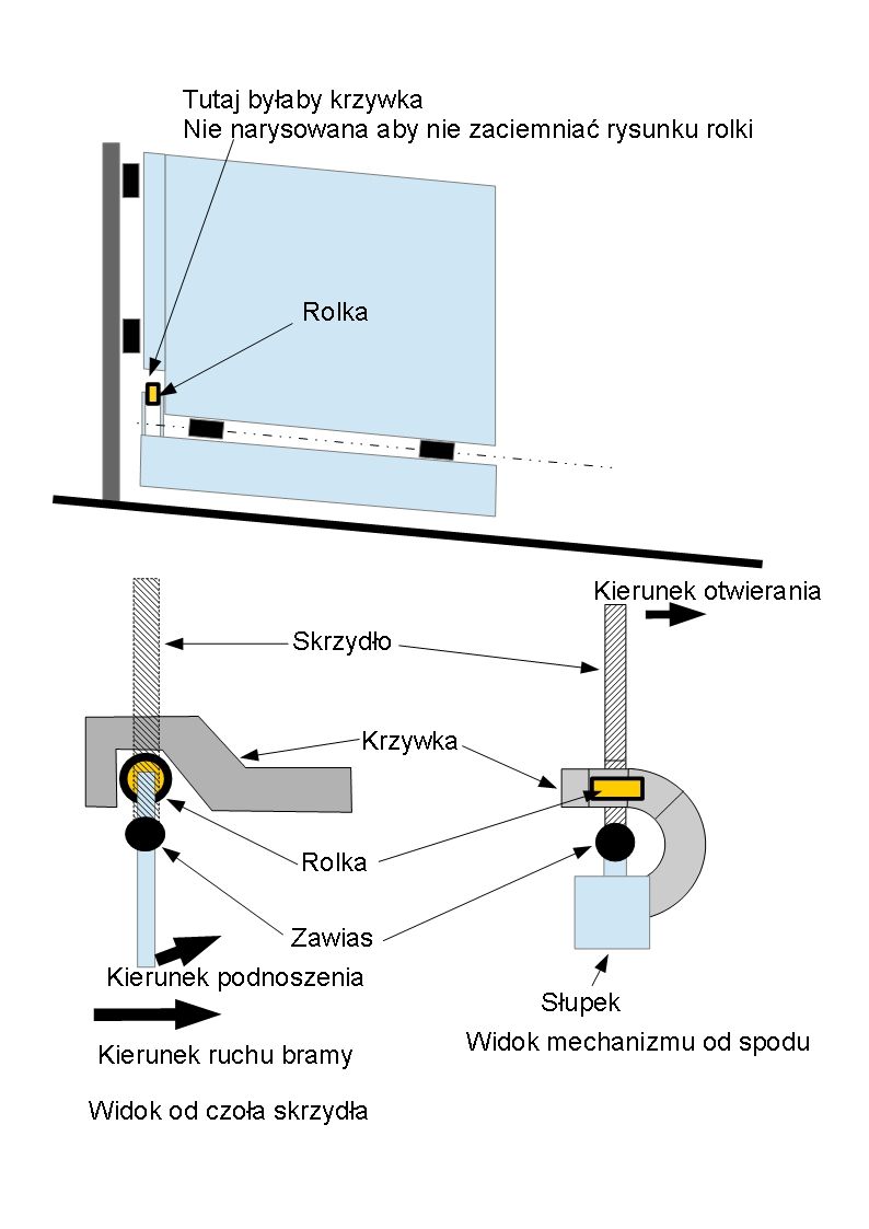

    From a technical point of view, the easiest way would be to make this bottom section hingeable.
    This part could be tilted by means of an additional rounded guide (cam) and a roller mounted to this moving part.

  • Cam-guided lower leaf prevents opening when closed
    #14 21561342
    Plumpi
    Heating systems specialist
    Posts: 8004
    Help: 861
    Rate: 2628
    Well, this is exactly the solution with the hinged lower part, guided by a roller, I wrote to you earlier, instead of lifting this lower part with an actuator. Only, as I mentioned before, the disadvantage is that this lower part enters the "light" of the door.
    If you don't mind, this would be the simplest mechanism to implement.
    But there is also the possibility to make this part lift the other way. You need a suitable cam along which the roller on the lever will move.
    Diagram of a gate mechanism lifting the lower part with a cam and roller, including labeled components. .
    I hope the drawings are clear enough to understand the principle of operation.
    The cam would lift this lower part of the wing in the same direction in which the wing would move.
    The advantage of this solution over the one shown in the video is that the lower part would not be able to be lifted when the door is closed, because the cam blocks this possibility.
    In the case of the solution shown in the film, the lower part can be lifted easily when the door is closed. Of course, for a thief such a gate is no protection, but, for example, a child playing in the yard or a dog, for example, could come out into the street.
    I also wrote to you earlier about such a cam solution.
    The cam must be shaped like a section of a circle/circle on which the roller moves.

    I understand your solution with the cam.
    In this solution with the wheel, theoretically you could add some kind of bolt that would lock this lower part during the closed position?

How does a wheel‑lift or cam‑lift lower section work?
A wheel under the lower segment rides up the driveway, lifting it as the leaf opens. Drawback: the raised piece projects into the passage. A cam‑and‑roller guide can lift in the leaf’s direction and also blocks lifting when closed. [Elektroda, Plumpi, post #21561342]
Does angled‑hinge geometry really increase ground clearance?
Yes. Example: ~3 cm hinge offset with ~1 m hinge spacing lifted a >2.5 m leaf by ~7 cm. “Custos actuators tolerate greater bracket deviation,” which helps with tilted planes. [Elektroda, Plumpi, post #21560867]
What does “trapezoidal/rhombus leaf” mean on a slope?
With sloped ground, closed leaves won’t be perfect rectangles. They form rhombus‑like shapes so the bottom edge follows grade. Set the hinge axis angle to track the ground and maintain constant clearance while opening. [Elektroda, Plumpi, post #21561039]

Can I lock a wheel‑lift lower section when closed?
Prefer a cam‑lift. The cam profile physically prevents lifting in the closed position, solving the security concern without an extra bolt. [Elektroda, Plumpi, post #21561342]
