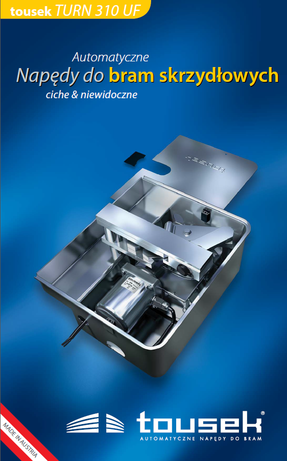

    There are also underground cylinders, relatively rarely used, only the cover is visible, which is flush with the ground.
    The advantage is the lack of visible elements (aesthetics), but also a very low risk of mechanical damage, devastation or theft.
    The prices of such drives are usually higher than those mounted above the ground.
    An example of an underground drive of the Austrian company Tousek.
    The maximum opening speed is 6 ° / s, which is approx. 15-20 s for the gate opening to an angle of 90 °.

    I would like to spend max. PLN 2,000 on the whole set, underground ones are probably much more expensive, and from these sets I wrote above, some will fit my gate?
    Sure, they are and rarely used, with the price of the equipment alone around 7,000. PLN + labor and materials will amount to 9 thousand.
    Tubular with standard assembly costs 2.5-3 thousand. max with labor and wiring.
