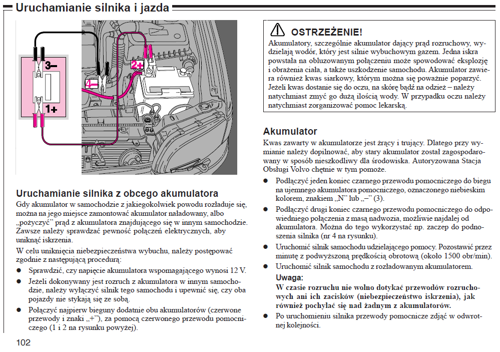

    Debate: Does Jump-Starting a Car with a Flat Battery Affect Battery Life?

    I will step on and ask professionals what the cable firing should look like.

    From my practice I know that as I often fired cars neighbors always a simple rule I connect the batteries, I start my own car and smoke a cigarette.
    After this time, the recipient starts the engine, I have never had problems.
    And the only repair of the voltage regulator was the replacement of brushes.

    Szyszkownik Kilkujadek
    Level 37  
    Posts: 5015
    Help: 211
    Rate: 1011
    @TheArt firing from cables should look exactly as it wrote @ Ricoh_220 . I would only exchange a cigarette for something healthier. :-)
    And the order of connecting activities is given in the graphic that I inserted.
