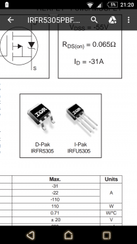

    I have a charger named in the topic, but it has stopped charging - the green diode is constantly lit, which means full charge, no voltage on the charging terminals. After drawing it looks like the pictures, the 12v zener diode and the gray large resistor heat terribly and the diode does not let voltage pass. After shorting the diode, voltage is given but the resistor even burns. It seems to me that the transistor in the second picture may have burnt and it is the reason for the confusion. However, I would prefer to hear the opinions of someone more knowledgeable

    I replaced the transistor and the 12v d3 diode. Still unchanged, the resistor and diode are burning. The voltage at the input of the resistor is 16.6V and at the output of 11V, no voltage passes through the diode. And 16.5V on both legs of the transistor. I have no idea how to approach this, how to measure something, please write, I will add value

    It looks like the pictures (yes I know mega makeshift but I bought a transistor in the wrong housing plus I wanted to see if it works).
    The transistor we are talking about is IRFR5305 I installed IRF5305 but it is generally the same
