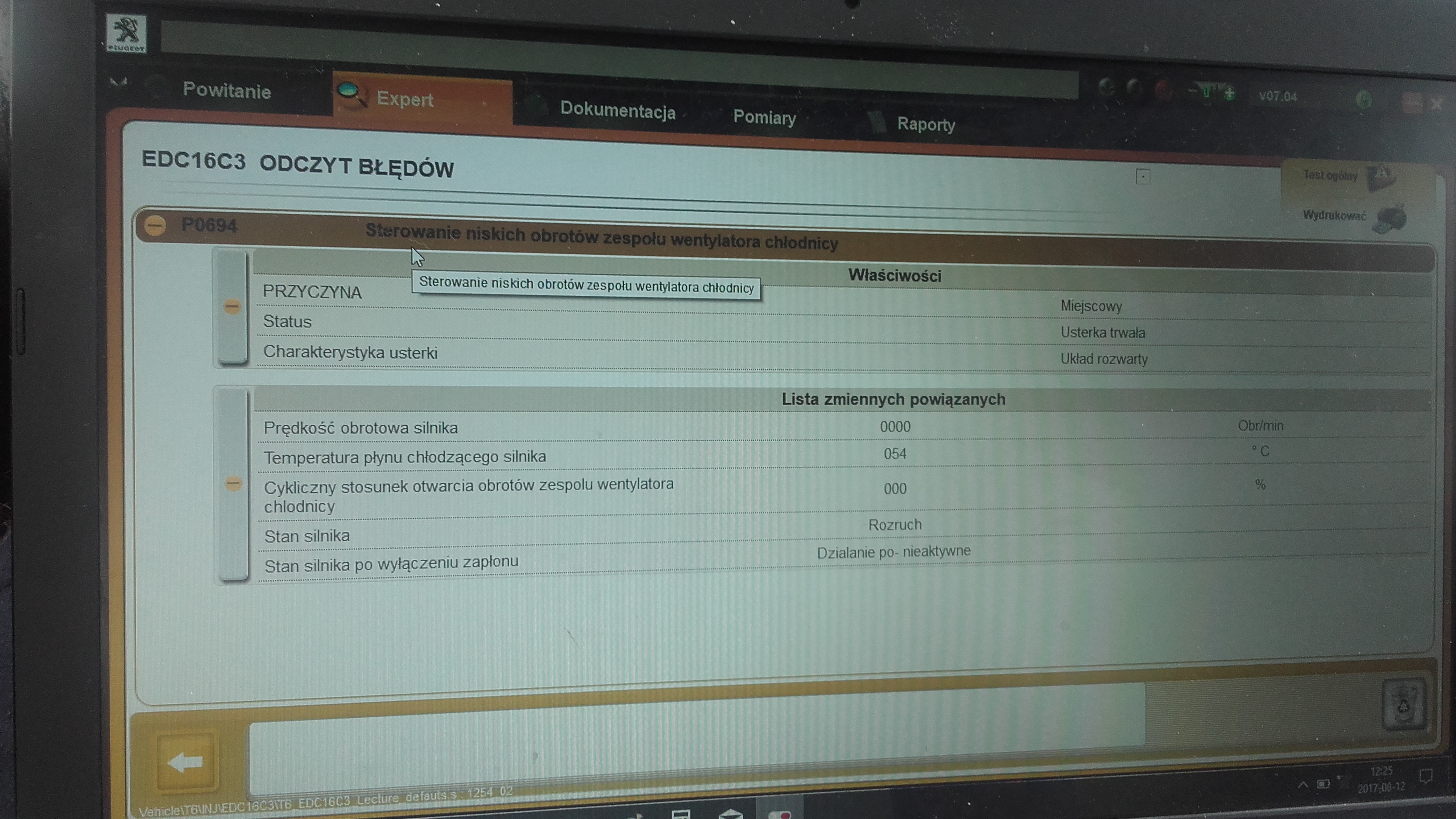

    Hello everyone, I have a problem with the car radiator fan: Peugeot 307 lift 2008 1.6 1.6 hdi 110. I do not work the first gear of the fan, i.e. after switching on the valve the second gear starts immediately, after connecting under Lex it shows the error of controlling the low speed of the fan P0694 when trying to force by interface first gear is nothing happens while the second gear starts without a problem. I dumped the old driver-fan resistor I installed a new one and then the same, this driver has two plugs one with thicker cables double the other with thinner cables quadruple, the second gear is still there and the first one is gone and the same error pops up. Please help !!!!

    I will connect lexie and check soon

    Give a description of the error and its context - show print screenshots.
    What is the engine code?
    What type of air conditioning.
    Disconnect the 4-pin plug at the fan controller.
    On the pin 3 of the controller socket, enter the plus and see if you give the weight for the pin 2, the first gear will appear and if you give the weight for the pin 1, the second gear will appear.
    Then you will know if everything is ok on the module and fan side.
    Give the fan module a picture.
    Which fan run starts after starting the car?
    If he doesn't see the engine temperature, he will start the fan just in case.

    Pokaxuje normal 36 and one more thing when I tried to clear the error, after the restart I started the engine without the air conditioning on and the fan did not start and as soon as I turned on the fan the fan starts at high speed and when I turn off the fan the fan goes on, the car lights up again and the fan starts again at high revolutions

    1.6 hdi 110 engine 2008 climatronik two-zone and as I wrote earlier I checked 12v on pin 3 and mass on 2 and the fan started in slow gear and this spiral next to the fan controller was heating up then I am sending a photo of the error

    The letter code of the engine is included in the VIN number, e.g. 9HY or 9HZ - this is for the future to show that there are several models of the engine with the same power and giving the same power does nothing too much.
    As for the pressure sensor, this information can be in the engine calculator because it is connected to the sensor and the engine calculator controls the fan and not the air conditioning controller ..
    If he sees too much pressure, he should turn on the fan to break it down.
    Since giving the weight to 2 pin you start the fan in the first gear, no signal from the engine calculator on the module.
    This is also said in the error - fault characteristics - the system is open.
    You have a wire break between the engine calculator and the module, or a broken calculator.
    Do it: disconnect the battery.
    On the injection calculator you have 3 plugs, from the left black 32-pin, middle 32-pin gray, right-hand 48-pin brown.
    Disconnect these plugs, connect the battery. Turn the ignition on and to the 32-pin black plug to pin D4 (cable number 1550Z) enter the weight.
    The fan should then start in first gear.
    If it starts, you have a faulty injection calculator, as it does not start, the broken wire between the injection calculator and the fan module.
    How to check this cable correctly using a light bulb: disconnect the battery, disconnect the left, black 32-pin plug on the engine calculator and the black 4-pin plug on the fan module. On the black 32-pin plug of the engine calculator, you give a plus on pin D4 (cable number 1550Z). To pin 2 of the black plug of the fan module (1550Z cable) you connect one of the poles of the bulb (e.g. 55W bulb), the other pole of the bulb is connected to ground and at this moment it is to light up.
    In short, the point is that the test cable should be used to power the bulb because the meter can be shown to be functional, but after connecting the bulb it will not light because there is a large voltage drop, e.g. on a connector or the cable stays on one thread.
    In French cars, one does not look at the colors of the wires, but their number, which are next to the plugs marked on the insulation of the wires.
    Very important note - do not disconnect or connect the injection calculator when the battery is connected. Do this only when the car has no power - disconnected battery.

    I did as you wrote but after unplugging the motor controller there is + 12v on the fan controller. I am surprised by one more reason why after starting the car the fan controller will switch to the second gear.

    Hello everyone, problem solved fan works in 1st gear and climate works and all thanks to a colleague GRALA1, this man knows what he is writing and really helps. The problem, as GRALA1 predicted, was the engine driver after replacing and coding everything works beautifully, by the way the coding engineer showed me an unscrewed controller and burned paths and some inefficient soldering, the trader apparently fumbled something before selling and made a short circuit and some solder soldered it to him and he car sold. Subject to close and thank you again colleague GRALA1
