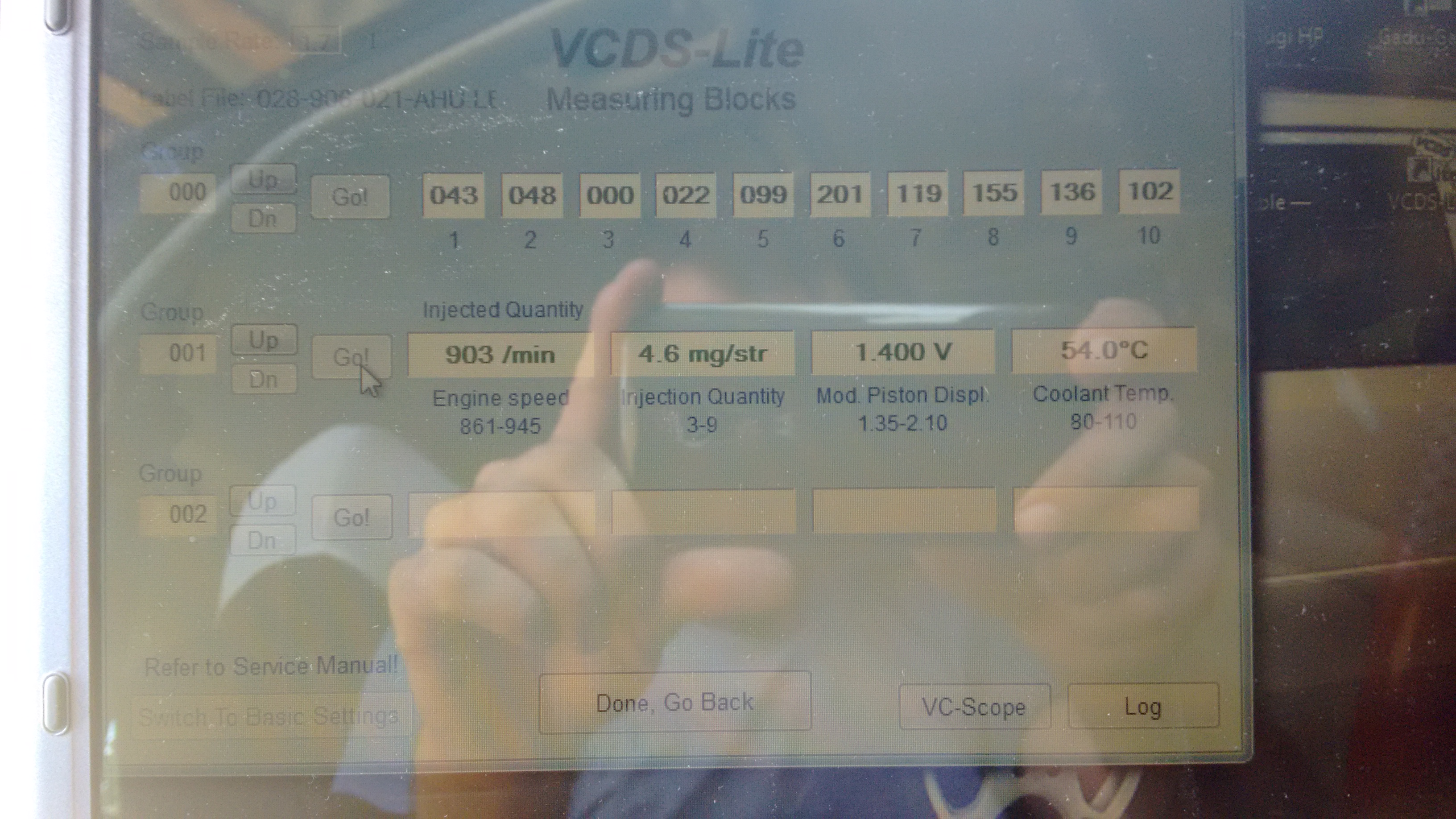

    Added after 3 [hours] 14 [minutes]:
    Oh, I forgot to add that after firing I plugged in the computer and the VCDS showed such errors
    vw golf 3 TDI 1Z - where there is a 50 A fuse and does not start

    The current on the shut-off valve goes from pin 53 of the engine controller. The errors that have occurred are related to the fact that I have not added privar on how to power this valve. The ignition should be switched on for a short time. I will add that turning on the glow plugs is giving the mass on the pin relay 50 engine driver.

    For those interested in the post, he writes that the reason for not firing was the ECU controller and for the advise of my friend sulof1601 I ran a short installation and the car is burning. I will be looking for an ECU driver calmly

    The problem was a module from the alarm cold soldering
