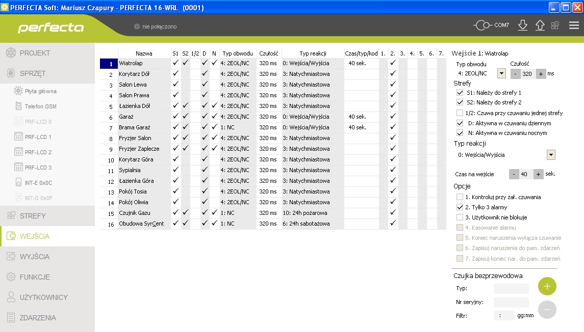

    I will use the thread and ask about a few issues that bother me. I am in the process of programming the first Perfecty and would like to take advantage of colleagues experience:
    1) I would like to set the Day Supervision (all zones active in armed mode) and Night Supervision (only some of the zones active in armed mode). I think I broke something with the Zones setting, because by pressing [Code] + Night or [Code] + Day on the keyboard, the keyboard always informs me about arming the Day Zone.
    Satel Perfect: Configuring Day/Night Supervision and Trigger Inputs Activation Satel Perfect: Configuring Day/Night Supervision and Trigger Inputs Activation
    I can't do it now, and I'll check it later, but it seems to me that on the Zone card I should uncheck the entire second row (2: Night), i.e. use only the first zone and set Day and Night mode in its area.
    On the Inputs tab, I should also deselect the S2 column, leaving only the D / N columns selected.
    2) Do I have to activate all trigger inputs on the Outputs tab, with those set as External Siren (for me 3 and 4), so that the siren will be triggered during an alarm?
    I will be grateful for your help - it will save me some time.

    ad 1. The key to success here will be to distinguish the zone from arming mode. If the manual misses, then this great article may be helpful: https://www.elektroda.pl/rtvforum/topic3344542.html
    ad 2. Well, yes. However, how much time it takes to mark one input and check if the appropriate output is triggered during the alarm.
