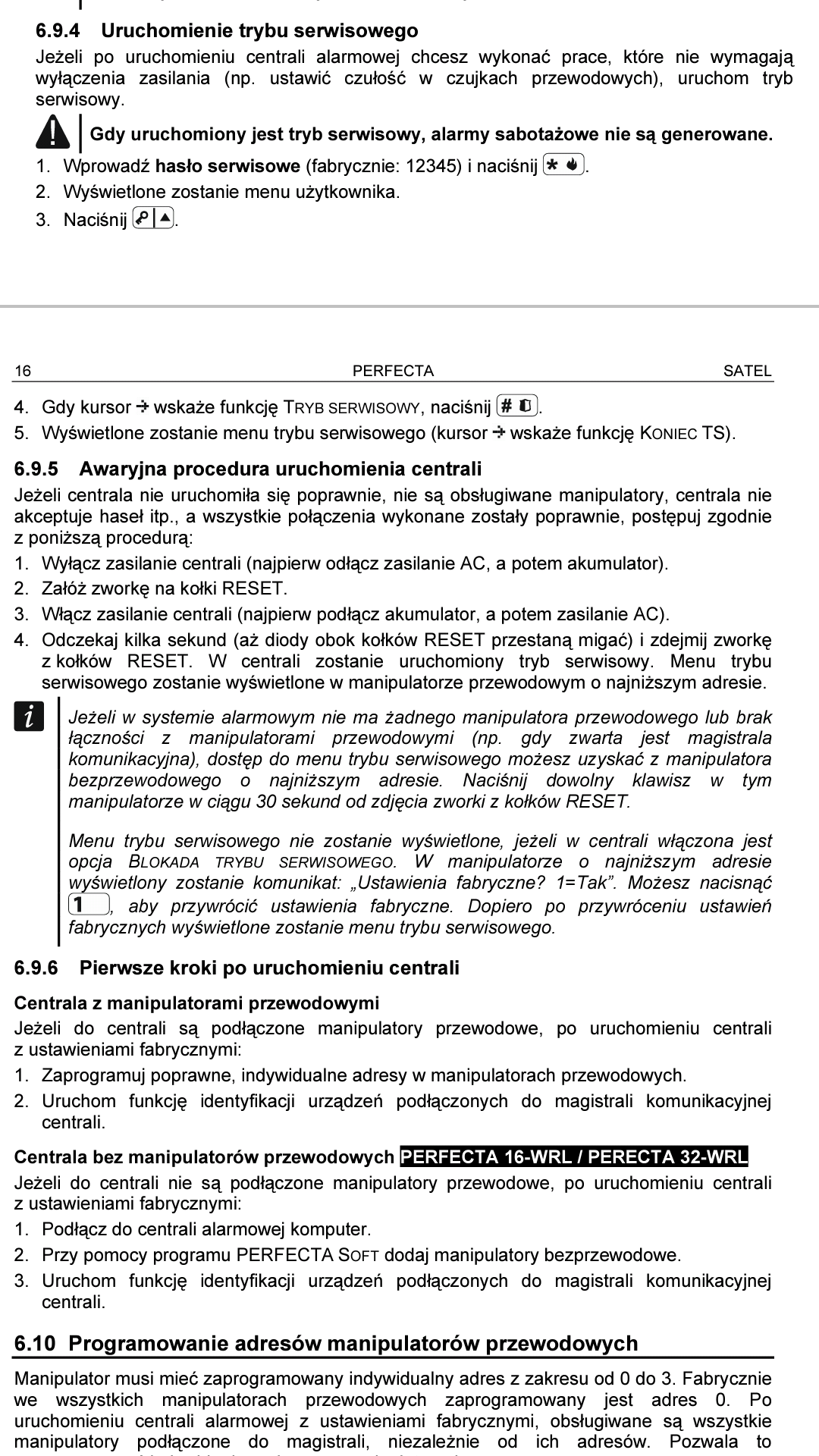

    Hello, I need to get to the detectors to enable the non-reaction to animals function. If I understand correctly, each opening of the detector will trigger a tamper alarm and to prevent this from happening, you must enter the service mode. Unfortunately, I do not know the service password (the factory 12345 does not work). I asked the installer, but there was silence, so I have to do it myself. The system is quite new, not even a year old. I found in the manual (and on the forum, but for other models) the procedure for emergency starting the control panel (1. turn off the power supply, then the battery 2. put on the RESET jumper 3. turn on the power supply 4. wait 10 seconds and remove the RESET jumper).
    I have a few questions about this (I have a wired LCD keypad):
    1. Will this procedure definitely set the system only to service mode and not return it to, for example, factory settings? (I wouldn`t want to program the entire system later)
    2. After the procedure, will the service password return to the factory default 12345? (how can I then change them to some of my own?)
    3. Will other passwords, e.g. users, be reset?
    4. How to exit the service mode?

    How to Enable Non-Reaction to Animals on Satel Perfecta Without Service Password
    1. Service mode only.
    2. It will be factory, the instructions describe how to change it.
    3. No.
    4. Read the manual☺

    #4 17480100
    niebieskipolo
    Posts: 703
    Help: 106
    Rate: 131
    Opening the control panel casing should trigger a tamper alarm anyway. I suggest a simpler way:
    - you open the switchboard
    - remove the fuse and disconnect the battery
    - you turn on the animals in the detectors
    - connect the battery, then the fuse
    - you close the switchboard
    - you clear the alarm, program the clock
    end.

    #6 17485064
    niebieskipolo
    Posts: 703
    Help: 106
    Rate: 131
    If I remember correctly, you won`t recognize the password, you can only change it to your own.

    #9 17486233
    sosarek
    Posts: 83875
    Help: 9320
    Rate: 15532
    gldfish wrote:
    the password must be reset and a new one entered
    In TS, you go to the service password options, enter yours, confirm and that`s it.

  • #10 17497557
    gldfish
    Posts: 57
    Rate: 22
    In accordance with the suggestions and instructions. Reset from the pins, i.e. after disconnecting the power supply for a moment, allows you to set a new service password. And once you know it, you can move the detectors to the PET position.
