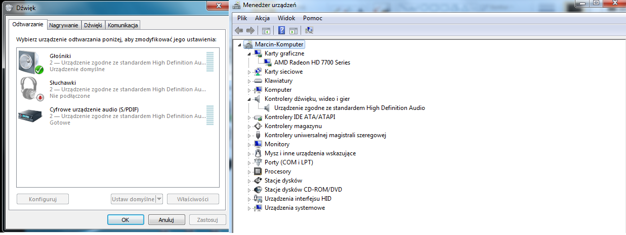

    Hi, I have a strange situation.
    Some time ago, the sound on TV (LG lf652v) via HDMI from PC worked for me.
    But I did graphics updates and suddenly ass did not work.
    The picture is normal, but there is no sound.
    On these rudders the drivers work fine:
    amd-catalyst-15.7.1-with-dotnet45-win7-64bit
    On these no longer:
    whql-win7-64bit-radeon-software-crimson-relive-17.7.2-july27
    + attachment, a photo from the Sound settings, I don't have a TV there at all and it is normal on the previous ones.
    Do you have any ideas ??

    What settings in Control Panel -> Sound?
    Select if not AMD HDMI Output.

    I wrote everything. And you have photos.
    I have an LG TV on these old drivers and I take a test and everything works. And these pictures are taken when I have these new drivers installed and it's completely dead.

    You do not have the drivers installed for your AMD high definition audio graphics card.

    So go back to the old driver or extract the AMD high definition audio driver from the old drivers (pick from the installer) and install it manually. It should work.

    You have the driver in the AMD directory on your system drive (if you haven't deleted it).

    I think I found it, but I think it forces Catalyst installations anyway.

    I found a folder, I tried to install it, but unfortunately it crashed an error that it cannot find the Crimision drivers.

    Ok, thx for any replies. I'm just removing the latest drivers and uploading the old ones. Subject to be closed.
