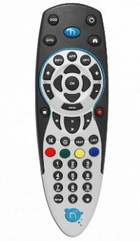

    biegan333 wrote:
    There is no volume control in this decoder.
    Hello. I have a set-top box with this remote control:
    No Sound from NC+ Multibox Decoder Connected to Panasonic TX 50CX680E TV via HDMI
    On its left side there are buttons for adjusting the volume.
    Older receivers had this remote control:
    Here, also on the left side, there are buttons for adjusting the volume. I'm thinking of the ones on the left next to the EPG, INFO. I suspect that you also have one of these pilots. If you have another remote control, please give the exact symbol of your set-top box so that I can help you. I was looking for a decoder as you gave multibox nc, but I found only mediabox, and I did not find multibox. Because there is one more option. While the remote control from the decoder has been programmed to operate Panasonic TV, the volume control of the NC + remote control changes the volume of the TV. Before programming, the volume was most likely not increased in the decoder. The only solution in this situation is to restore the remote control to its initial state, increase the volume of the decoder and re-program it to work with the TV. Good luck.
  • #5 15231442
    biegan333
    Posts: 17
    Rate: 17
    the decoder is called Sagemcom's wifibox without any additional disk. Sorry for the wrong bearing.

    Welcome back. The volume control is also on this remote.
    These two buttons are highlighted in blue. No Sound from NC+ Multibox Decoder Connected to Panasonic TX 50CX680E TV via HDMI
