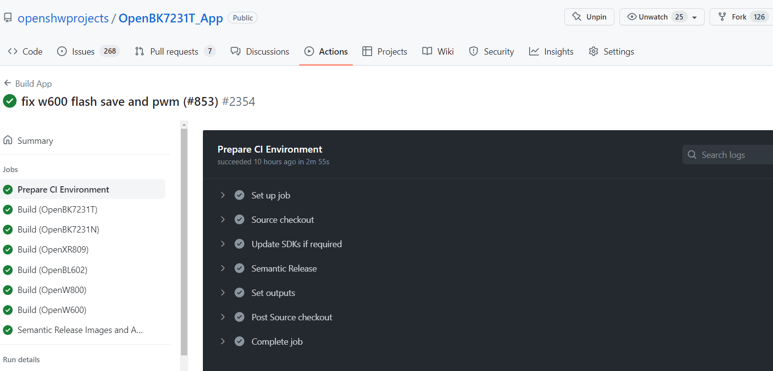

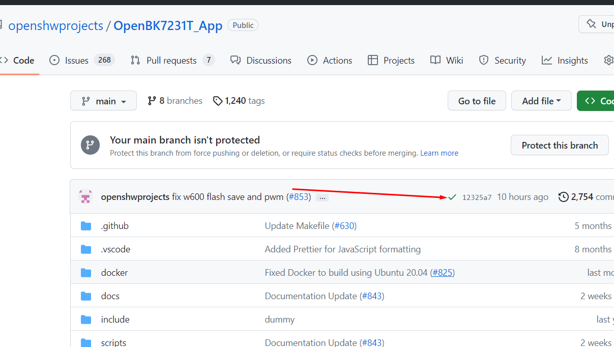

    You need to fork OpenBeken main app repository and then when you commit, you get a mark here:
    OpenBeken + WB2S + A4988, how to control it using smart switch?

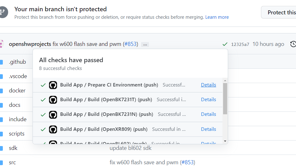

    you click that mark and get that:
    click details now, and you will see:

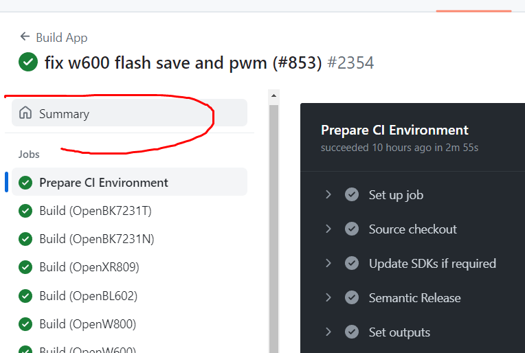

    then click summary:
    and then scroll down:
    if you download that "artifacts" 12.4MB file, you will get binaries for all platforms for that commit
