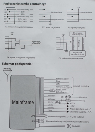

    I have Cartprotect BX40 in my car, something fell and I bought the same version of BX40 only slightly different. Old version:
    CARPROTECT BX40 New vs Old Version: Connecting Turn Signals to Brown Cable
    New version:
    Everything fits but I don't know how to connect the turn signals or both to one brown cable?

    Both indicators are under the brown wire, but they must be separated by LEDs.

    And with the old alarm you didn't have LEDs? According to the diagram, they should even be paired with fuses.

    Connect the two blue wires together and attach them to the brown wire of the new switchboard.
    The old switchboard already has diodes and fuses - at least in the diagram.
    How the installer made the connection - nobody knows.

    Thank you, gentlemen, two LEDs are insulated with heat shrink sleeves next to the fuses. I get to work.
