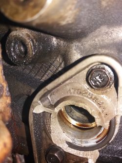

    Concord2001 what have you changed in the tensioner?
    Yesterday, while driving, the tensioner popped out of the engine block. It made a nice hole and it got messed up. No idea what was the reason. Vibrations? Weakening of the casting? What do you think?

    There had to be something wrong with the tensioner - it might have been jammed completely. Even when inflated it gently cushions. Something could also have happened along the route of the chain, e.g. something fell between the chain and the sprocket and tightened the chain tightly, causing the tensioner to be pushed out. I feel sorry.

    Exactly a year ago, I replaced the complete timing (chains, wheels, tensioner). The car did 10,000 km and you have it! It is possible that the element was already cracked? This casting looks quite strange. There is relatively little pure metal in the fracture of the casting, and the material itself is aluminum.
    Could the reason be wrong tightening? Or maybe a material defect?
