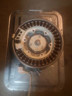

    I am thinking more and more about the use of the washing machine motor, the so-called "direct drive"
    After proper rewinding, it should have a fairly specific power

    As I considered in the post above, I finally tried to get a washing machine motor. Puki looks promising, after rewinding I will let you know about the effects.

    The next day - rewinding
    7x1mm after 11th thread
    Paws hurt already, but I hope the results will be good :)

  • #60 18951000
    LemuRR 11
    Level 26  
    Posts: 1510
    Help: 37
    Rate: 447
    This is a so-called "direct drive" or "smart drive" (depending on the manufacturer.
    They will drive the drum directly.
    Unfortunately, the factory winding turned out to be made of aluminum, so I skipped the configuration of the factory winding.
