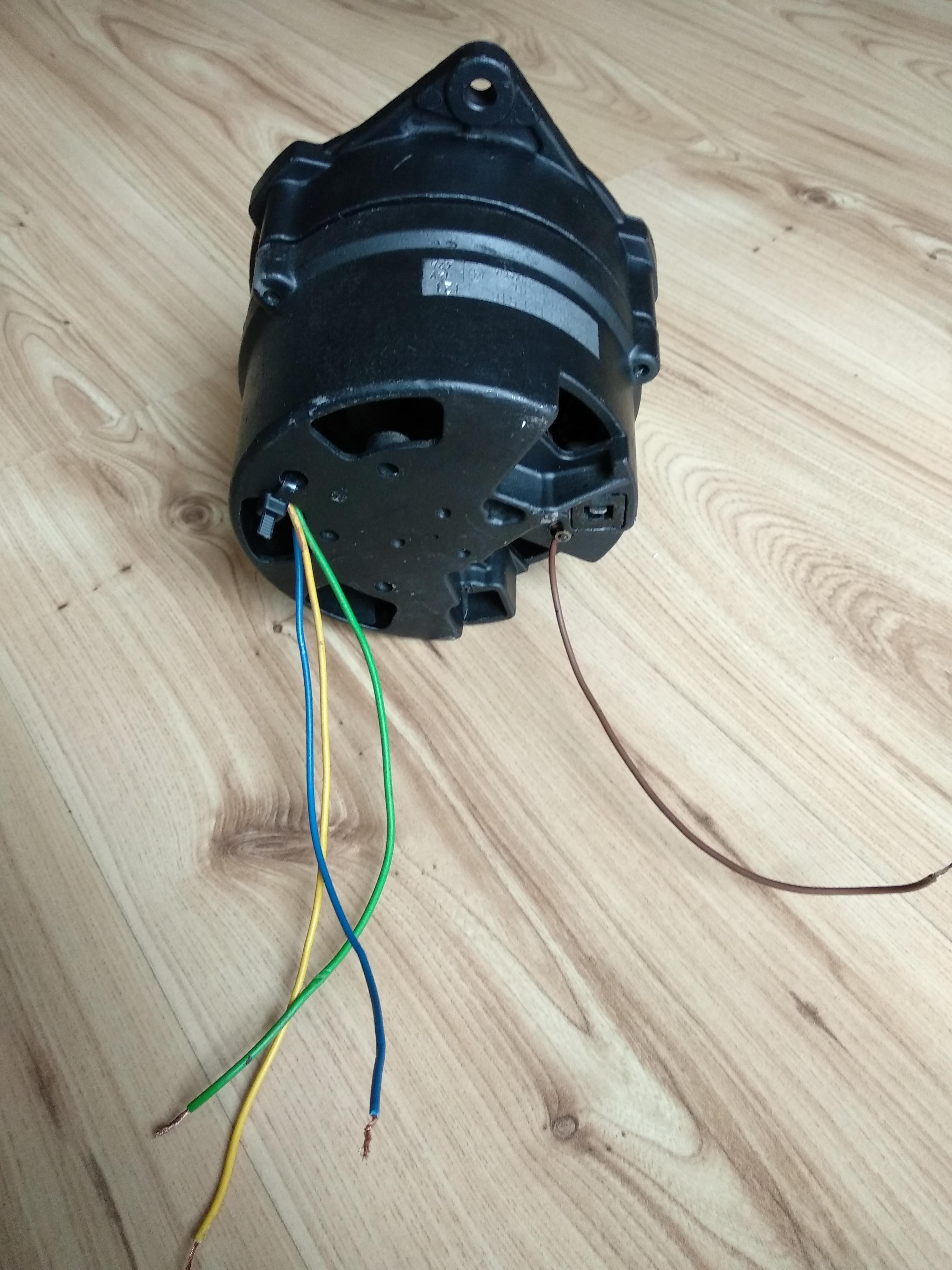

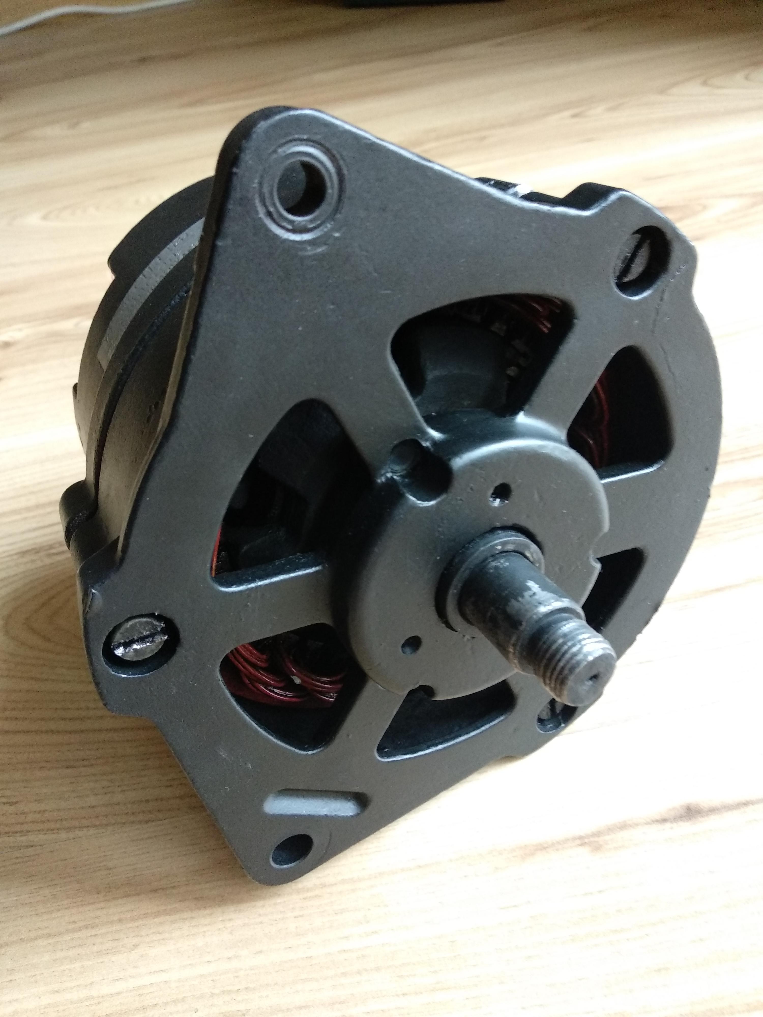

    Hello! Recently I was able to run the alternator as an engine and it works surprisingly well. The alternator only needs a minor modification (you need to remove the rectifier and lead the cables from the phases to the outside) I power it with a Chinese 48v 350w e bike driver, additionally 12v given to the rotor brushes.
    I include a link to buy the driver if someone is interested:
    https://en.aliexpress.com/item/OOTDTY-Alumini...rushless-DC-Motor-Controller/32841355316.html
    In the attachment there is a photo of the converted alternator (I cleaned and painted it to make it look nice :D ).

  • #5 17788837
    jestemgrafikiem
    Hi,
    Forgive me for the excavation, but I am interested specifically in how you connected the controller to the alternator?
    Did you use exactly the same wires as in the controller (blue, yellow, green)?
    What about the other cables (except for the controller power supply)?
    Greetings
  • #6 17789345
    Mnster
    Posts: 80
    Rate: 14
    jestemgrafikiem wrote:
    Hi,
    Greetings
    After removing the rectifier module from the alternator, I connected the 3 outgoing winding wires with the wires from the controller (blue, green, yellow). In addition, you need to connect the appropriate speed control handle to the controller. You should also pay attention to whether the controller can work in sensorless mode (without hall sensors), in my description it says that it does not work without sensors, but in practice there is no problem with it. with "+" power to turn on the controller.

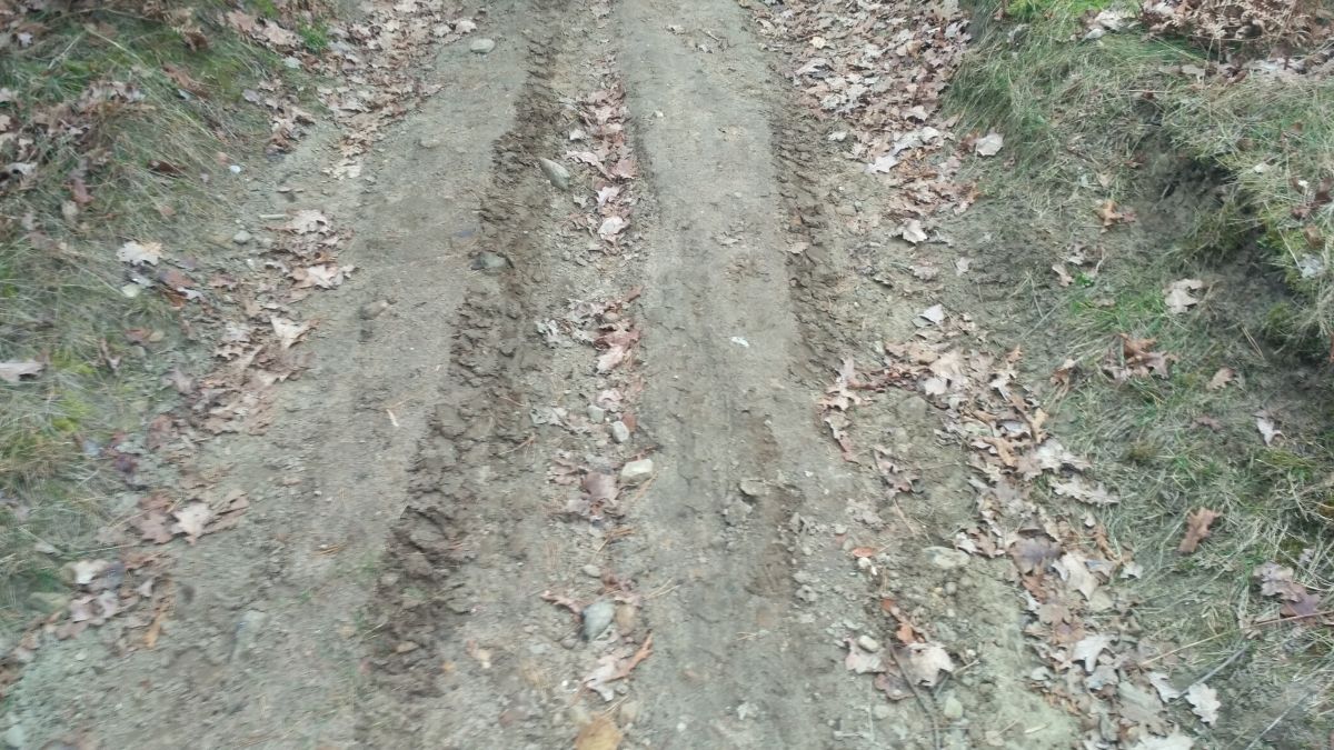

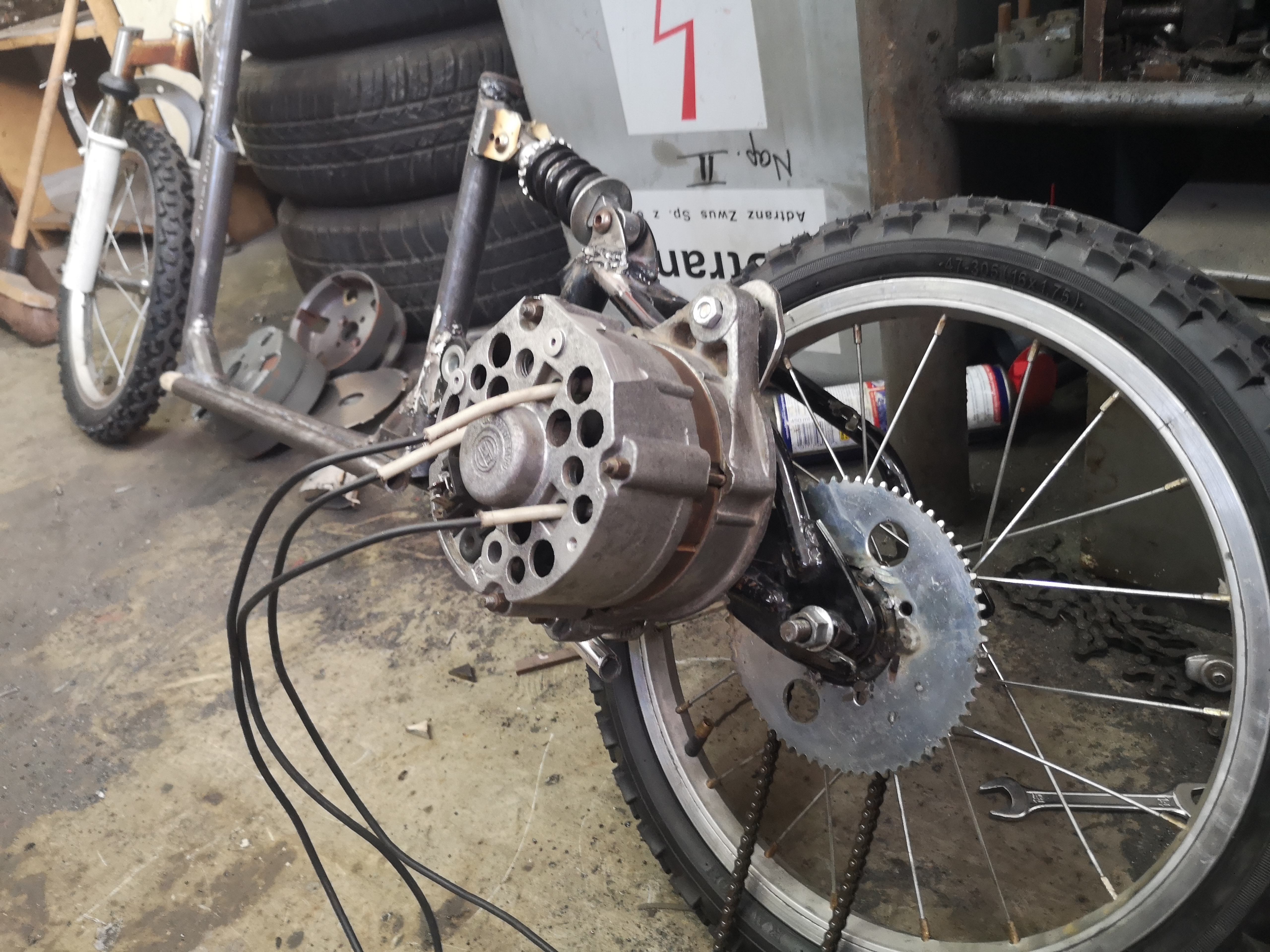

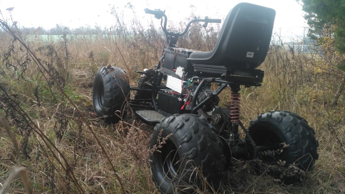

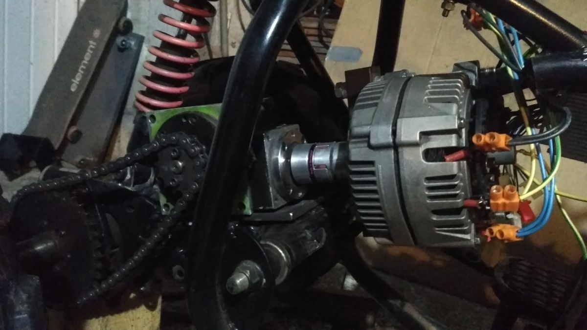

  • #17 18311354
    Witch44
    Posts: 13

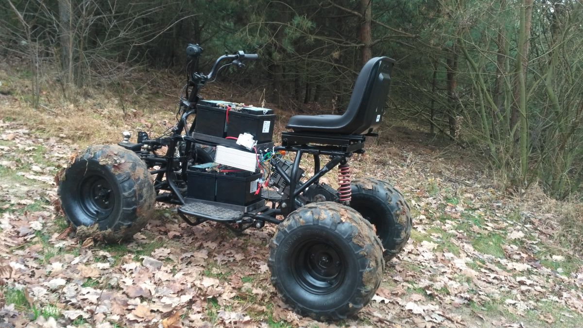

    By connecting to the topic, I was able to try the alternator as an engine to drive the quad bike. Surprisingly, it turned out great.
    -Quad ATV 150
    -Alternator Valeo 150A (only the regulator cut off, without interfering with the connection of the stator windings, Hall sensors - there was no need, very smooth operation)
    -Chinese driver 48-72v 1500W (momentary 2200W)
    -Common 44 Ah car batteries
    - Excitation of the rotor, optional 1-2A (bulbs from the car are ideal, in both cases there is no problem with starting even under load)
    - 1:40 gear
     Car Alternator as High-Power 12-36V BLDC Motor - Affordable Driver Selection & Assembly

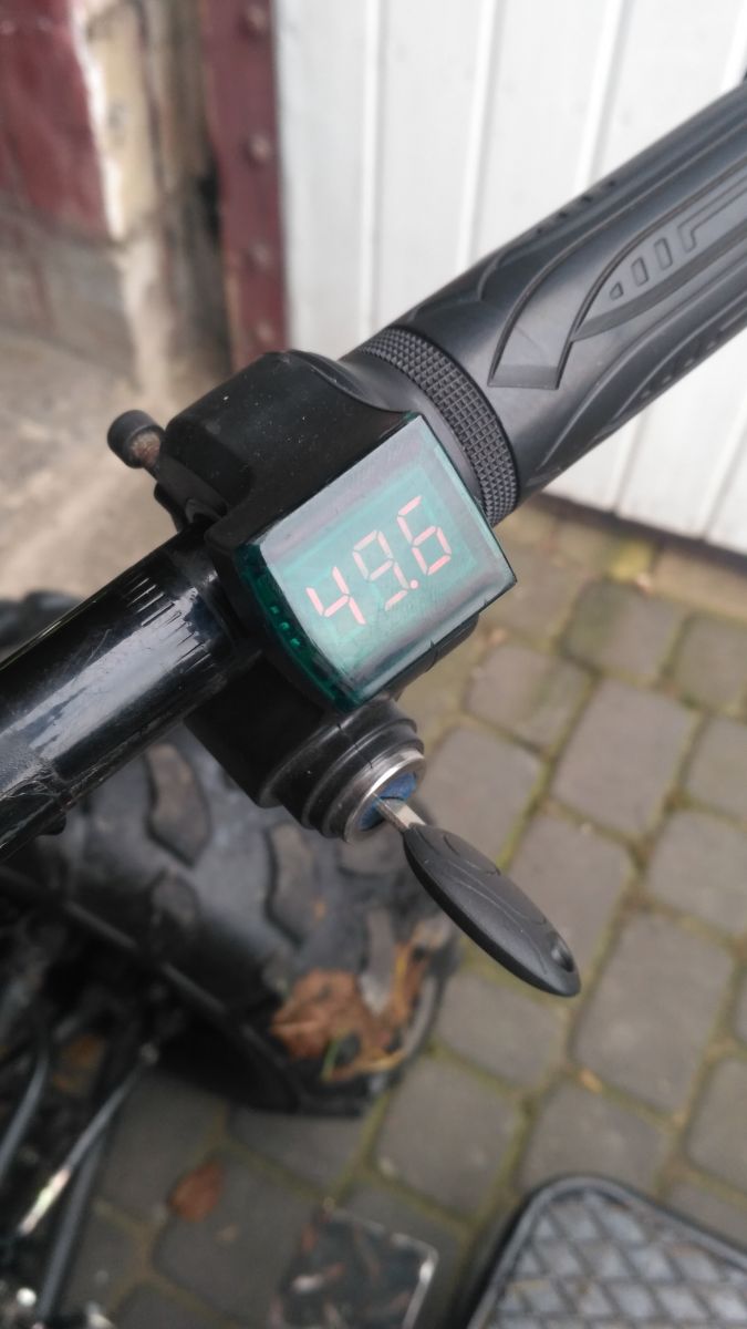

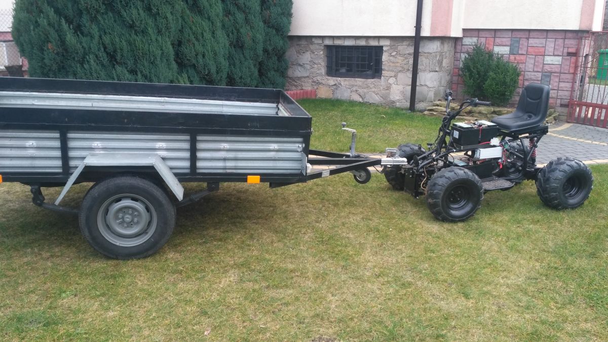

  • #18 18312766
    Witch44
    Posts: 13
     Car Alternator as High-Power 12-36V BLDC Motor - Affordable Driver Selection & Assembly  Car Alternator as High-Power 12-36V BLDC Motor - Affordable Driver Selection & Assembly  Car Alternator as High-Power 12-36V BLDC Motor - Affordable Driver Selection & Assembly  Car Alternator as High-Power 12-36V BLDC Motor - Affordable Driver Selection & Assembly
    After 51V charging. After 40 minutes of playing in the field and pulling a 49V trailer.
    Warm engine, not hot. Time to put it together nicely.

    Witch44 wrote:
    After 40 minutes of playing in the field and pulling the trailer
    Judging by the setting of the seat - pushing ...
  • #20 18313300
    Witch44
    Posts: 13
    the vehicle moves in both directions :wink:
    the rear hitch is still drying  Car Alternator as High-Power 12-36V BLDC Motor - Affordable Driver Selection & Assembly

    How about the idle current in your case? For me, unfortunately, the alternator from FSO turned out to be a weak link. Pretty warm. And the no-load current is much too high (10A)
  • #23 18315626
    Witch44
    Posts: 13
    rdt- I gave up the wheel tightened with a screw. I sanded the spline on the rotor axis. I touched the axis overlapping the rotor axis with the defects in the form of the nut thread and filled with metal filler. I tightened the whole thing from the forehead with a screw.
    Effect - trying to shorten the axis, there was no chance of breaking both elements in half. On the newly created axle, another groove, this time for a steel wedge and an aluminum clutch.
    LemuRR 11- no-load current 2A + 2A excitation. Browsing through dozens of posts on various pages, I have noticed a frequently discussed topic of iron supersaturation used to build the Stojan, there is something to it. At the moment my driver is set to 70% power. earlier, at 100-120%, actually at 3-4 amps of excitation, the motor was able to suddenly "jump into the resistance", drastically increasing the power consumption and reducing the revolutions. The temperature then rises quickly. Only reducing the excitation current helped.
    One thing is interesting, namely the gear ratio. It can be crucial. if it is too small, the alternator is very electricity-consuming, like any other engine that will be heavily loaded. My 1:40 may be too exaggerated. Altek makes a sound like a nice speeding turbine, but even leaning against the wall, grinding the wheels I cannot exceed 30 amps (the system has a 30A ammeter). Off-road driving (photos above), maximum consumption about 12A. The driver can give 50A, which it will never achieve because my current protection ends at 32A. The alternator from the Iveco 28V 90A truck will soon be tested. I wonder if there will be any difference :wink:

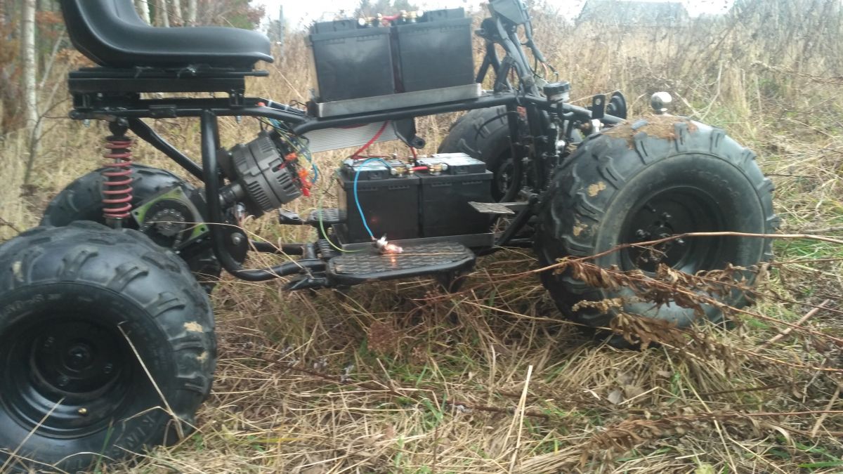

    Further tests. One and a half hours this time. The engine felt hot to me, but it turned out otherwise.  Car Alternator as High-Power 12-36V BLDC Motor - Affordable Driver Selection & Assembly
    By the way, the question, namely the problem with excitation. At the moment, the rotor is still powered from 12V in series with the H4 bulb, current 2A.
    Ultimately, I would like to supply the rotor with 48V and somehow I can't find a solution here. While the bulb connected in series at 12V works well, at 48V 4 bulbs connected in series give too much current. This is still 2A, and I think it should be 0.5A at this voltage to do the same job. I tried voltage-reducing converters, but these simply in the world either get stupid or die after a while. I tried to filter the current at the output before the rotor, but to no avail. Any ideas?  Car Alternator as High-Power 12-36V BLDC Motor - Affordable Driver Selection & Assembly  Car Alternator as High-Power 12-36V BLDC Motor - Affordable Driver Selection & Assembly

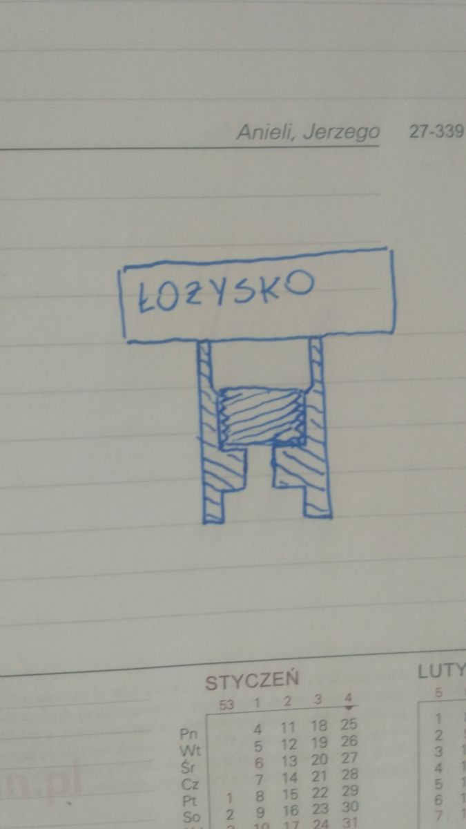

    Rdt- I did not take pictures of the axles, when I come back from work I will try to make an overview drawing

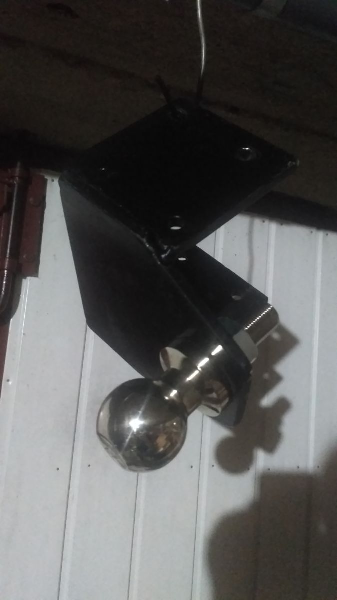

  • #29 18333092
    Witch44
    Posts: 13
    rdt- I hope the drawing is quite legible. Lots of work before Christmas and no time at all. It remains to pick after the night :crazyeyes:  Car Alternator as High-Power 12-36V BLDC Motor - Affordable Driver Selection & Assembly
    Axis section.

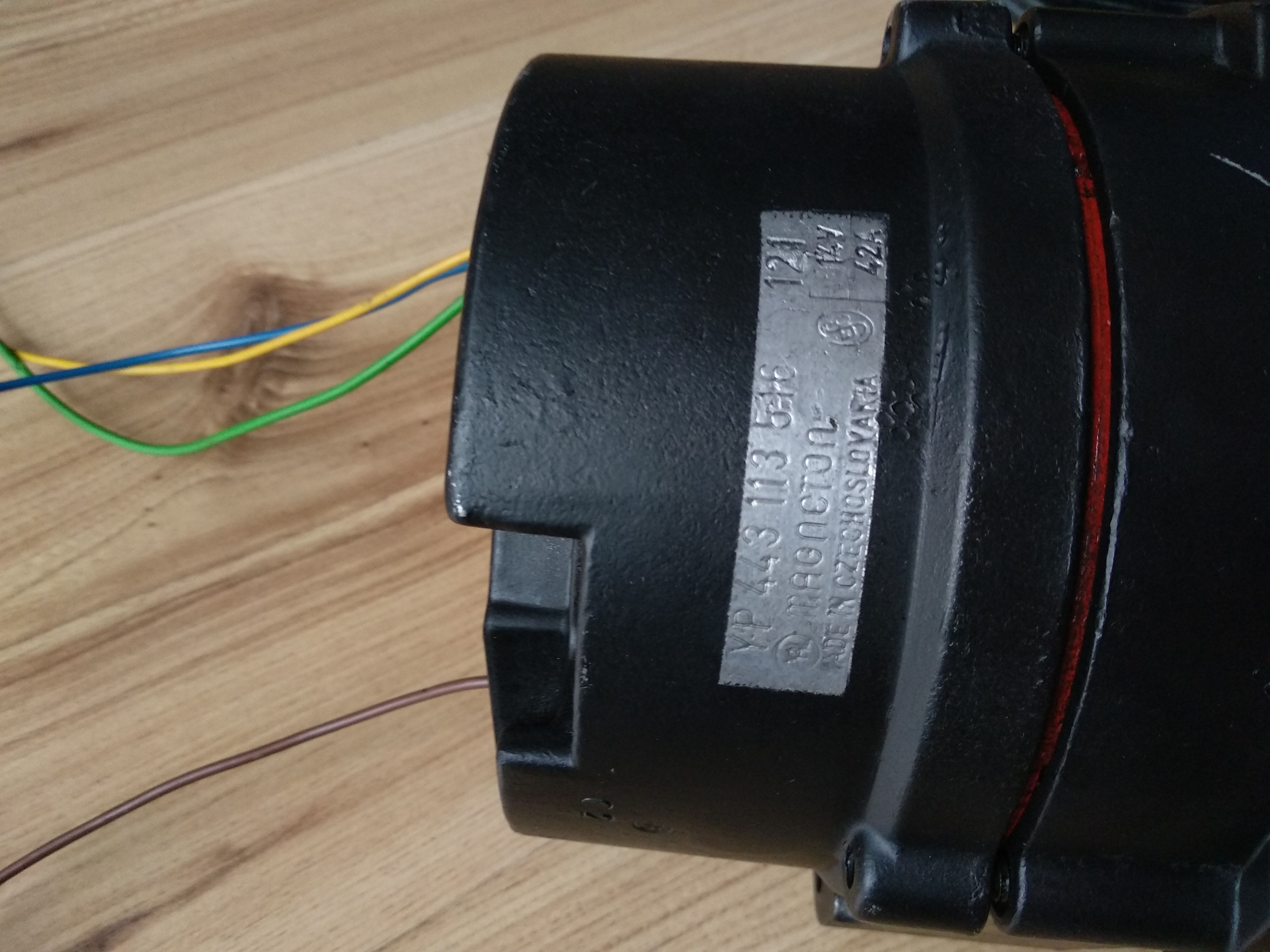

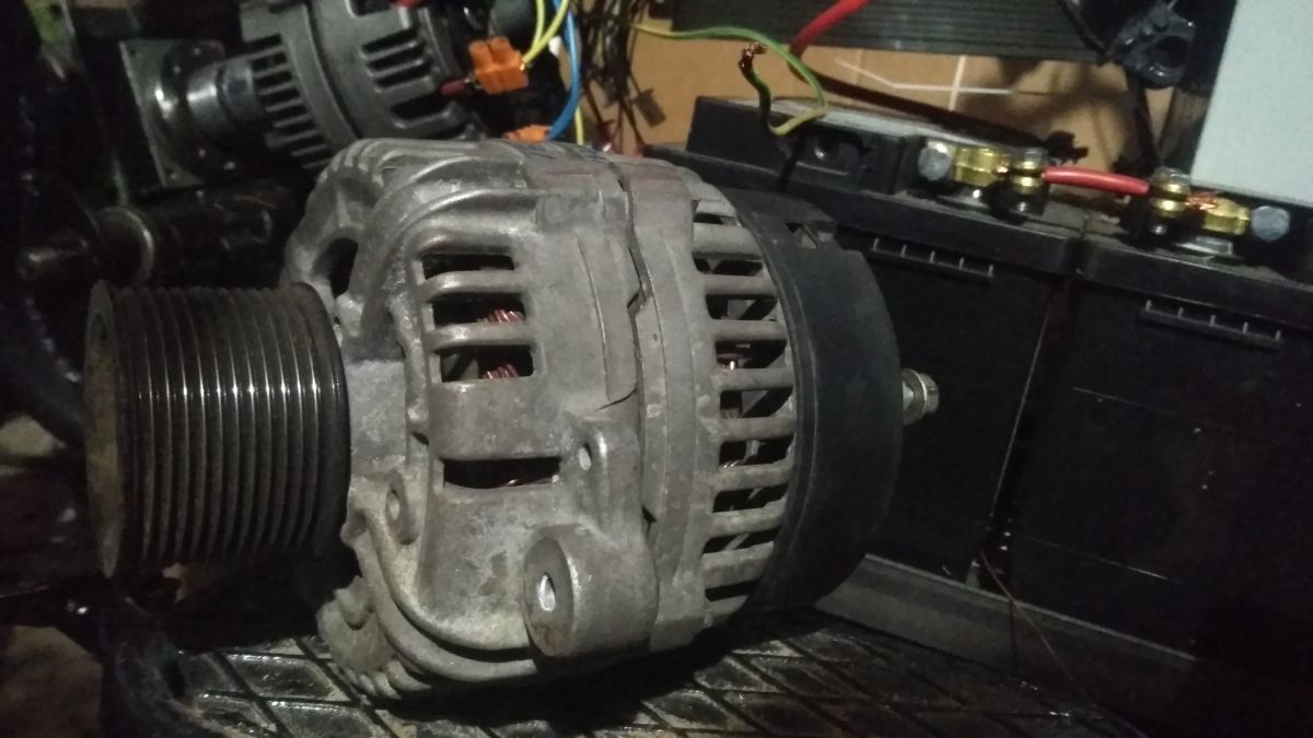

    An alternator from IVECO came. Time for a comparison :D  Car Alternator as High-Power 12-36V BLDC Motor - Affordable Driver Selection & Assembly

  1. Remove diode bridge and voltage regulator.
  2. Solder phase windings for star or delta as needed.
  3. Lead three equal wires (often blue-yellow-green) to the controller [Elektroda, Mnster, post #17789345] Optional: convert star to delta or series-link double windings to match higher bus voltages [Elektroda, Witch44, post #18359775]
