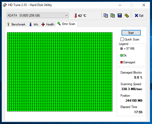

    In January this year, I was assembling my brother's computer. Everything was fine, the system stood up literally immediately. With time, it happened to him that Windows started up for a long time. From an indefinite time, Windows 10 starts (i.e. the time of the Windows startup animation, as soon as the Windows logo appears on the login screen) more than 4 minutes.
    Computer Specification:
    System: Windows 10 ver. 1803
    Graphics: Nvidia GeForce GTX 1050 Ti
    Processor: AMD Ryzen 3 1200
    Motherboard: Gigabyte GA-A320M-S2H
    RAM: IR-X3000D464L DDR4 8GB 24000 DIMM
    SSD drive (for system and games): ADATA SU800 256GB
    HDD (data storage): Segate Barracuda 250GB ST3250410AS
    As I mentioned, the system startup time is over 4 minutes. I have no idea what could be the reason anymore. I updated motherboard drivers, scanned both drives, registry cleaned regularly. Both drives in good condition. Someone may complain that when the system starts up, a lot of applications are launched - well, no, I turned off everything unnecessary - still to no avail.
    I would not like to rebuild Windows because there are a lot of games on the disk that weigh quite a lot. Perhaps there is a solution that I simply overlooked in the world.
    UEFI also seems to be fine, AHCI is set. I tried to re-plug SATA ports, also to no avail.
    Anyone have an idea why the system startup could be so long? I would understand if it was 15-20 seconds but not 4 minutes on an SSD which is in very good shape.

    and did you check the sdd if it has errors?

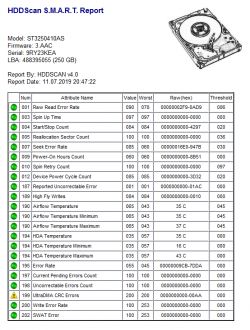

    From hour to hour, the system started to fire up properly - it didn't even take 7-8 seconds from pressing the firing button to the login screen. In any case, after restarting the computer, the same situation is back.
    In general, I've also noticed that long booting occurs mainly after restarting or rebooting the computer. Long system startup when first turning on the computer occurs sporadically, but it is not a normal situation.
    Below I am inserting the Windows event viewer - these are the only errors that appear after opening the system for such a long time, but from what I noticed, in the event viewer, they also occur during the system operation.
    I uninstalled the antivirus - to no avail.
    I also tried to restart the computer with a clean boot via the System Configuration panel. In the general tab I unchecked 'Load startup items', in the Boot tab I checked 'Safe boot' with the 'Minimal' option. In the services tab, I turned off all services not related to Microsoft. Without any results.
    I reinstalled the chipset drivers - no changes.
    I have no way to restore the system because there is no restore point that I could use in this situation.
    I ran chkdsk without showing any errors.
    At the moment I am unable to update the disk's firmware.

    Scanning the disk for errors.
    Windows 10 Slow Boot Time on SSD: GTX 1050 Ti, AMD Ryzen 3, Gigabyte Motherboard Issue?
    SMART disk.
