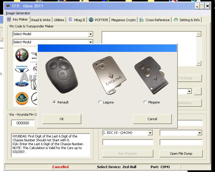

    I have a problem with Renault Trafic II 2006, namely the central locking remote control does not work in the new key.
    From the beginning:
    I bought a used key for this car, changed PCF7946 to a new one, milled the tip, programmed it with the OPCom by Vivaro.
    The car starts on both keys but the remote control works only on the old one.
    The driver sees that there are 2 keys with RF.
    My question: how to run this second remote control?

    And pcf was precoded? If not, it will only fire.

    If the transponder is separate it has no connection but if, like soldered here, the remote control enters with the immo. Not all used remotes work in another car. You need to clean.

    PCF 7946 supports the remote control and for this you need to do it the initial configuration (precoding). If it has already been programmed for the car then it remains to be replaced with a new one because this one is already blocked.

    It remains for him to clean-reset, there is a special programmer PCF79XX prog or PCF replacement again, a precode and re-uploading.

    ok thanks a lot for the answers. I bought a new precoded transponder and it worked the first time.
