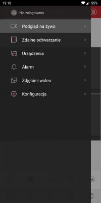

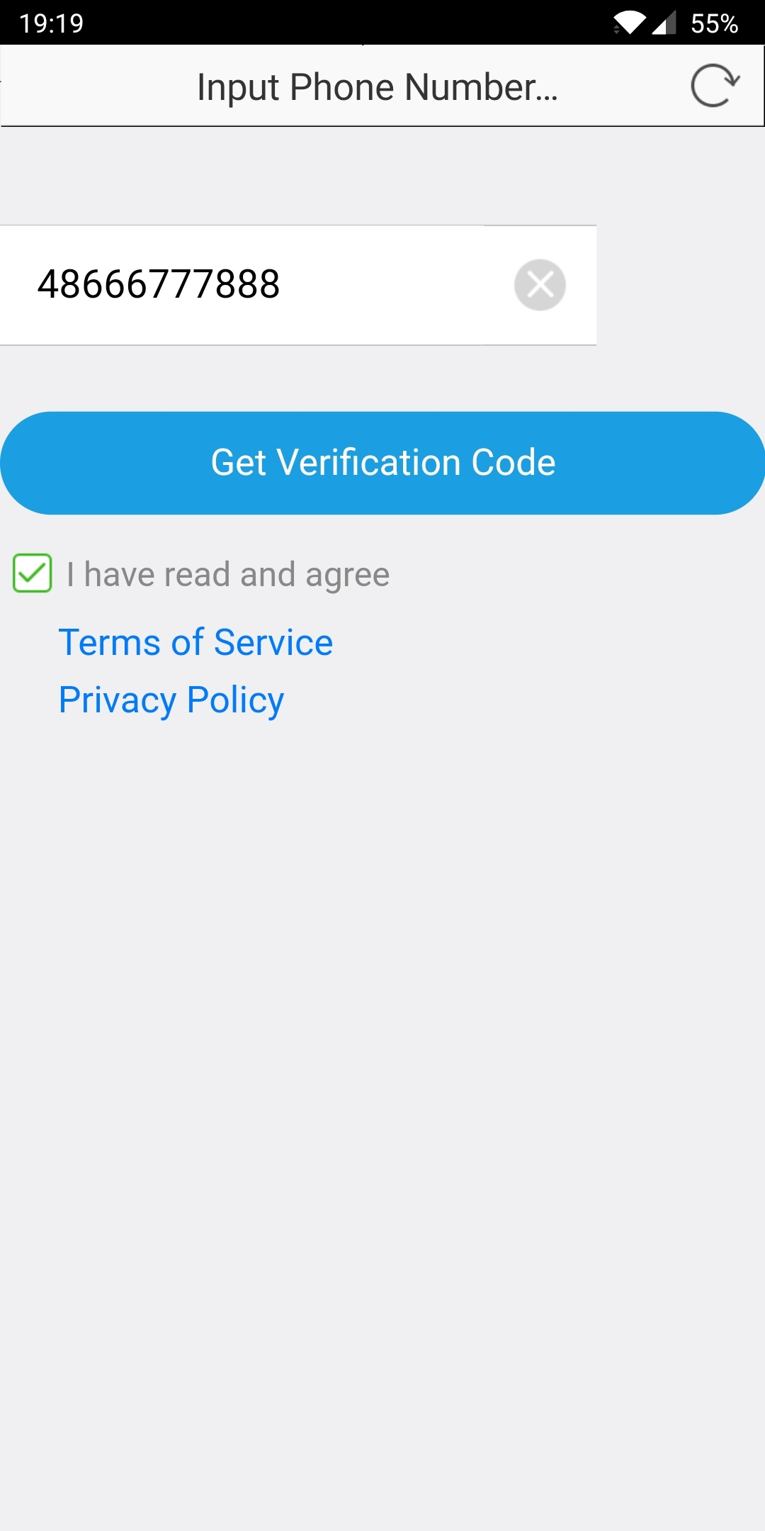

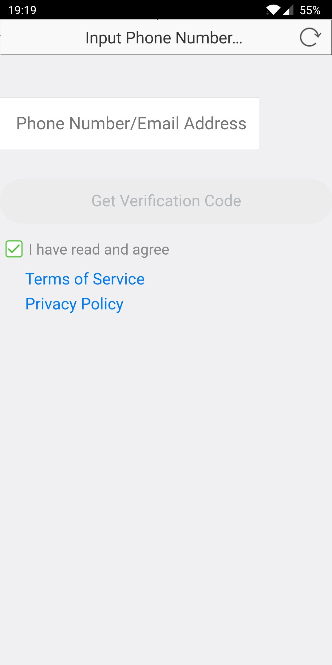

    then download the iVMS-4500, Hik-Connect or HiLookVision app from the Play/AppStore (the latest app with the least viewing issues) or directly from the appstore.hikvision.com and hikvision.com . and create our new smartphone account.
    Here, the email address or phone number (necessarily with +48 (in iVMS-4500) at the beginning of the mobile number), which we have access to at the moment (this is required to enter the code received on the aforementioned email or number). If it is not possible to register in the first application, we register in the second application - finally on iVMS-4500 and Hik-Connect we will have a preview.
    Hikvision Remote Access: Cloud Configuration for Cameras Worldwide (No Public IP/Router/DDNS) Hikvision Remote Access: Cloud Configuration for Cameras Worldwide (No Public IP/Router/DDNS) Hikvision Remote Access: Cloud Configuration for Cameras Worldwide (No Public IP/Router/DDNS) Hikvision Remote Access: Cloud Configuration for Cameras Worldwide (No Public IP/Router/DDNS) Hikvision Remote Access: Cloud Configuration for Cameras Worldwide (No Public IP/Router/DDNS) Hikvision Remote Access: Cloud Configuration for Cameras Worldwide (No Public IP/Router/DDNS)

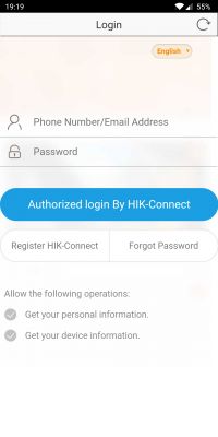

    Log in to the previously created account and add our DVR by scanning the QR code or manually entering the serial number in the format e.g. "C12345678". C12345678 (this is 9 characters i.e. letters/digits). An example serial number here is DS-7216HQHI-F2-N-A0820161104CCWR C12345678 WCVU

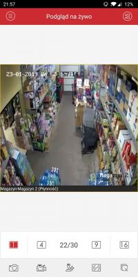

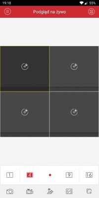

    After the data is entered correctly, we are shown such a window (in my case it is 16 analogue cameras + 2 IP, so 18 channels in total):
    If we have selected the option with "VERIFICATION CODE", the first time we start the live view, a window for entering the pre-set code (ASD789) appears. After entering it, we have a fully configured preview and we can now, from anywhere in the world, check what is happening in our absence in our company, house or on the plot.

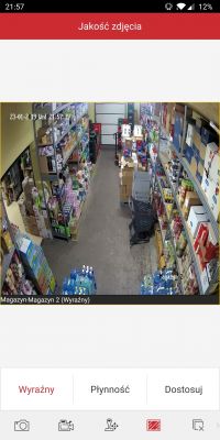

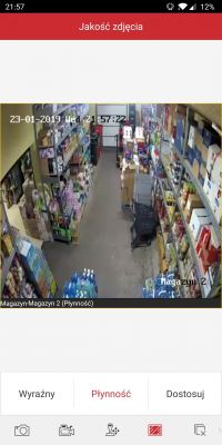

    The quality of the reproduced image in the application, by default, is limited to a smooth display of the observed area. To change this, hover over the icon highlighted in red from the bottom drop-down bar and switch to the "EXPRESS" mode. However, it must be taken into account that such a switch may delay the online preview and the image may start to cut out. Changes made on the phone do not affect the recorded image on the DVR.
    Because of this,
    Because of the fact that it is a preview via the so-called cloud, you have to reckon with the fact that not always our preview will work perfectly (no connection, cropping of the image, loaded network in the evening hours, etc.).

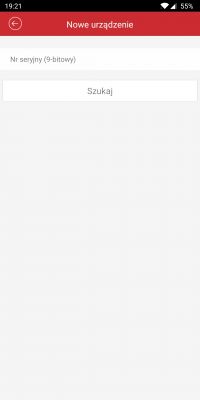

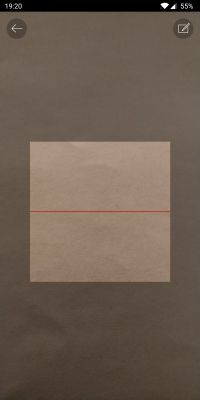

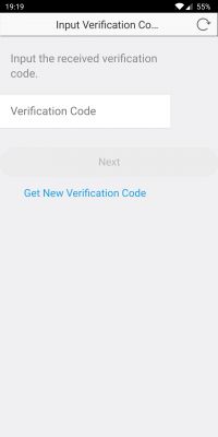

    I'm having trouble launching Cloud Preview. Zetaw is on the table: Recorder HWN-4208MH connected to PoE Switch, Camera HWI-B640H-Z connected to PoE Switch. A PoE Switch connected to the Router from T-Mobile, Huwaei B525s-23a. In addition, a VGA monitor connected to the Recorder as part of the preview. And of course the mouse.
    I tried to add the recorder to the cloud in three ways:
    1. Via the iVMS-4500 mobile application
    In the mobile application, I log in to my HIK-Connect cloud account. I am logged in. In my account, I press "+" to add the recorder to the cloud. I scan the QR code of the recorder (the one in the "Access to the platform" tab ;) . The application finds the model (HWN-4208MH) and the recorder number (XXXXXXXXX). I press the "+" next to the found recorder. The app asks you to enter a verification code. It gives the simple and correct code "123456". I press "confirm". The application says "Adding device failed"
    Tried to do this from another smartphone and same result.
    Sweeping the scan of the number code, it tries to enter the serial number of the recorder manually. I type "XXXXXXXXX" (one letter 8 digits). I click "search". The application finds the correct recorder with the correct serial number. I press the "+" next to the found recorder. The app asks you to enter a verification code. It gives the simple and correct code "123456". I press "confirm". The application says "Adding device failed"
    I tried the above two methods from a different smartphone and unfortunately the same result.
    2. Through the iVMS-4200 program installed on my laptop.
    I am already logged in to the cloud. In the "CloudP2P Urzad" tab, he adds a recorder. I enter the serial number and the verification code in the box. The system throws the message: "Adding Failed XXXXXXXXX, OpenSDK Error Code [302009]. Device response timeout. "
    I did the above method on another laptop with the same effect.
    3 Via the website https://euauth.hik-connect.com on my laptop
    He logs on to the website https://euauth.hik-connect.com. Adds the serial number and verification code, and the system responds with the message: "Device response timed out. Please check the network. "
    I did the above on another laptop with the same effect.
    There seems to be no exit from the WiFi router (T-Mobile LTE). Home Internet 20Mbs per "city", nor can anyone from the "city" get to the recorder to verify the correctness of the verification code, for example.
    Preview on the VGA monitor connected to the recorder is OK. Preview from the laptop via iVMS-4200 is also available, but only when the laptop uses the same LAN network to which the Recorder is connected. There is no preview through iVMS on the laptop when it connects to another network (from a friend from home). In short, the preview is only local, not from the outside.
    The service is enabled in Settings> Network> Platform Access, the access type is HIK-Connect, the server address is dev.eu.hik-connect.com, the verification code is "123456", the status is "online".
    What to do, gentlemen, because I have been tearing my hair from the morning?
    Enter the code that is in the recorder settings.
