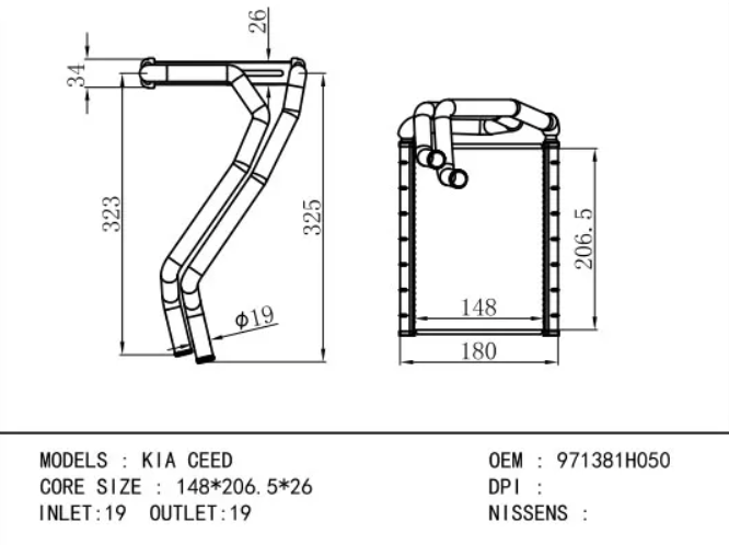

  • Facelift heater dimensions and substitute part numbers
    #8 20367997
    heearth
    @buulee @kubas10 Will it be possible to replace the heater without removing the board also in the facelift version?
    My car after facelift (year 2009/2010) fits the VIN model 97138-1H050, but there are no substitutes on the market, so the cost is much higher.
    You can find a manufacturer in China like this one: https://auto-heater.com/Product/KIA/282042.html
    These are the dimensions of the model 97138-1H050.
    Hyundai I30 1.6 CRDI 2010 - Heater Replacement Without Removing Dashboard, KIA Guide Link
    I wonder if the models of the heater for pre-facelift cars 97138-1H000, 97138-1H500, 97138-2L000 will fit instead of 97138-1H050
