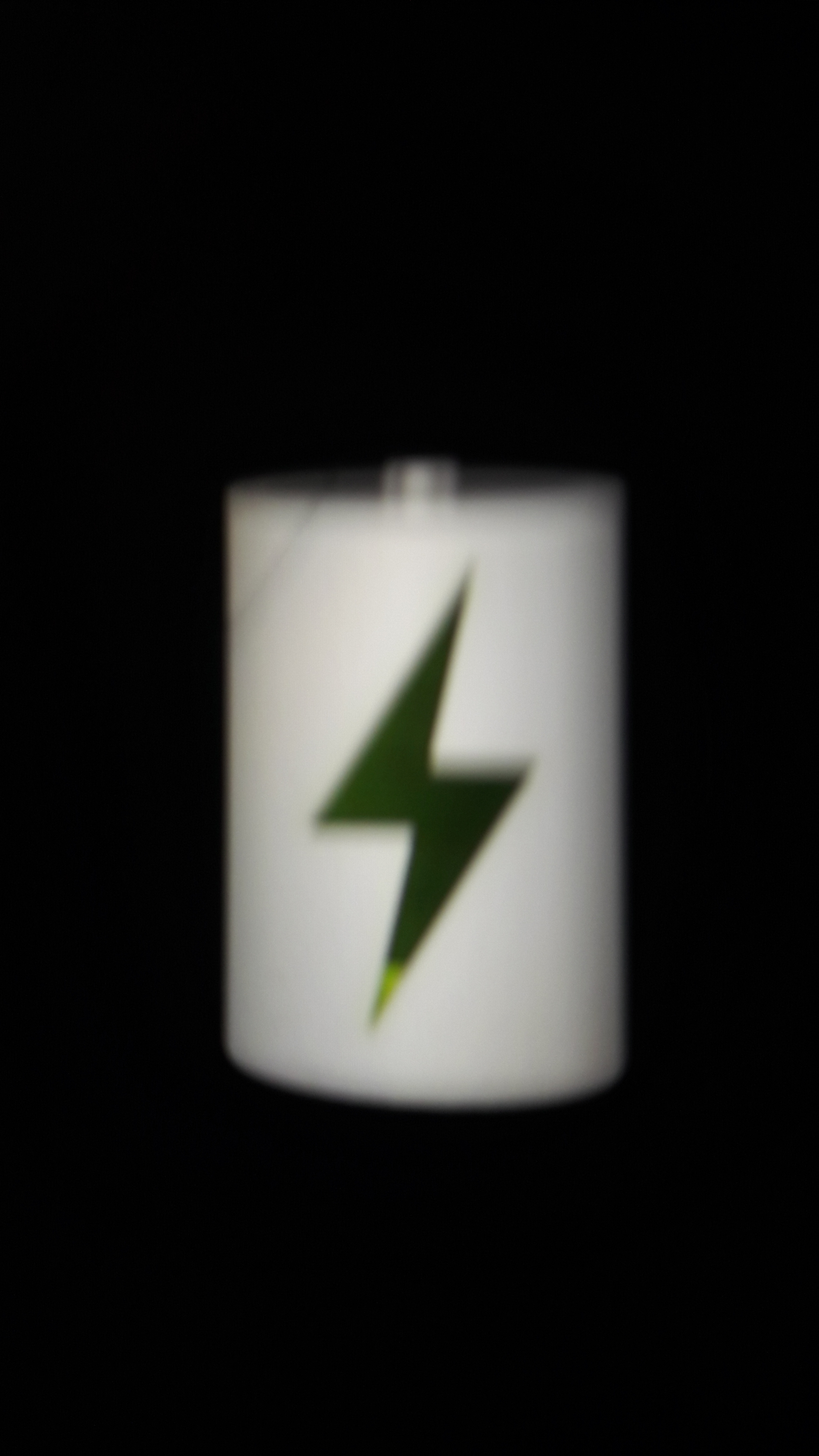

    The phone vibrates after pressing the Power button and the Sony inscription appears for a second. After connecting to a usb computer does not recognize the device. Any ideas on how you can bring him back to life?

    M4 aqua are the most defective phones in history. Motherboards are falling and probably memory. every second M4 aqua damaged :)

    I confirm as a colleague wrote above. But in your case to start with, take out the battery and measure the voltage, maybe you just need to put it on.

    Recently, I had this model on the site. Completely dead, he fell during hot days. I suspected the motherboard, but strangely (!) The battery replacement solved the case, it also went without excessive costs.

    A new battery for testing is on its way. But I noticed that now, when running after the Sony inscription sometimes bluescreen appears. And sometimes I have such a strange green battery (not as normal as the phone is charged on a ful. Picture attached.

    If you connect the phone to the computer with a cable, the LED lights up on the phone and the Sony display will be displayed after the time? I once had a problem with this phone and it turned out that the battery was dead. The exchange should solve the problem.

    Unfortunately, battery replacement did not give anything.

    In this case, a damaged disc

    The heated plate helps 80%

    It may help or it may be so that it will not get up at all anymore

    At what temperature should I bake it?

    Give her 180-200 degrees

    And I have to understand that just a hot airem I fly all over and do not cover anything?

    Use flux, and put plastic elements on it because hot drinks.

    After basking the CD the situation looks like the phone switched on normally everything went in it, but after about 3 minutes it turned off (not so that it turned off only jumped out normal "switch off" like using power). After switching it on a few times the situation repeats itself and so on and on. In addition, sometimes when you turn on the screen, a blue background appears for about 10 seconds.
