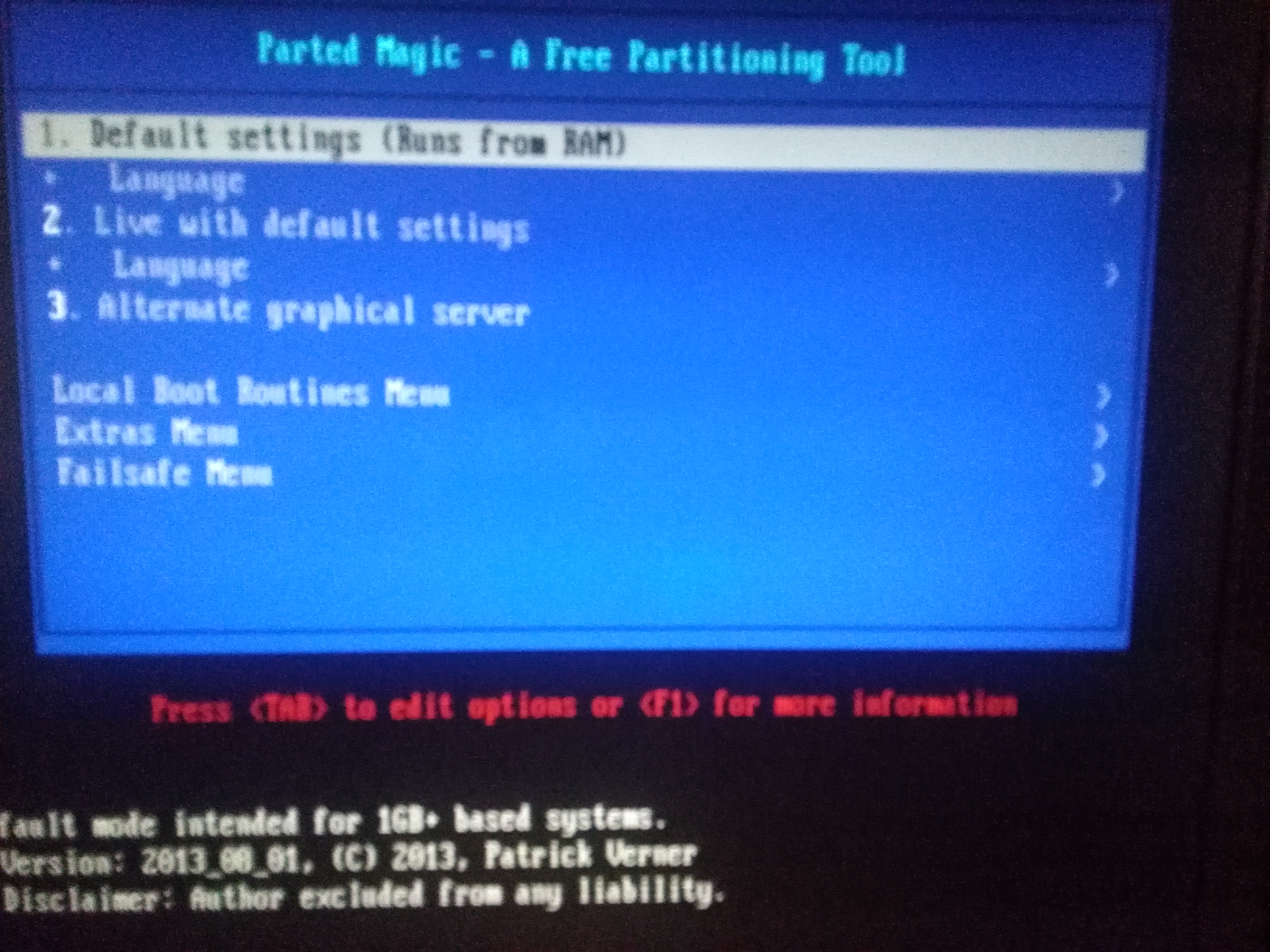

  • #12 16798134
    Freszek
    Posts: 9
    Okay, I'm in parted magic and what's next because there is no disc health here
    • Windows 10 Computer Shutdown and Recovery Issue Leading to Persistent Black Screen IMG_20171103_115816.jpg (2.9 MB) You must be logged in to download this attachment.
  • #13 16798138
    Kasek21
    Posts: 45661
    Help: 4981
    Rate: 3547
    Click ENTER and wait for the system to boot.

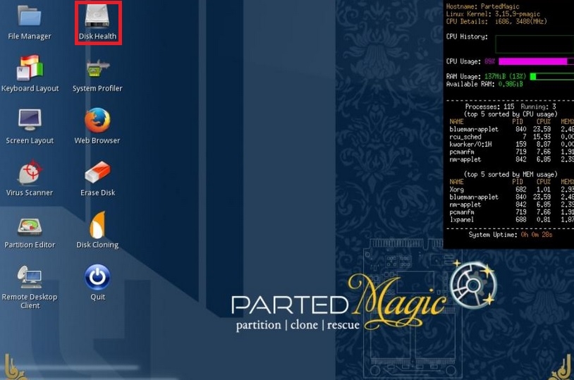

  • #14 16798148
    Freszek
    Posts: 9
  • #15 16798153
    Kasek21
    Posts: 45661
    Help: 4981
    Rate: 3547
    If it's not on your desktop (because I don't know what version it is) look for it in the applications.

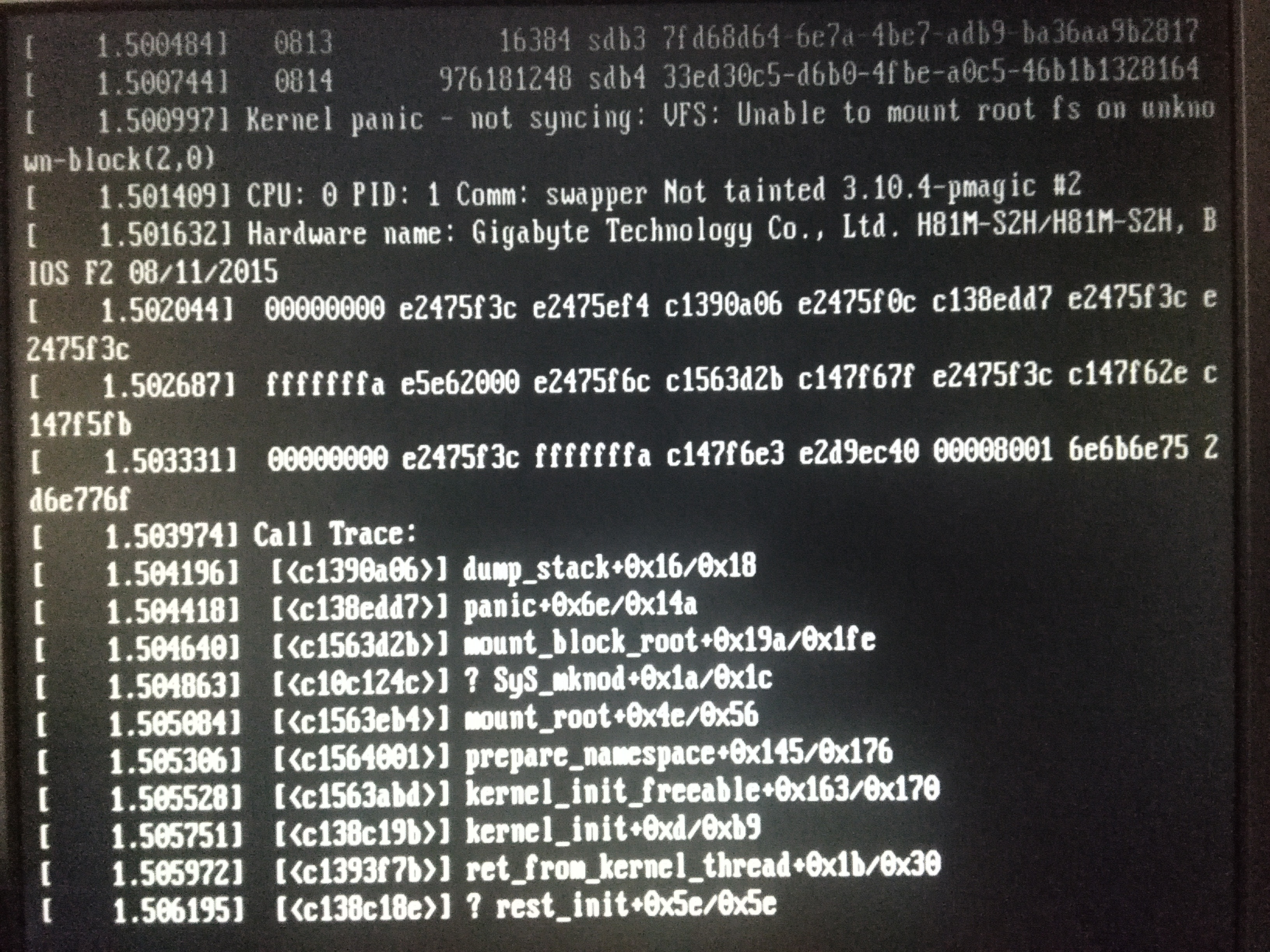

  • #16 16798169
    Freszek
    Posts: 9
    There is a problem because I have seen such a picture for 10 minutes. Is it bad I have to wait or what?
    after 20 minutes it's still the same
