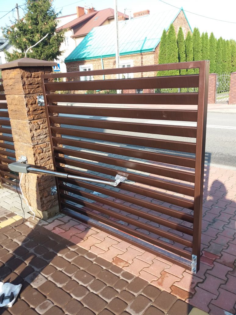

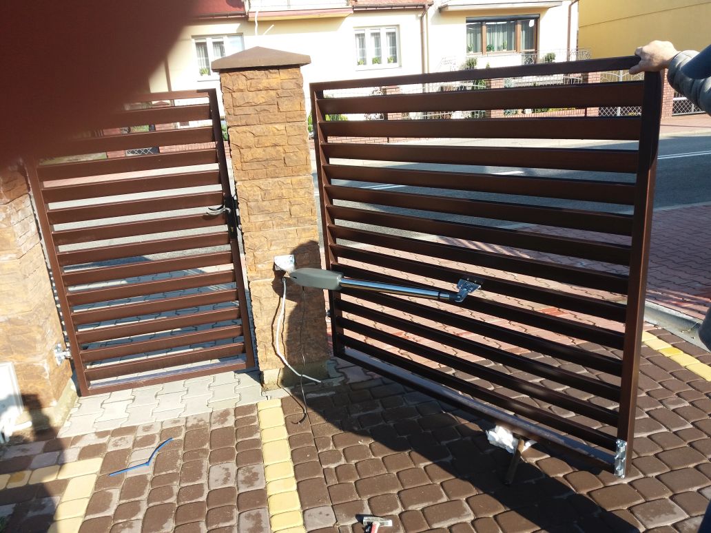

    I bought a set as in the subject and when installing the actuator I have a problem because I can not open the gate manually to 90 degrees. The wing is 1.4 m long. Can someone tell me what I'm doing wrong?
    • Elektrobim ETM-02 Gate Opener Issue: Can't Fully Open 1.4m Gate Wing to 90 Degrees - Help Needed 20171104_115901.jpg (219.27 KB) You must be logged in to download this attachment.
    • Elektrobim ETM-02 Gate Opener Issue: Can't Fully Open 1.4m Gate Wing to 90 Degrees - Help Needed 20171104_114659.jpg (203.46 KB) You must be logged in to download this attachment.

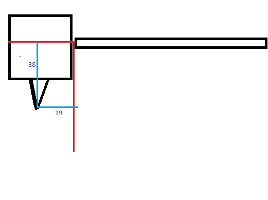

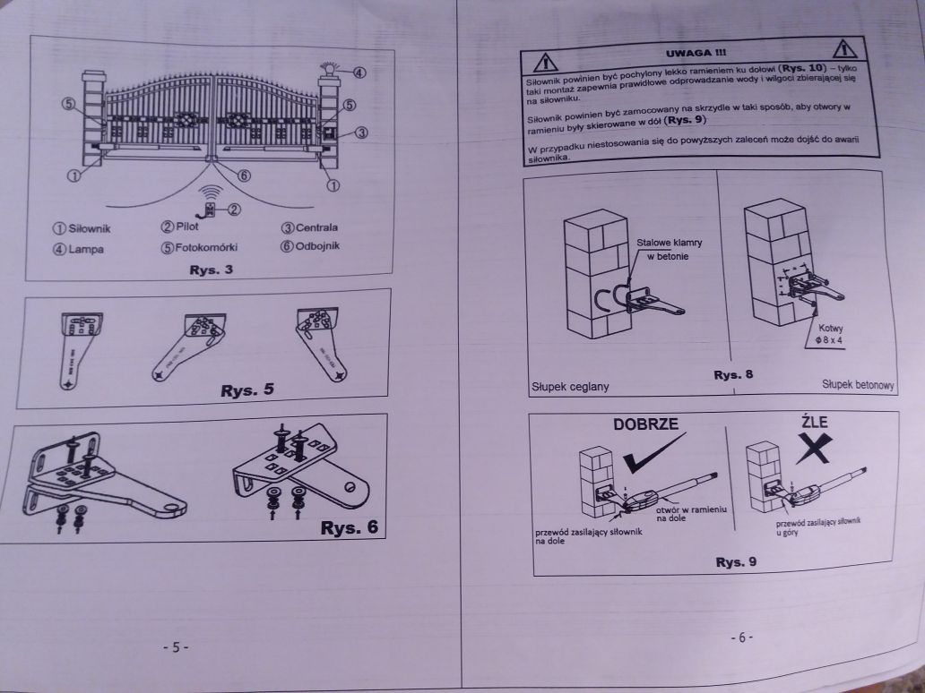

    Are you talking about this drawing? I was thinking about tilting the handle outwards.
    • Elektrobim ETM-02 Gate Opener Issue: Can't Fully Open 1.4m Gate Wing to 90 Degrees - Help Needed 20171104_141633.jpg (117.11 KB) You must be logged in to download this attachment.

    Well, I used to read about these distances. I think it lost me that they didn't mention it in this manual. Tomorrow I will rearrange this mount and see if I can do without drilling.

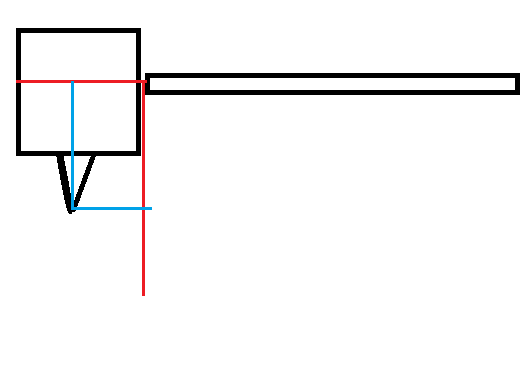

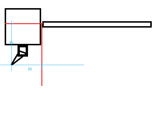

    I measured it this morning and it was wrong. Corrected.
    • Elektrobim ETM-02 Gate Opener Issue: Can't Fully Open 1.4m Gate Wing to 90 Degrees - Help Needed 4662177800_1509803628 (1).png (2.94 KB) You must be logged in to download this attachment.
    • Elektrobim ETM-02 Gate Opener Issue: Can't Fully Open 1.4m Gate Wing to 90 Degrees - Help Needed 4662177800_1509803628.png (2.81 KB) You must be logged in to download this attachment.

The discussion revolves around an issue with the Elektrobim ETM-02 gate opener, where the user is unable to open a 1.4m gate wing to a full 90 degrees. Responses suggest that the problem may stem from incorrect mounting points of the actuator, which are not aligned in a single plane. Users recommend consulting the assembly instructions, particularly a specific drawing, and adjusting the actuator's mounting position on the post to achieve the desired angle. The user confirmed that after measuring and correcting the mounting position, the gate now opens correctly. However, a subsequent incident involving damage to the gate has delayed further testing of the automation.
