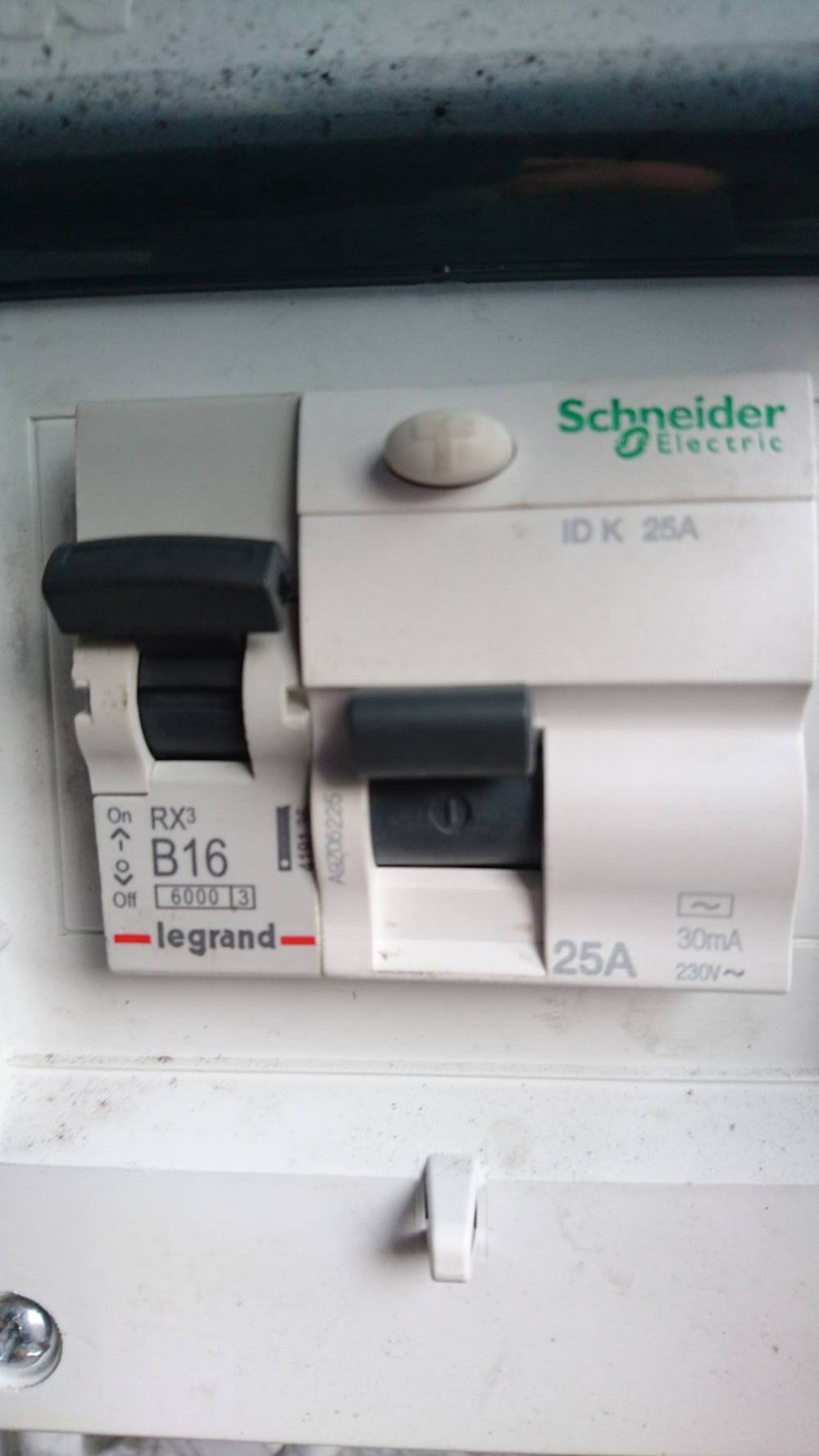

    Can the differentials shown in the photo be powered from the top? On the label of the bigger one for three-phase current, there is probably an indication that the top numbers are 1, 3, 5 and the bottom 2, 4 etc. But this marking may not matter. I don't know anything about it at all

    For the operation of this camera it does not matter from which side the power is connected. The most important thing is that N should be connected in the marked place.

    Thanks a lot for your help and explanation
