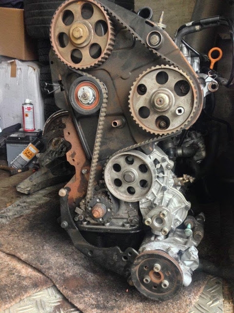

    Welcome. Question to the more experienced. Passat 1.9tdi AFN. After removing the shaft wheel, is it possible to replace the simering itself from the outside? Is it only with the aluminum part and the oil pan needs to be removed?

    You need to remove the timing drive wheel and replace the seal. The worst photo of this wheel holds firmly on the shaft I do not know if there is sometimes a special puller for it.

    Replace after removing the wheel without a problem.

    And in general, replace it in the head, by the way, because it will probably hit the trail soon.
