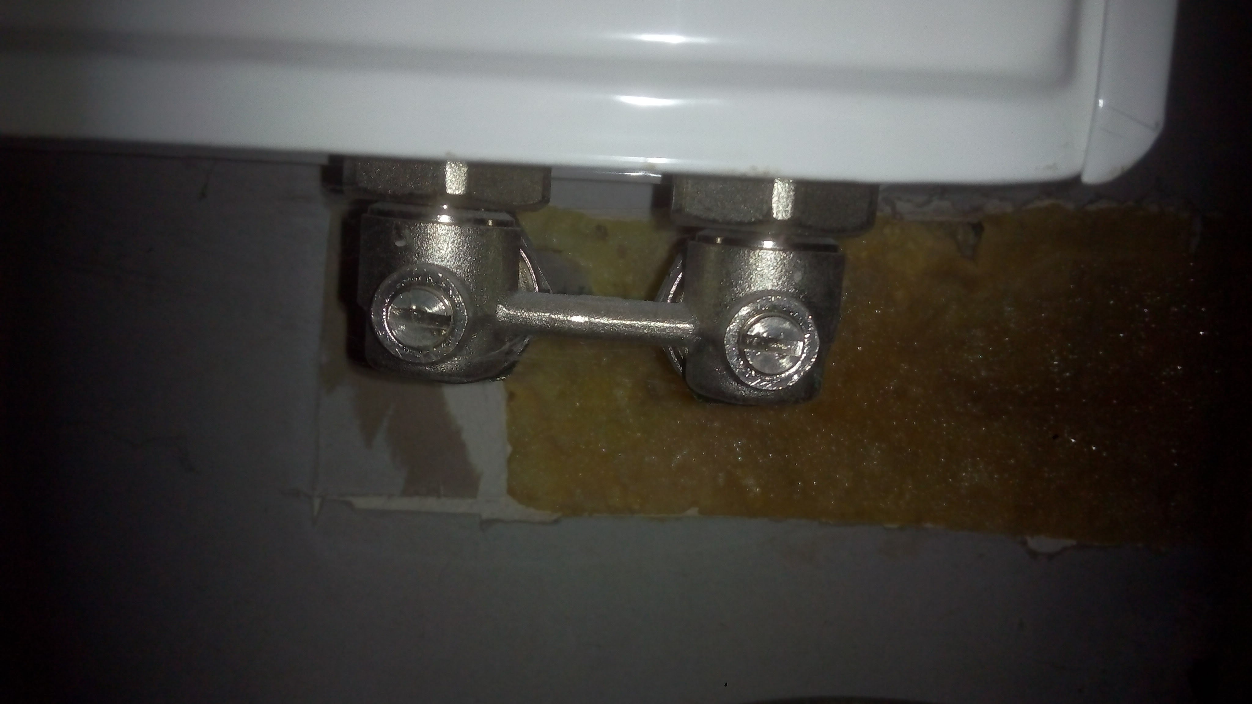

    When writing about the lower screw fittings I meant:
    Closing the valves in this connection cuts the radiator from the installation.
    Then you only need to drain the water from the radiator through e.g. a vent, when the vent stops flowing from the vent, you unscrew the entire vent, then the water gushes a little more, so you put a small bowl under the radiator, which will take the flowing water.
    Additionally, you can loosen the bottom cap below the vent to let some more water drop to keep the water level below the liner level.
    Do everything gently, unscrewing the air vent and bottom plug completely results in the water running out under pressure.
    1m of the C22 radiator, 60cm high, has about 6.5l of water in it, so prepare a bucket of appropriate capacity so that you have a place to pour the water out of the bowl.
    If you drop enough water, you can try to twist the insert.
    I do not know Danfoss, but I have Oventrop inserts and their replacement is very easy, because an ordinary wrench, probably size 19, fits them, and the presetting is done with a 13 wrench, so you do not need specialized tools and a service technician.
