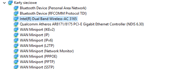

    Hi,
    I have this computer:
    https://www.x-kom.pl/p/306024-notebook-laptop...gl72-i7-8gb-1tb120ssd-win10x-gtx950m-fhd.html
    (network cards are attached).
    In the apartment we use fairly good internet, it works generally fine, but my computer disconnects from it quite regularly, i.e. I lose connection but in fact I am connected to the wi-fi network all the time
    What could be the reason?
    The problem is definitely not on the router / modem / internet side because two buddies using the same wi-fi internet do not have this problem (and they have weaker computers than mine). The problem is not the distance either, I am sitting closest to the router, there is no wall in between, moreover, on the net phone works fine (checked, of course, on off data transfer).
    I think the drivers on the computer are OK, because I update everything regularly with Driver Booster.
    So what's going on, does anyone have any idea?
    If more information is needed, please let me know.
    Edit *
    At the suggestion of the modeler:
    The router model is: Download TL-WR1043ND V 3.0
    Use the router my computer (above) two other computers (older 3 ~~ year old Samsungi) and Telephones, e.g. my Huawei P9 LTE
    The provider doesn't matter, I'm the only one who has network problems, the problem is somewhere on my computer, I don't know where? (DIGI supplier).
    It still installs a ton of other rubbish.
    Windows 10 also mixes its updates here.
    If there is an Intel wifi card - these are drivers only from their website and no other software.

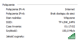

    Calmin
    Posts: 6
    I have all the options automatic, I have removed Driver Booster so that he doesn't mess with me in the future. I will look for the drivers for the card myself, as I found them, I will reinstall them.

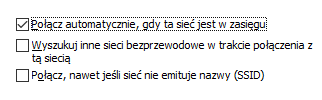

    I wonder, however, another thing, why in the photo I attach is written that I do not have access to the business? I have it because it works?
    second thing, should both checkboxes in the second picture be marked?
    No access for IPv6 - this doesn't apply to you.
    Calmin wrote:
    should both checkboxes on the second picture be marked?
    Depends on whether you need these features.
    In theory, there will be 300 Mb wifi - but on the condition that the computer's network card allows a channel width of 40 MHz and the router itself allows it to be included in it.
    The photo shows that the network cable in the computer aggregates 150 Mb.

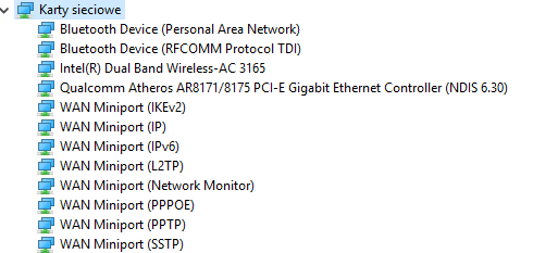

    ... Updating the network card drivers * we'll see if it helps) I noticed that I have a lot of network cards. Why are there so many / should it be like this?
    (picture below).
