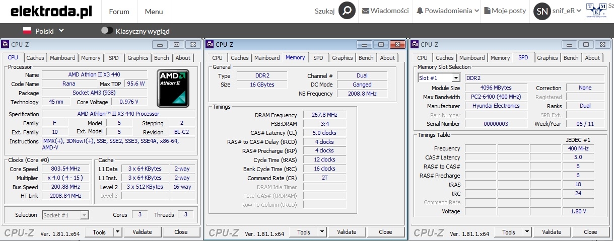

    I will try to be brief and to the point ;)
    I have:
    AMD Athlon II X3 440
    Processor
    Socket AM3 (938)
    AMD 770 rev. 00
    Motherboard - GIGABYTE GA-MA770-UD3 (rev 2.1)
    Motherboard
    Bios Updated
    So far I have been using ram memory - 1GB SP2-6400 DDR2 5-5-5-15 mushkin - x4 and everything was fine.
    Due to the fact that I use system virtualization in VirtualBox a lot and I need more memory, I bought it
    in HYNIX 4GB 2RX4 PC2-6400U-666-12 (x4 = 16GB)
    DIMM # 1
    SMBus address 0x50
    Memory type DDR2
    Module format Regular UDIMM
    Manufacturer (ID) Hyundai Electronics (AD00000000000000000000)
    Size 4096 MBytes
    Max bandwidth PC2-6400 (400 MHz)
    Part number
    Serial number 00000003
    Manufacturing date Week 05 / Year 11
    Number of banks 8
    Data width 64 bits
    Correction None
    Nominal Voltage 1.80 Volts
    EPP no
    XMP no
    AMP no
    JEDEC timings table CL-tRCD-tRP-tRAS-tRC @ frequency
    JEDEC # 1 5.0-6-6-18-24 @ 400 MHz
    In summary, the first two (blue) memory slots are working properly.
    After adding the next two memories, the system stops at the Bios boot screen.
    (Memory functional, sockets functional, bios updated, motherboard and processor compatible)
    I am asking for help, or at least a guide where to look for the cause of the problem.
    Greetings :)

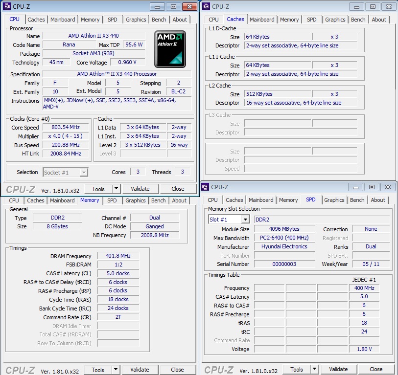

    enhanced wrote:
    Double-sided memory maybe? Maybe raise the voltage to 2.0V and add some memory.
    Yes, the memories are double-sided, I raised to 2.0 I added dice, no changes.
    I also tried to manually enter timings from memory rigidly but it did not help.
    bolekis wrote:
    Alternatively, if you still have old modules, try adding the old ones above 8 GB. If the disc will be in the 9 or 10 GB configuration, check if it will work stably.
    Unfortunately, I have already checked this option without changes.
    I will add that 2x4GB is nice. After adding 1x4GB, which gives a total of 12GB, the computer crashes the bluescreen while the system is already loading, and after adding 2x4GB + 2x4GB, the computer does not even move, i.e. the dark screen 0 reaction.
    In bios I changed Ganged or Unganged - no changes. I keep figuring out :)
    • Hynix 4GB DDR2 800Mhz - 4x4GB DDR2 RAM memory - system does not start // CPU-Zz.jpg (250.69 KB) You must be logged in to download this attachment.

  • #10 16848990
    snif_eR
    Posts: 9
    enhanced wrote:
    Then set the lowest possible clock speed and 2.0V and then add memory.
    I wonder if it's not the fault of the processor?
    Ladies and gentlemen,
    Problem solved :) )
    2x 4GB = 8GB (x4 = 800Mhz) approx
    3x 4GB = 12GB (x3.33 = 667Mhz) approx
    4x 4GB = 16GB (x2.66 = 533Mhz) perfectly
    I left the voltage unchanged (1.80V), timings for Auto and years :) :lol:
