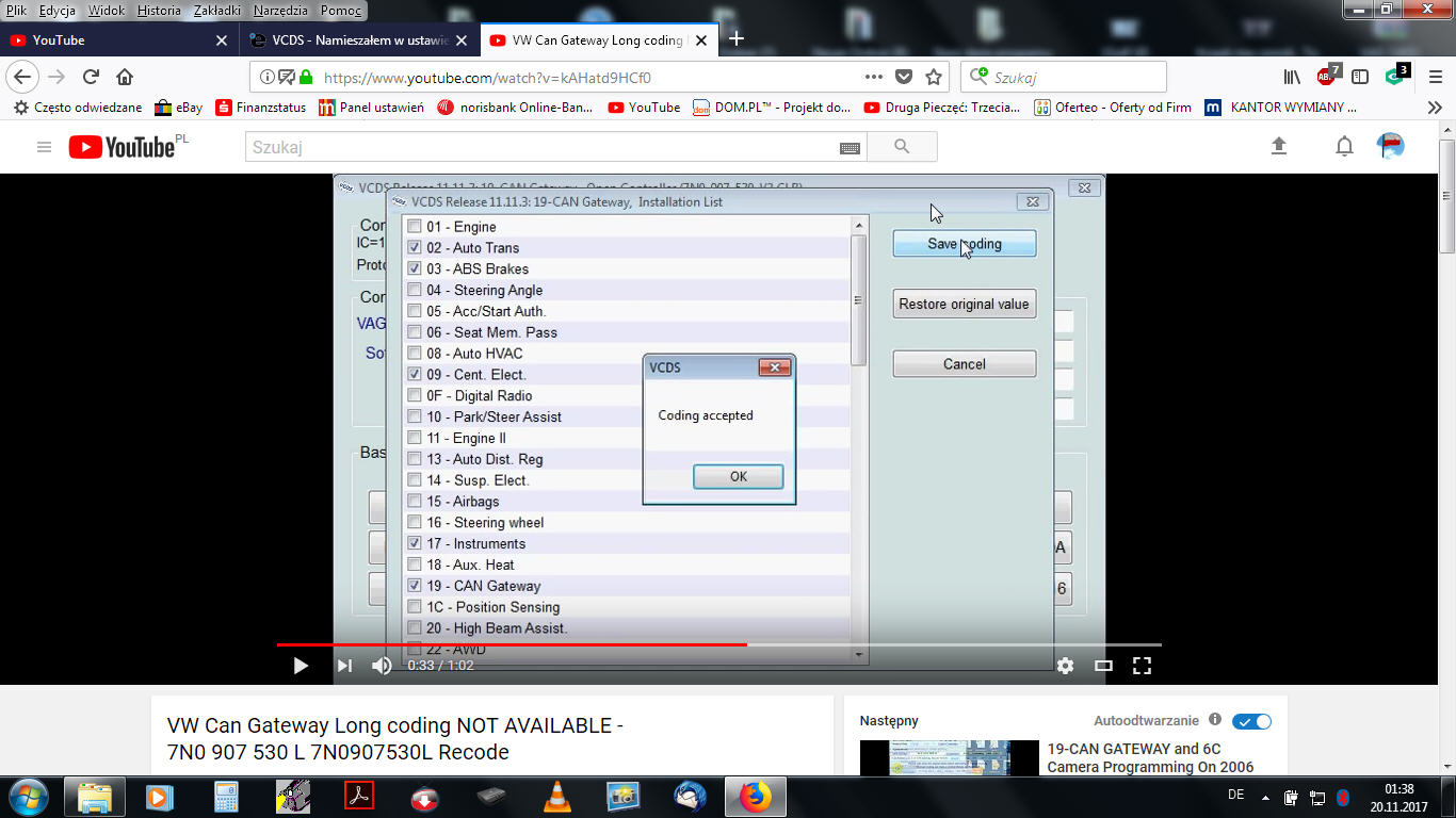

    as at the beginning I wanted to greet everyone with a smile
    I have a problem of this type after purchasing vcds (clone) I decided to bury myself in the adaptation of various components, read errors and so on, the fact that I do not know English but I thought to myself and what could happen somehow but it turned out that it was very unreasonable I mixed up the idea in the settings and I don't know what, so please help me how to correct these wrong coded, marked with birds in a long coding of values, I mark the car is running, it does not display any errors on the einige counter etc. I will put logs that will match me and I do not know what's going on, i.e. what I found I have smashed glow plugs on a 2.4 cylinder and probably when I bought the car 2 months ago the guest had to change the radio for another.

    Coding: 55C2E72AC8076002
    Shop #: WSC 11111 111 11111
    VCID: 70EE5D646377F7C67A-8024
    2 Faults Found:
    01044 - Control Module Incorrectly Coded
    000 - -

    próbowałem zapisać w19 - CAN Gateway na (55E2E78BEB076002) tak jak zapodałeś i niby wszystko koduje daje ok i po ponownym sprawdzeniu wraca na te poprzednie?
    druga sprawa nie jestem pewien ale chyba jest cos nie tak z kodowaniem (wartościami) ECU czy w pierwszej column powinno być10.11 at the end? I tried to change to one of these numbers but I got an error and I couldn't change?
    what I mixed up there I have no idea, maybe it throws me as I wrote that it is 3 cables from the engine measuring blocks?

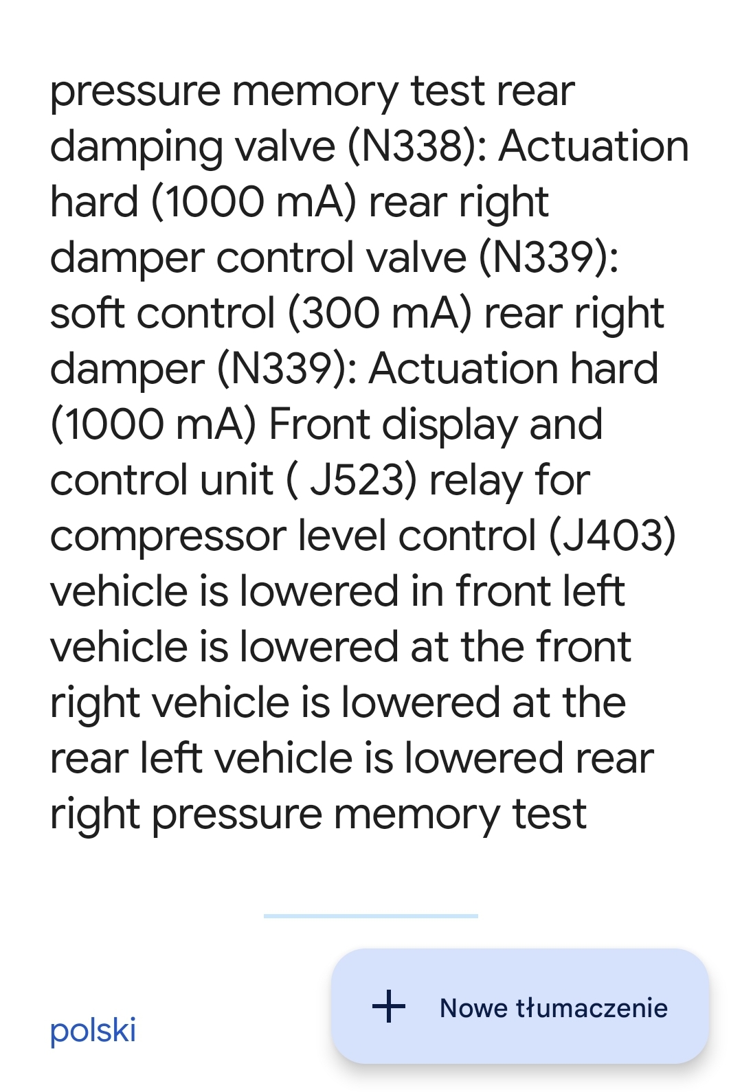

    Hi. I also mixed up something in my car by VCDS. I have air suspension on my Q7 and I'm in leveling. Here is where the El. Ush.-03 tests are and it was not described in Polish translation, but in English. I wanted to check the tank test and stuff, but figured out too late it wasn't where it was. I will add photos of these functions that I pressed and the car lowered after them and does not stand as before, although I did leveling, it did not return to what it was. I activated these functions, so to speak, in the highest suspension position. Anyone able to help me? And the patient is Audi Q7 3.0TDI, 2007 OFFROAD version.

    Do the given values agree with reality?
    What exactly did you press, because there are some screenshots from the translation in the topic, not what you chose in VCDS.
    If you called the suspension calibration routine, you just have to call it again, this time meeting its conditions:
    - Ignition [ON], use of a holding rectifier is recommended
    - The vehicle is on a flat, level surface (it is important, it has to be really leveled, without any slopes)
    - Lack of people and luggage in the car (including the driver's seat!)
    - Fuel tank at least 50% full
    - Free space under the car
    - The door must remain closed throughout the procedure
    Here is the full description of the procedure:
    https://forums.ross-tech.com/index.php?threads/12737/
    Worse, if you have an active B2013 error ... then, unfortunately, a visit to an authorized service center (or someone with ODIS and on-line access).

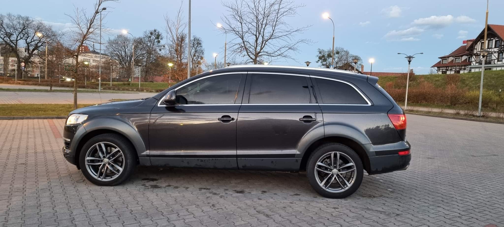

    The car used to be like this: a photo in a parking lot and now it is standing like this :(
