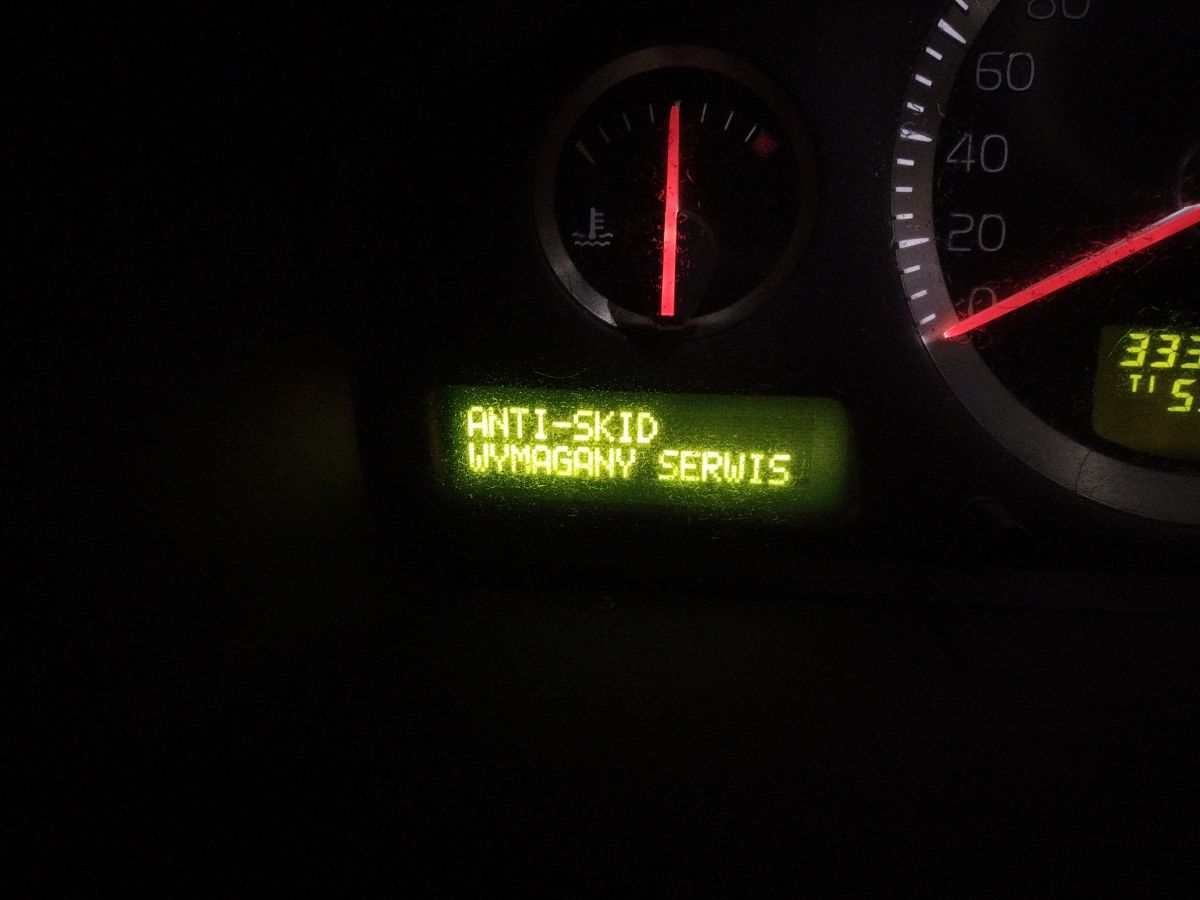

    Hello guys, something like this has also appeared in my Volvo V70 D5. The problem I have is that I don't know what answer to suggest ....
    Car dashboard showing the message ANTI-SKID SERVICE REQUIRED.
  • #15 21286017
    piotrekwoj1
    Posts: 10521
    Help: 947
    Rate: 3433
    siatanm48 wrote:
    Welcome to you, something like this has also appeared in my Volvo V70 D5. The problem I have is that I don't know what answer to suggest ...
    None, go to a workshop that embraces Volvo because it's not a simple diagnosis.
