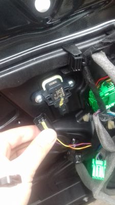

    I have an S60 2015, there is one error in the cushions
    B11A0 Left side restraints pressure sensor
    Does he know where this sensor is located?
    Regards

    Problem solved
    Replacing the sensor solved the problem
    Maybe it will be useful to someone
    This is a sensor mounted in the driver`s door

    Did this sensor from another car work without problems after connecting it to the cube or did it need to be additionally coded?

    Yes
    The part number must match and that`s it

    It didn`t work for me. The pillow error notification disappeared for a moment.
    But after restarting it, it caught fire again.
    The part number is the same, but the new sensor is not accepted.
    Any ideas ?

    Check the pins in the connector that goes into the post. Often, when disassembling and assembling the door, the pins in the cube may become bent.

    All I had to do was move the entire harness, including the cube coming out of the door at the hinge, and press it firmly, and the error hasn`t appeared for a week. Thanks MarcinS70R
