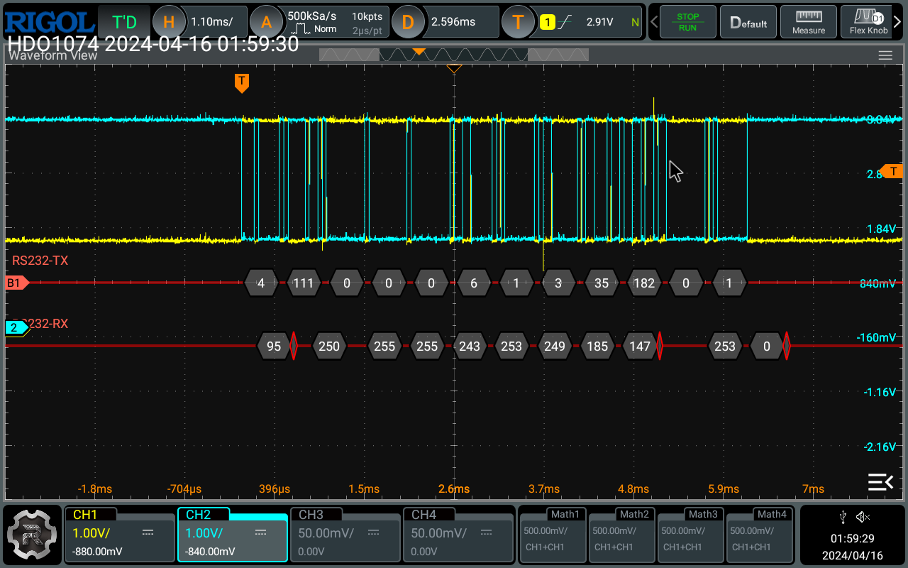

  • Suspected TCP/IP bytes corrupting Modbus RTU frame
    #53 21046592
    Kicauke
    Hi,
    I tried to use this solution to read information from the controller on modbus address 1 19200 8n1 connected to VEMOS d1 mini via Max485.
    I use the TX RX pins for communication and D2 (GIPO4) for DE/RE,
    Communication physically checked, I read variables from the controller using VEMOS as Modbus Master.
    I am connected to RS485 communication with an oscilloscope and what I noticed is that the communication frame is too long and some TCPIP is also sent via Modbus RTU (photo below).
    The controller does not respond to reading Holding from address 9143.
    Does anyone have an idea what could be the problem?

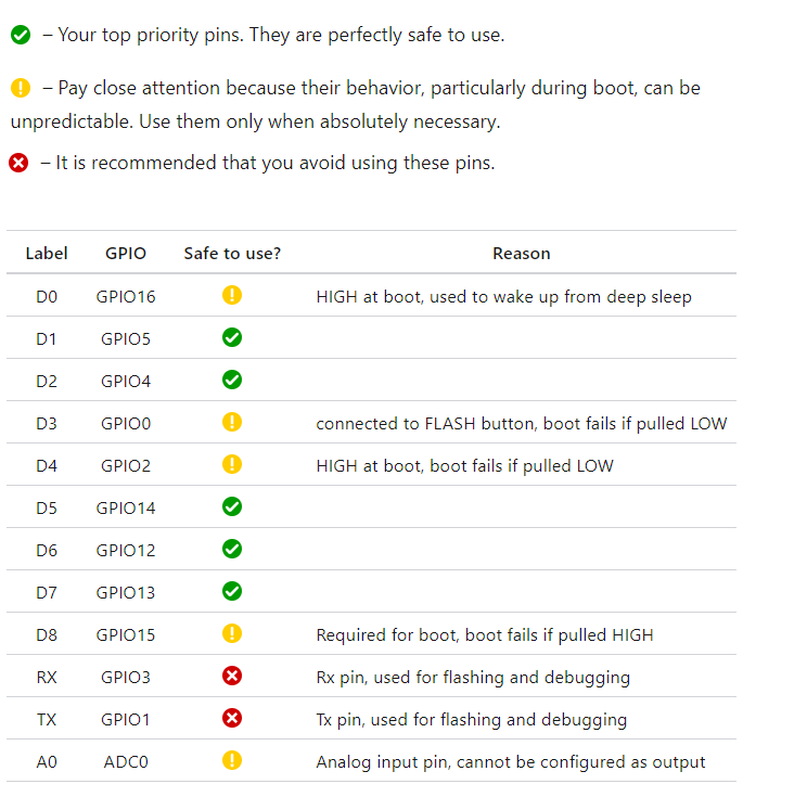

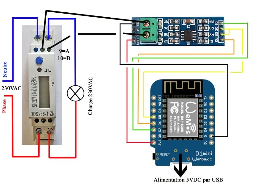

  • Wemos D1 mini pinout and MAX485 supply voltage clarified
    #54 21101804
    pela222
    Posts: 45
    >>21046592
    Kicauke wrote:
    I use TX RX pins for comm and D2 (GIPO4) for DE/RE,
    I don't know if this is where the problem lies because I'm a mega layman and will just be doing my first project, but I was just looking for answers on which pins to use on the wemos d1 mini to connect the MAX485 / RS485 Module TTL?
    From what I understand you have connected on the Wemos to TX, RX and D2 (GIPO4). Maybe here is the problem?
    Here is the documentation for the Wemos D1 Mini (https://lastminuteengineers.com/wemos-d1-mini-pinout-reference/):
    Table showing pinout and safety of use for pins on Wemos D1 Mini.
    And here a wiring diagram found on the web. D7 (GPIO13) <-> DI (RXD) | D5 (GPIO14) <-> RO (TXD) |
    Is this ok and is this the best way to do it?
    Connection diagram of Wemos D1 Mini with MAX485 module and DDS238-1 ZN energy meter.
    The last thing is the power supply. The MAX485 module on the page where I bought it is described as running on 5V. It says so here too. https://www.robotistan.com/ttl-rs485-serial-converter-board-max485
    All the schematics I see (including the one I attached) give a voltage of 3.3V???? Thanks for the info if it shouldn't be 5V.

How should I wire DE/RE on a Wemos D1 mini?
Connect RO→D7 (GPIO13), DI→D5 (GPIO14) and tie MAX3485 DE+RE to D2 (GPIO4). Ensure a 10 kΩ pull-down keeps DE low during reset to avoid bus collisions [Elektroda, pela222, post #21101804]

Can the bridge carry Modbus-RTU transparently?
Yes. Send a raw RTU frame over the TCP socket; the ESP adds no header. One user reads a WE-504 power meter by pointing Perl-MBclient directly at 192.168.1.87:8888 [Elektroda, zychzbig, post #21153086]
