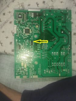

    Bosch WAS28442 Logixx 8 inverter burning piece
    What is the code of the marked part and why is it burned? Thank you. Burnt part of a converter on a circuit board with blurred markings. Burnt part of the Bosch WAS28442 Logixx 8 inverter, indicated by an arrow. Circuit board with various electronic components including capacitors and heat sinks.

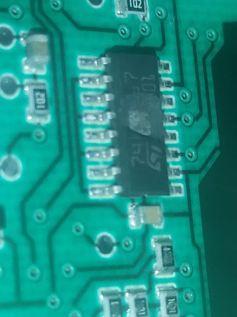

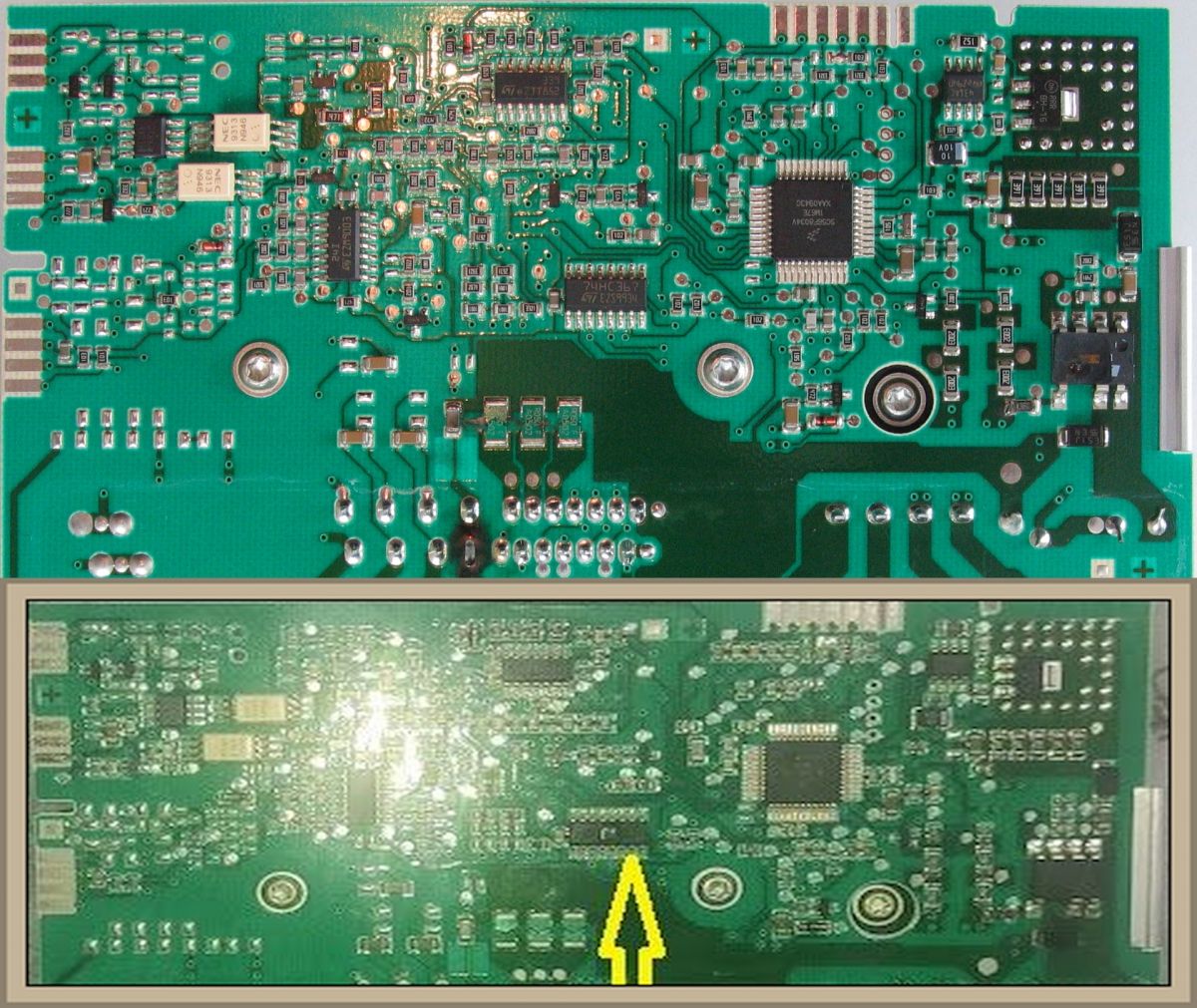

    Such 74HC367 Link , but better check processor (you didn't write what else fell), and the photo more than lousy and you can't see anything :) Close-up of two printed circuit boards with various integrated circuits and electronic components.

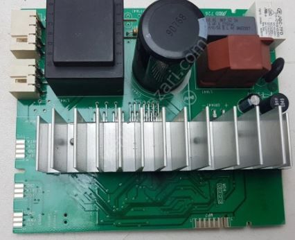

    100% compact processor, hybrid and comparators, plus some small parts.
