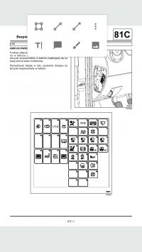

    Hello. I have a problem with Dacia Logan. Front position and right low beam do not work. Light bulbs in working order, fuses ok, light handle changed, because on one of the forums I found information that she may be guilty. From what I was looking for a relay is missing. Where else to look for the cause?

    You have probably given the control handle and it is the same. I recently had a date and two shifters brought in by the customer, both crazy. New solved the topic. I am not sure 100% but daci banged on the equipment and may not be relays. All power through the lever goes.

    It is the fuses that divide the lights into circuits. Not the handle. Rather, I choose light bulbs. At least you checked the voltage and gave it briefly from the battery as if there was no voltage.

    The bulbs are ok, exchanged and exchanged. On the right, there is no voltage in the lamp cube, on the left only in one wire. I don't remember the colors but I can check which one it was.

    So fuses. Or what I doubt the bundle.

    I forgot to write, for voltage is on 2 out of 4 fuses. 1st and 3rd from above (on 9 and 11 from the diagram)

    9 is the left hand and 11 is the left hand.
    Have you checked on both fuse pins? You tried to energize these fuses.

    I checked on both pins. No voltage. I will try to give briefly as you suggest and let me know what is going on. Probably something wrong with the beam.
