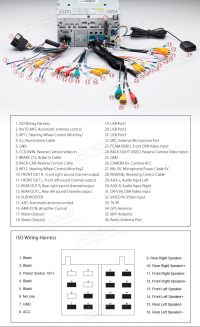

    Well, the XTRONSA Chinese navigation is coming to me. Soon I will have to connect the radio, but there are a lot of cables so I need your help. I am asking for help in decoding the radio connectors 2-9 and 23-28.
    I have to connect:
    1. Reversing camera with wireless module
    2. External DVB-T Tuner
    Thanks in advance.

    2 - control cable for automatically retractable antenna (if you do not have one, leave it unconnected);
    3 - cable for radio control from the steering wheel (line 1);
    4 - radio backlight control;
    6 - video input from the rear view camera;
    7 - handbrake applied signal (if you want to have an image while driving, connect this wire to ground);
    8 - reverse gear actuation signal (control probably ground);
    9 - cable for radio control from the steering wheel (line 2);
    23 - video input (here you can connect the video signal from the DVB-T tuner);
    24 - the same as connector number 6;
    26 - reversing camera power supply;
    27 - power supply of an additional microphone;
    28 - same as 8.

    You know whether the backlight control will work when the car has a CAN bus or will you need to install a decoder?

    Connect the radio, if it will not illuminate the buttons, then connect the cigarette lighter backlight, although I think it is "dimmer after turning on the lights", steering wheel control is resistive on this radio, I do not know what your car is. Be sure to look for the ACC signal (with the key), men like to draw electricity.
    Ps.
    Reverse signal ... 99% plus, but I don't know what car.
    Why didn't you buy something branded?

    Mercedes Vito W447. Steering wheel control is definitely via CANBUS but I will not use it because they did not let go of the beam.
    I did not buy anything branded because I wanted a few functions that other radios do not have. We'll see - if it doesn't work, I'll buy another one :)
