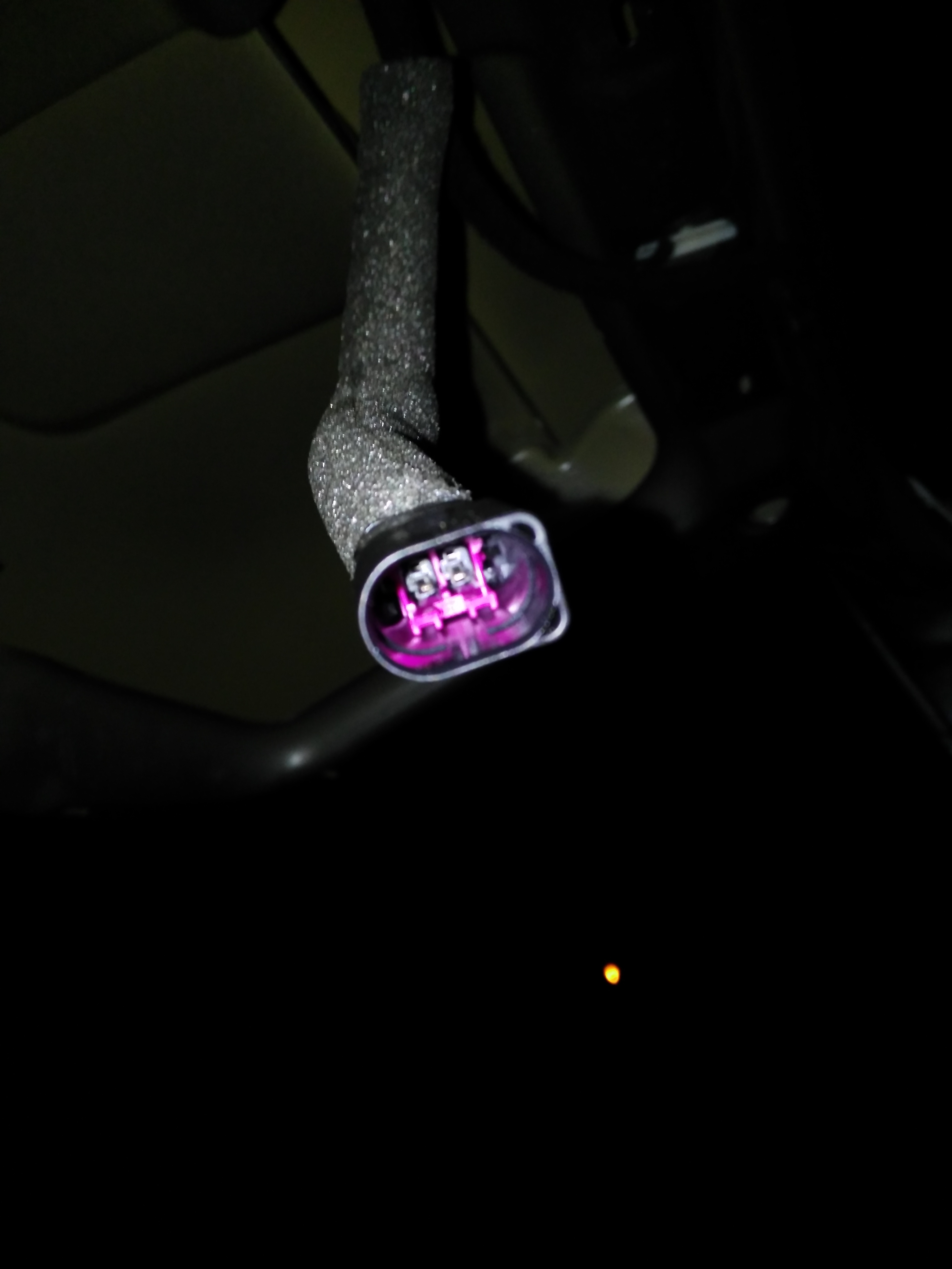

    I have had a problem with the trunk for a week. First, it started to open automatically. It was as if I was pressing that button on the lid. I drove like this for 2 days. It was audible that every several seconds, sometimes a few minutes, this mechanism was activated by the cable. After two days it stopped ... completely. The damper opening does not work. Fortunately, the back was removed, so I have access to the link to open it from the inside. Now yes.
    Does the damper actuator have a fuse? How to check the actuator? Just connect 12V? I unhooked (I think it was) that button on the lid. I understand that when pressed, the circuit should close? And then, after the contacts in the second block are closed, the actuator should be activated?

    First, check whether the actuator reacts after applying voltage.
